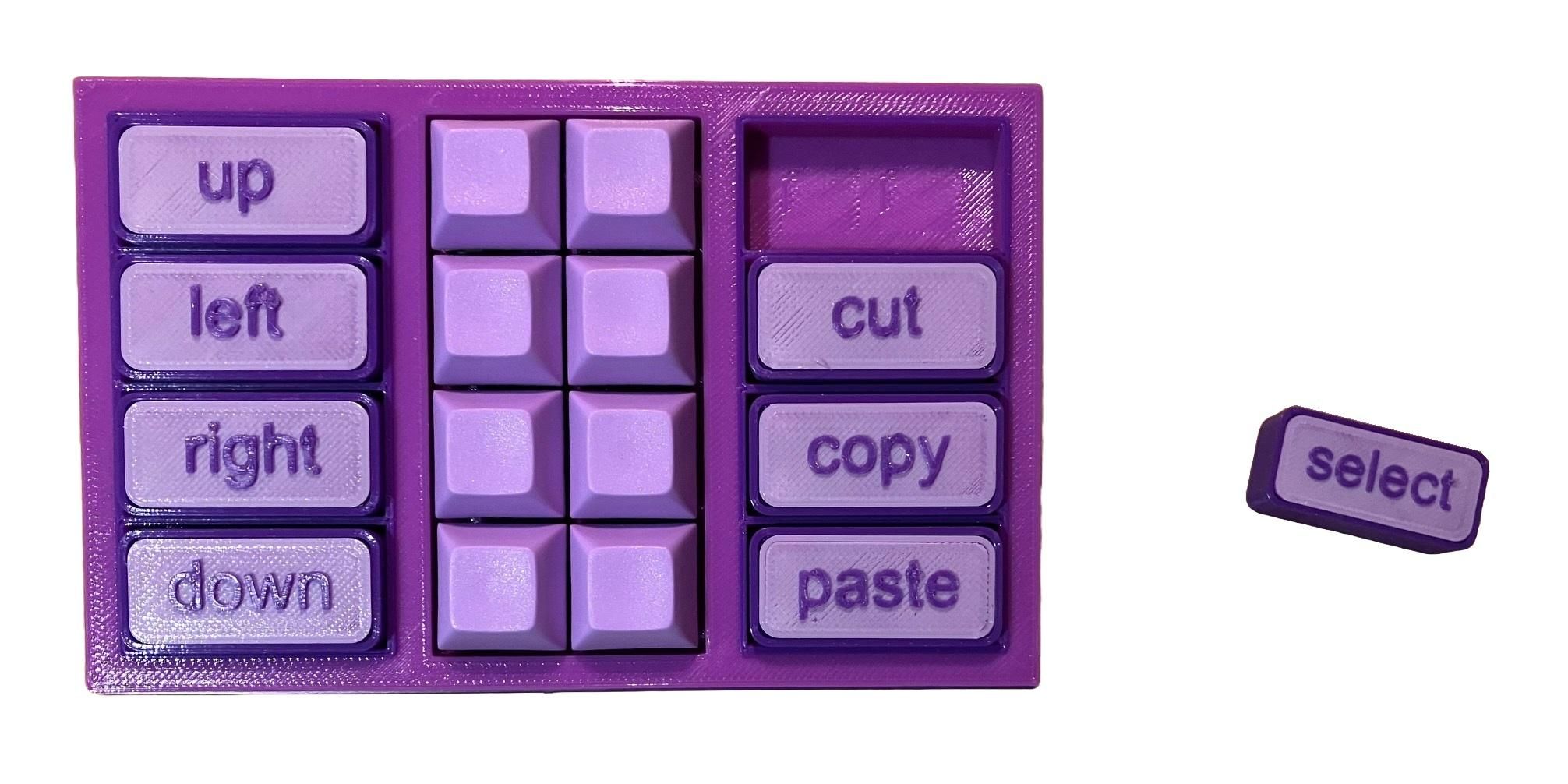

A Tile Based Interface
My solution was to build a MacroPad that has eight keys based on nice Fubata MD-4PCS switches. Beside each key is a slot that can hold a "special" tile which identifies a macro to be associated with that key. To be perfectly clear, all of the available macros will be defined in the firmware in much the same way as with other MacroPads. The tile holds a "simple numeric value" that maps the associated key to a specific internally defined macro sequence when the tile is inserted into the slot.
Tiles can be swapped at any time changing the key's macro immediately. I'm a big fan of this tactile based interface.
It's pretty obvious how this solves the few keys many macros problem. The user can define a large number of macros (up tp 100) internally and can activate any eight macros at a time by simply slotting in the appropriate tiles.
Furthermore the tile's approximately 2U size is a great surface for defining meaningful, easy to understand, labels for the macro's action. Of course if you are attached to cool but cryptic icons you can do that too.

Done.
Step 5: Make Some Tiles

String macros[] = {
// Macros 0-9.
"PRESS,KEY_LEFT_CTRL,a,RELEASE_ALL", // select
"PRESS,KEY_LEFT_CTRL,c,RELEASE_ALL", // copy
"PRESS,KEY_LEFT_CTRL,x,RELEASE_ALL", // cut
"PRESS,KEY_LEFT_CTRL,v,RELEASE_ALL", // paste
"KEY_UP_ARROW", // up
"KEY_LEFT_ARROW", // left
"KEY_RIGHT_ARROW", // right
"KEY_DOWN_ARROW", // down
"MEDIA_VOLUME_DOWN", // louder
"MEDIA_VOLUME_UP", // softer
// Macros 10-19.
"MEDIA_VOL_MUTE", // mute
"MEDIA_PLAY_PAUSE", // pause/play
The important part is this last macros table. When a key on the pad is pressed, it's corresponding tile is read to get the two digit tile number. This number is used as an index into the macros table to get the appropriate macro string which is parsed to determine the keys to send to the PC. The macro string is split into "tokens" at the commas and the tokens are processed from left to right with the following rules:
