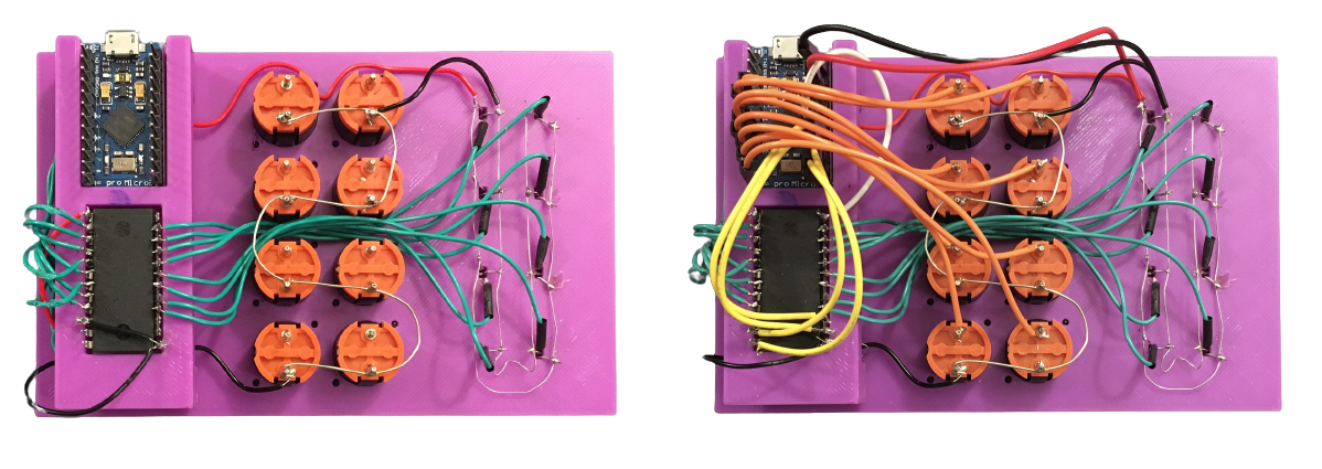

Step 3: Do the Wiring
The first thing I did was to trim the leads on the SS49E sensors and spread them out a bit for easier access.
Then I wired the power connections to all the sensors and the buttons. Obviously a lot of care was taken not to introduce shorts, especially with the tiny hall effect sensors.
Next I wired the outputs of the 16 sensors and power to the multiplexer (left below). Finally I connected the pro Micro (right below) to the buttons, multiplexer, and project power.
Here are all the connections:
Arduino pro Micro   CD4067BE Multiplexer     Wire Color        Description
      VCC                +5V                Dark Orange     Also powers the sensors.
      GND                GND                   Black        Project Ground
      A0              Common Input             White        Read the channel selected
by S0-S3.
   I/O Pin 2-9                              Light Orange    Button 1-8
   I/O Pin 15            S0                                 These four inputs select
which of the 16 analog
channels to read.
                                              Yellow
   I/O Pin 14            S1                   Yellow
   I/O Pin 16            S2                   Yellow
   I/O Pin 10            S3                   Yellow
    I0 - I15                 Green        Sensors 1-16
      GND                E                     Black        This is an inverted chip
select pin.

Attach the MacroPad Base to the MacroPad Body (TBM MacroPad Body).
When I did the wiring, I chose to use jumper wires to connect to the proMico rather than soldering directly to the header. I was glad that I did because the USB connector on the pro Micro broke and I had to replace the board. At any rate the jumper wires extended below the bottom of the case, so I added some rubber feet (TBM MacroPad Foot Pad) which not only fixed that issue, it made the box more stable.
I also added auto-repeat if the macro key is held down for more than 2 seconds.
