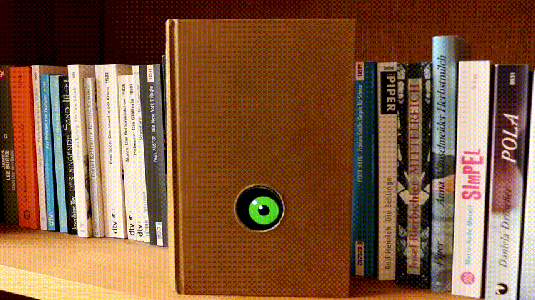

I recently read a nice fantasy book*. It has an eye on the cover and other beautiful drawings by the author.
Something comes to mind with the new round OLED displays. Why should the eye be just a drawing?
The magical fantasy book should become reality! Let's go!

Step 4: Preparing the Book
My display has the diameter 3.7cm. A suitable hole is made in the middle of the book cover with a drill. If you don't have a suitable drill, you need to mark it out with a pair of compasses and cut it out cleanly with a penknife.
Then you define how much of the book you want to cut out. To do this, we open the first page and fix the book on both sides with wood strips and screw clamps. Now you can make cuts along the ruler and remove the paper in between. We do this until the space is large enough.
I use wood glue to fix the cut edges a little. It matches the color well, is slightly elastic and dries quickly.
Step 5: Bring It All Together
We fix the display in the hole with hot glue. A wooden strip can be helpful.
Drill a hole for the cable in a suitable place on the back of the book. Close the book, connect the power bank - done.
