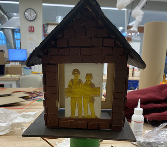

Step 4: Laser Cut Bricks and Stands for Tree House
I laser-cut small rectangles to glue to the tree house. I also laser cut an image of Jack and Annie for inside the treehouse.

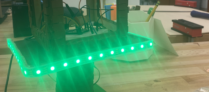

Step 5: Attach Led Light Strip
I attached the LED light strip using double-sided tape around the perimeter of the platform that the treehouse rested on.

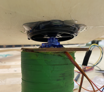

Step 9: Attach Servo to Base of Tree House
I hot-glued a servo onto the treetrunk after I created a half-elevated ring. Then, I screwed a wheel into the servo. Lastly, I hot-glued the wheel onto the platform of the tree house.
