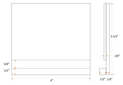

Step 1: Constructing the Flats
The flats of the trays are made by laminating rectangular sheets of material together. The base piece in my design was 1/4 inch thick, but it could be any similar size. The pieces can be cut before assembly, but I had more success by making my parts oversize and then trimming the final product so it fit comfortably around the bits that I used. You can use two edges as reference edges and leave the others floating for trimming to size later.
Wood glue is best for attaching the layers of wood or card stock. To attach the magnetic material I used Barge contact cement, although hot glue could also be used.

Step 3: Laying Out the Grooves
You want to create slots where your bits will contact the magnets or the magnetic sheet. These serve as guides to hold the bits in orientation, but should not be so tight as to prevent the bit from being in complete contact with the magnet. You also want them wide enough to use for labels.
I used a thin card stock for this. The groove doesn't need much depth to function. There are probably several ways to do this, and you may want to find one that works for you. I started at one end and laid out my bits one at a time and placed a 1/2 inch (or so) wide strip of card stock up next to that one before moving to the next. When dealing with the rare-earth magnets you have to carefully trim the strips to leave the right-sized gap for each bit. Take your time and double-check the fit because it can be hard to adjust once done.
On the large tray I used white glue to attach the strips. On the magnetic sheet I used hot glue, although I think contact cement might have been better.
