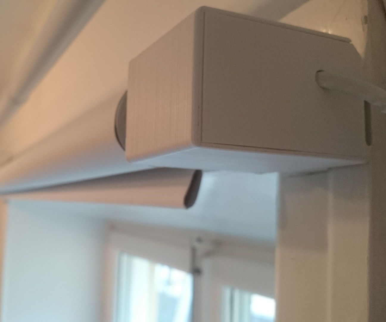

Step 9: The Result
Finally done!
On the second picture you can see I also made my own rubber gasket to protect the unit from moisture, this is necessary only if you intend to place the unit on the outside of the mailbox.
If you managed to get this far, good job!!
If you have any problems with range, try changing the function sendSignal(22,1,80);
to sendSignal(22,5,1500); for instance, this will send message "22" 5 times with 1500 ms delay. Don't forget to increase the time before sender goes to sleep (the transmitter takes about 1 sec to send each message in this mode)
If you still have problems, try using an external antenna. They are fairly cheap and easy to attach.
