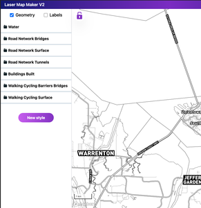

Step 4: Pan - Zoom - Lock
Zooming involves adjusting the proximity or distance from the map location. There are several methods to zoom in Laser Map Maker. Beneath the search bar, you can click the plus and minus signs to zoom in and out. Alternatively, you can hover your mouse over the map and utilize the mouse scroll to zoom in and out.
Panning comes into play when you have achieved the desired zoom level and need to fine-tune the map position. Simply click and hold the mouse, then drag the map in any direction as needed.
Locking your map will hold it in place and disable panning and zooming. We will be changing layers and exporting multiple times while this is locked. That way, you have the exact position of the map for each layer to stack nicely on top of the other. The lock/unlock button is in the top left corner of the map, you simply click it once to lock or unlock.
In this tutorial, we will utilize the zoom and pan functionalities to navigate to our desired position for the New York map file. Take a look at the two images above and note the second one has been panned and zoom in on. If you are following along, you will need to do the same. Try and match our image with your map!

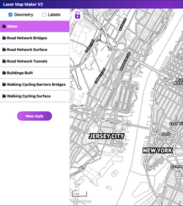

Step 6: Geometry Categories
A category helps organize the layers into groups, helping the user locate a desired layer. An example would be a user wants to change a water layer, they may assume it may be in the "Water" category.
The images above display what the left side pane looks like before and after selecting the "Water" category.

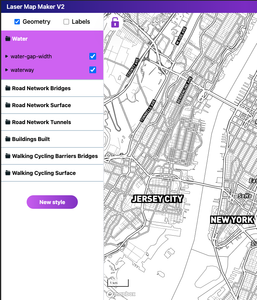

Step 7: Editing Geometry Layers
You can see from this image we have opened the first layer by click directly on the name "water-gap-width".
From here you can update 2 layer properties: Width and Color.

Step 8: Toggling Layers
Notice in the image you can see checkboxes next to each layer when you open a category.
Go through each of the categories and toggle off each layer EXCEPT for "water-gap-width" in the "Water" Category. This will be our first layer we will process.

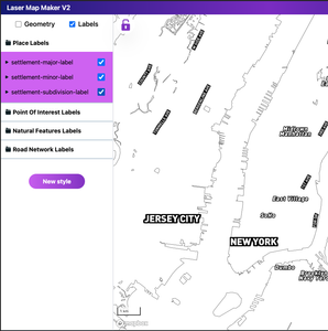

Step 9: Label Categories
In step 5 we talk about Geometry and Labels, now that you have your Geometry layers turned off (except for "water-gap-width"), click on Labels checkbox to display the label categories.
If you would like to try out the labels properties Size and Color, navigate through the labels layers just like you did for the lines in step 7.
Next open every category and turn off every layer, we won't need labels for this project. If you do use labels, just make sure you export them separately from any cut lines. We will discuss how to export each layer you need.

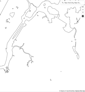

Notice on the far right side of the map there is a printer button. Click on this button to start the export process.
For this tutorial settings we are choosing the square, 300 dpi, and PNG. Click on the button "Generate", this should save to your downloads.
Step 11:
We plan on building a map with Water, Land and Roads. We took the water outline, but it's actually not for the water layer! We will cut this layer and place it onto our first flat square layer with no cuts or engraves. The areas where the first layer is not covered by the cutout is our water. So we are actually already done with water and are working on the land layer. Confused? Don't worry, it'll all make sense shortly.

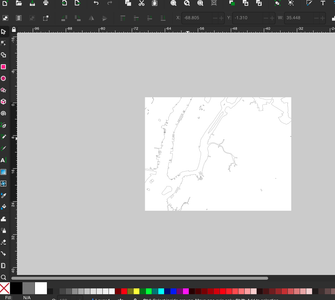

Step 12: Importing Into Inkscape
Begin by opening Inkscape.

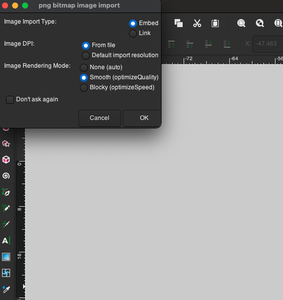

Import your first file into the software, by selecting file from the tool bar and clicking on import.
Select your png you downloaded.
Follow the same settings in the second image.
Now we should see our imported map image on the editor.
Step 13: Tracing to Bitmap

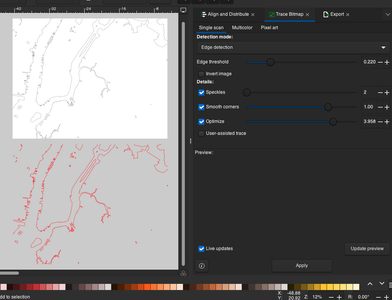

Now that our image is in Inkscape we need to prepare it for the laser. We will use a process where you trace the image to bitmap before sending it off to the laser.
Navigate to the toolbar and select Path then select Trace Bitmap. Look at the second image if you get confused, match the settings I am showing and select Apply when you are ready. The traced image is directly on top of the old image, drag the image off the top of the current map!
Since my laser is configured to cut red lines, we are applying red to the lines. If you have a different configuration like line width, you will need to adjust the tracing line widths.
