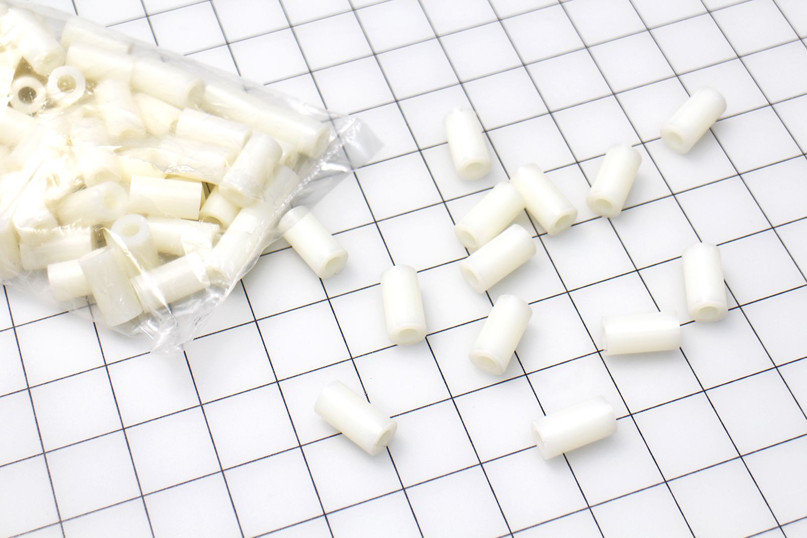

  • 1 bag of nylon unthreaded spacers

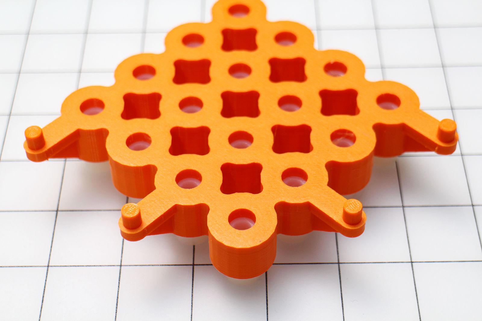

THE 3D PRINTED JIG
To design/model the jig, I used Tinkercad– a FREE browser-based 3D modeling program by Autodesk. If you've never tried 3D modeling or printing before, but are interested in learning – Tinkercad is a great place to start!
The 3D modeling of the jig was more complicated than I wanted y'all to deal with for this instructable, so I'm just providing you with the STL file (see below) for 3D printing – and will provide assembly instructions in two steps.
If you do have access to a 3D printer, GREAT! Just go ahead and print the thing.
If you DON'T have access to a 3D printer,I recommend downloading and sending the STL file to Voodoo Manufacturing where they will print it for you for $25 (in white PLA) plus shipping.

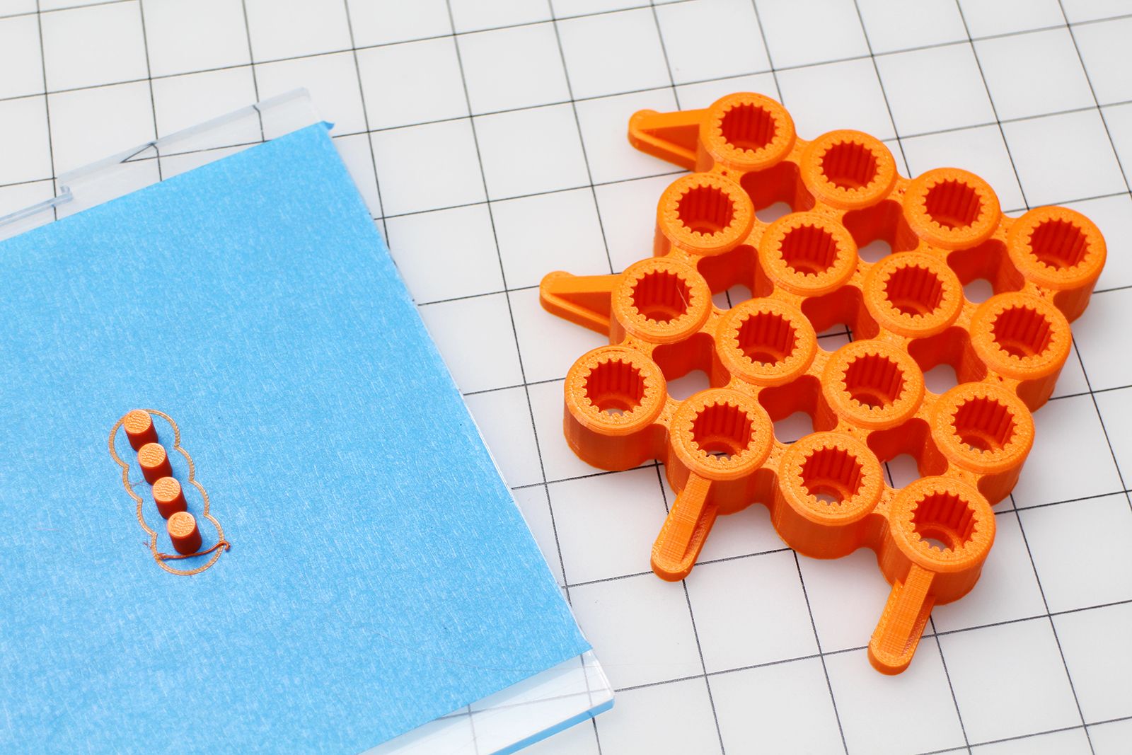

Step 3: Assembling the Jig
Now that you've printed (or received in the mail) your jig parts, it's time to put them together!
You should have 5 parts total:
  • (x1) Main jig body
  • (x4) Small pegs
And you'll need 16 of the nylon spacers.

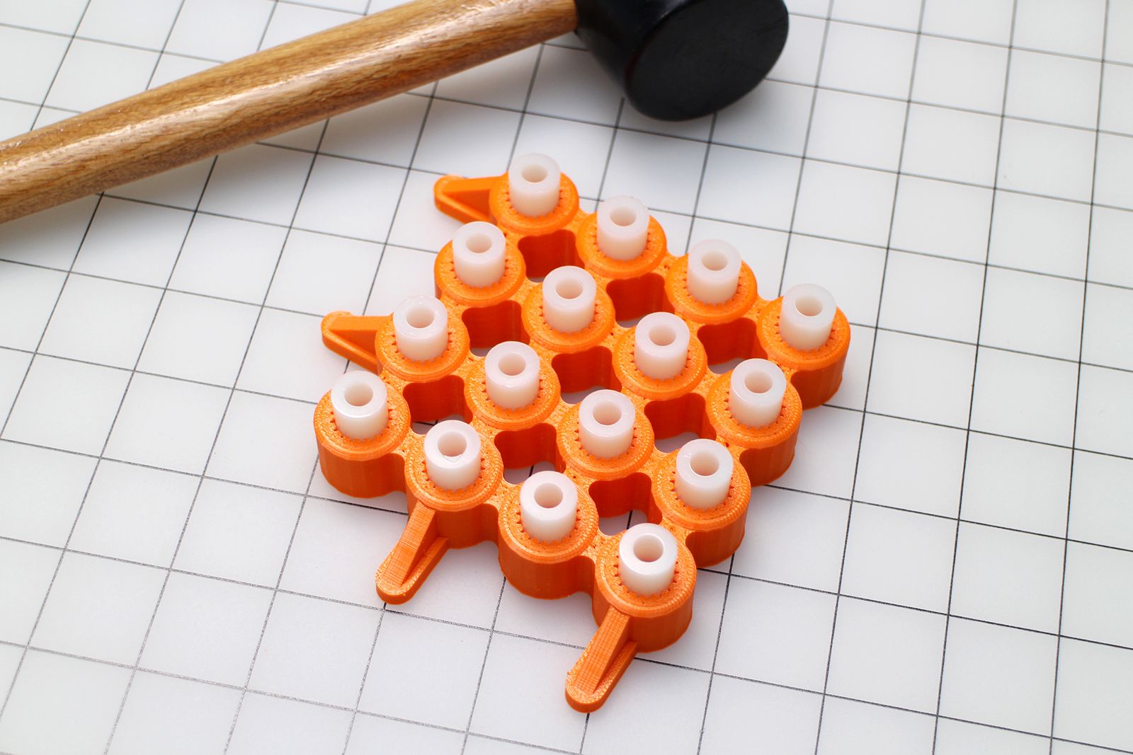

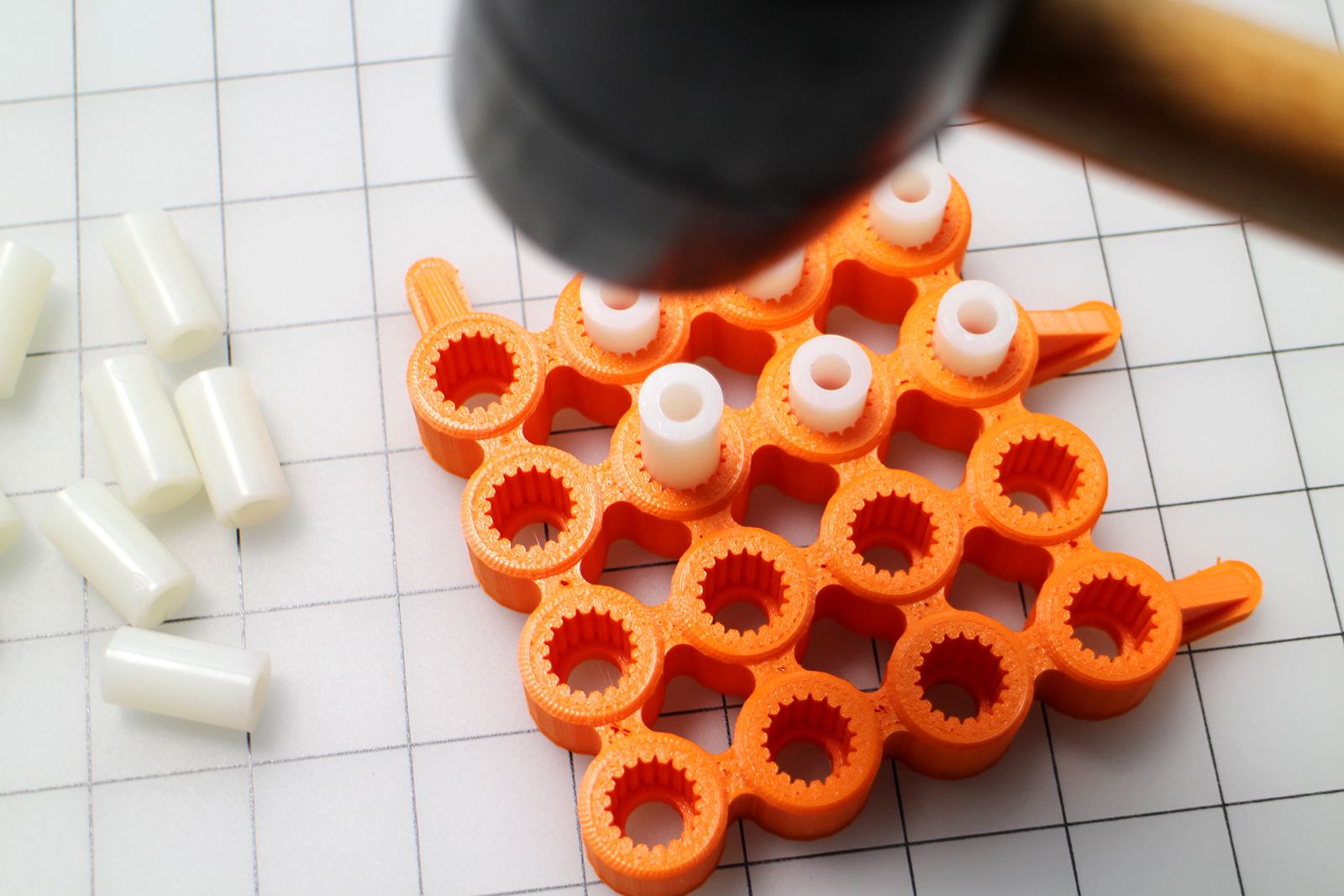

With the bottom (flat) side down on a sturdy work surface, use the rubber mallet to gently force a spacer into each hole of the jig, like pictured above.
Check to make sure that each spacer has been hammered all the way in!

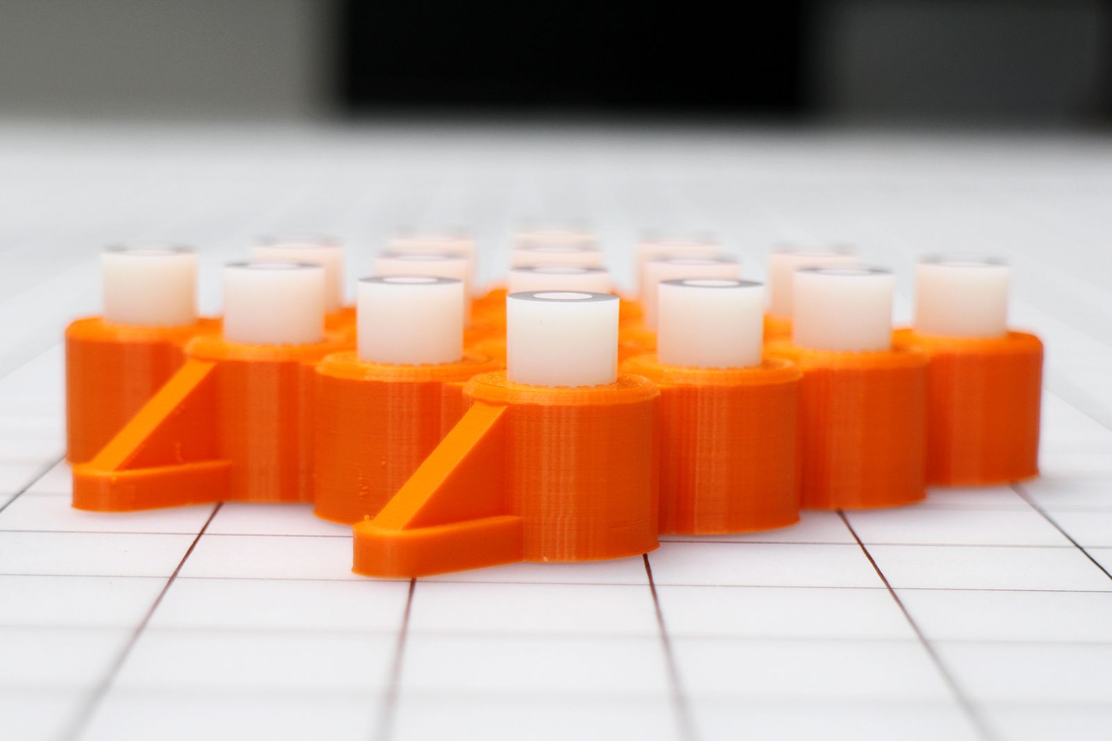

Next, turn the jig upside down so that the 4 holes the pegs will go into are facing upwards.
Rest one side of the jig – with two peg 'wings' – on the edge of the 3/4" scrap wood to support the wings while hammering in the pegs.
Gently hammer a peg into each peg hole.
TIP: The pegs fit pretty snuggly into the holes, but if you have any 5 minute epoxy or e6000, it wouldn't hurt to add a little dab into each hole before hammering in the pegs.
Make sure to check that the pegs are sitting straight up and down, and not at an angle.
Voila! You are now ready to make your custom pegboard!!
REPLACING THE NYLON SPACERS
It's a good idea to replace the spacers after a few uses, as the drill bit will wear down the inside, creating more space, which makes for sloppier, less 'straight up and down' drilling. This affects the accuracy of the hole placements.
To do this, you can either use pliers or channel locks to wiggle the spacers out, OR
You can use a wide flat head screwdriver and hammer to tap out spacers from below.

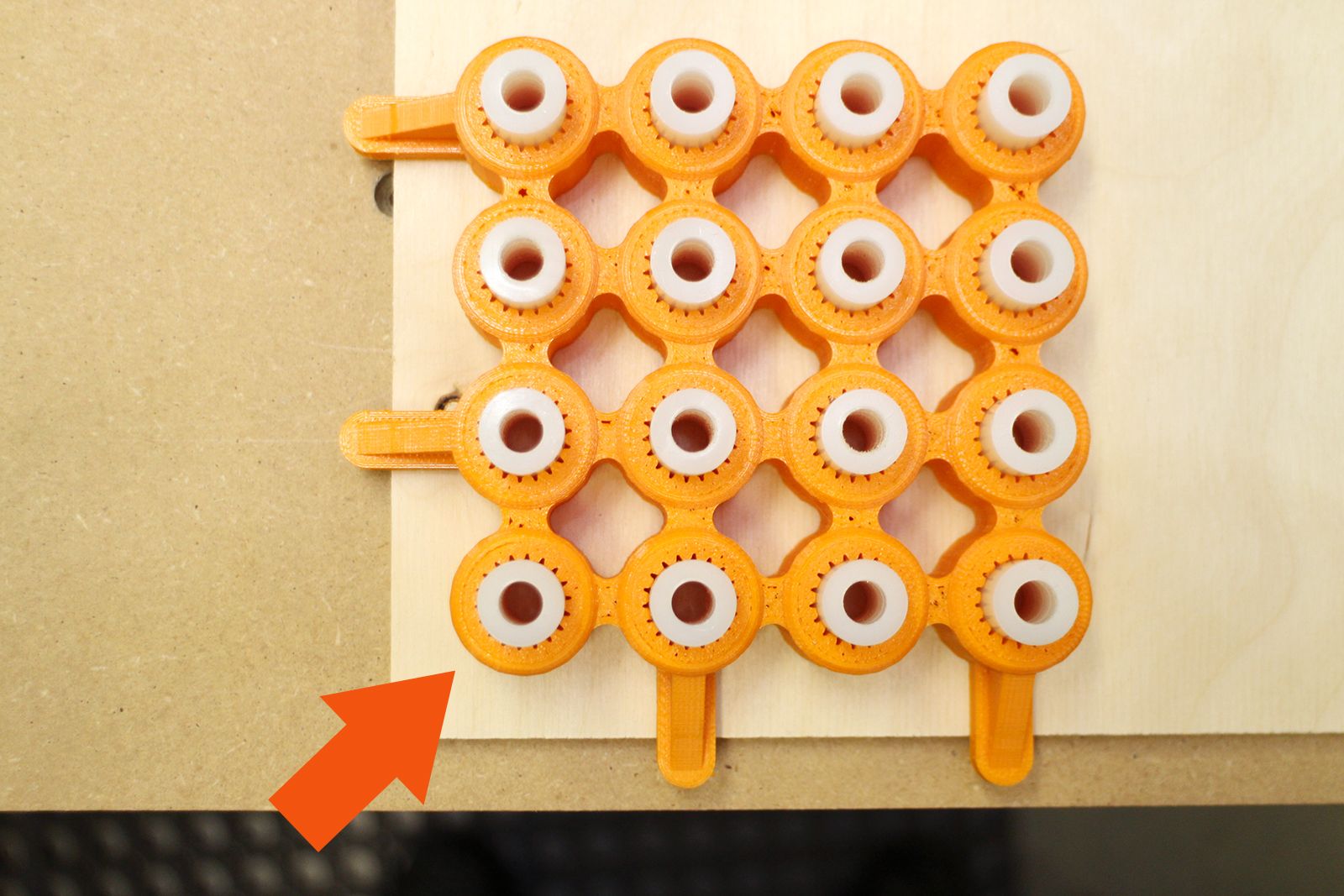

Step 4: Using the Jig
Using the jig is the easiest thing!! Here's the goods on how it's done:

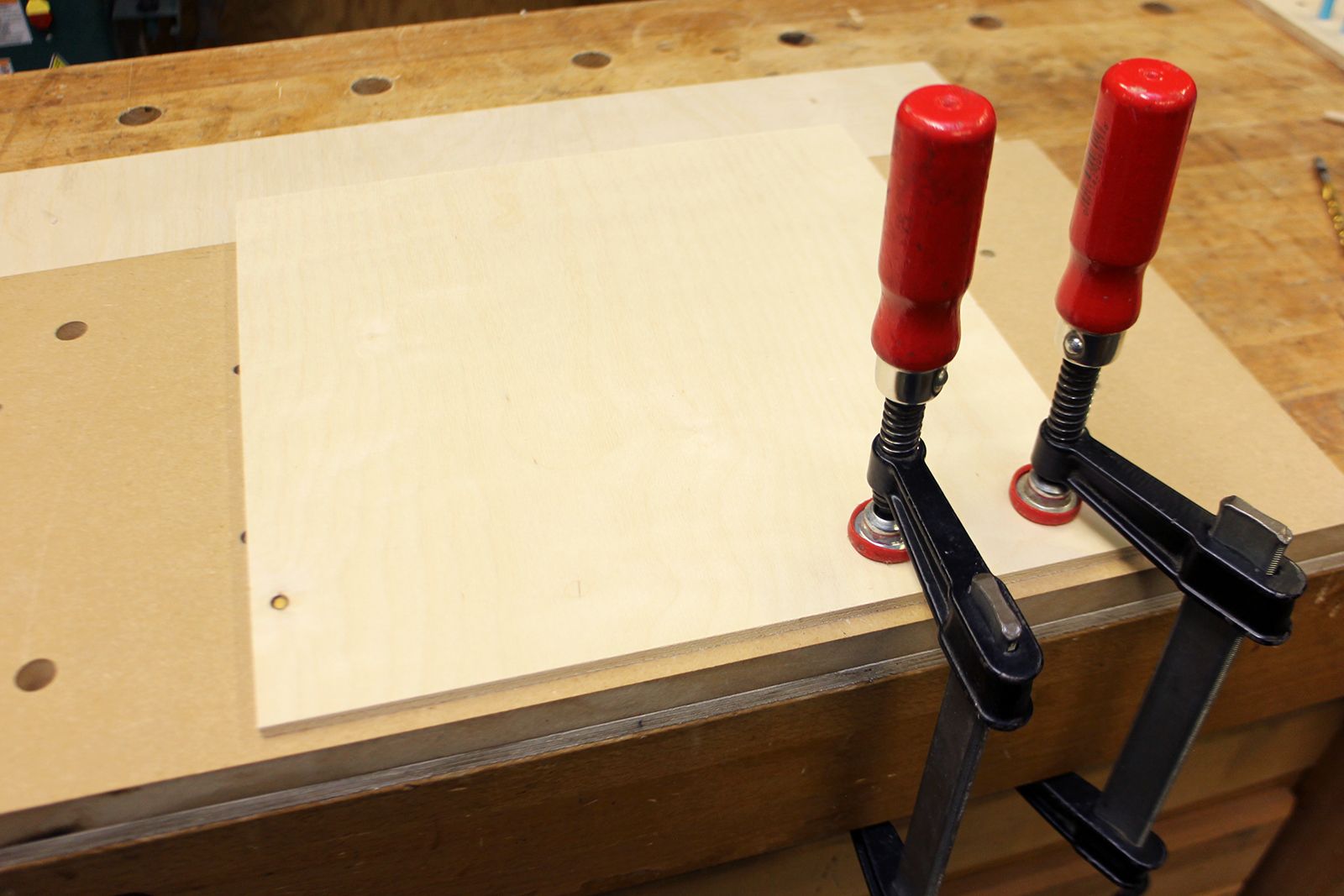

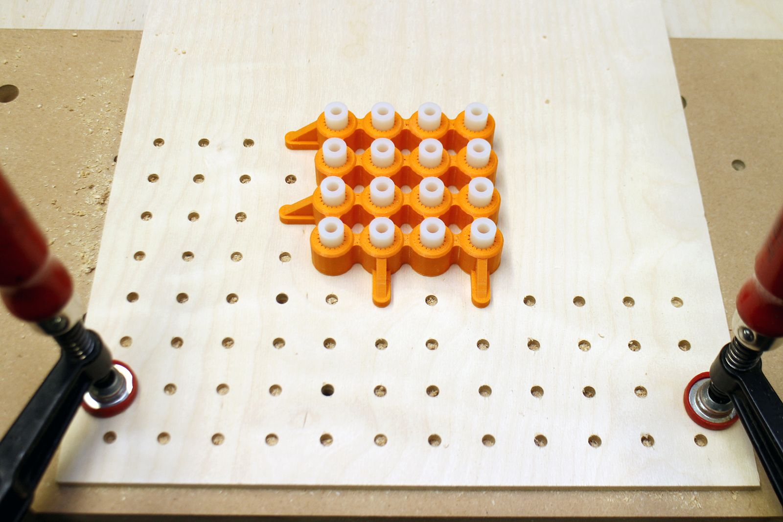

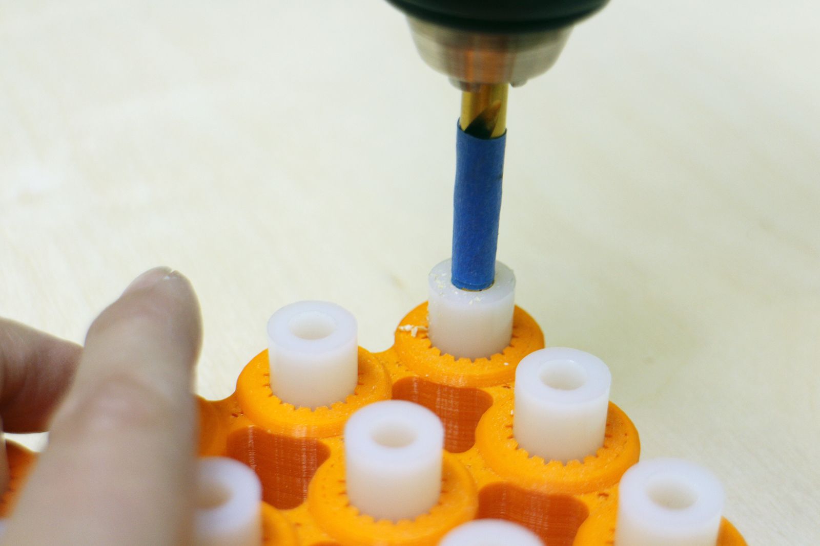

  • Put down the scrap piece(s) of wood on a sturdy work surface and clamp the 1/4" peg plywood , along with the scrap wood, to the surface. Put both clamps on the right side, like pictured, to start.
  • Place the jig in the lower left corner of the 1/4" ply.
  • Press it inwards diagonally, until the bottom two pegs are snug up against the edge of the board closest to you and the left two pegs are pressing against the left edge of the board.
  • Place the 1/4" drill bit into the handheld drill.
  • Use masking tape to mark how deep you should drill. This visual guide will help keep you from drilling through your scrap wood into the work surface.
  • Place your left hand on the jig and press it down and diagonally in towards the center of the 1/4" board – so the pegs are firmly pressed up against the sides of the board.
  • Drill the top right hole, keeping the drill bit as straight up and down as possible. (The nylon spacer will guide the bit, but it's good to not put too much pressure on the inside of the spacer, as to not drill away the nylon material.)
  • Stop drilling when you reach the bottom of the tape guide.

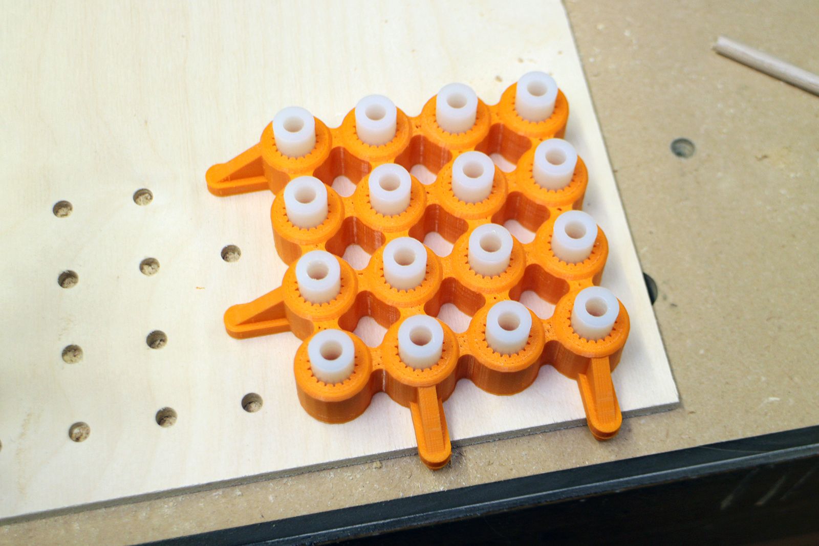

  • Remove the drill bit – and while holding the jig in the exact same place – press one of the two 1/4" dowel pieces into the hole that you just drilled. This secures the jig in place.
  • Next, drill the bottom left hole.
  • Use the second dowel piece to further secure the jig in place .
  • Drill the remaining holes.
  • Remove the dowel pieces.
  • Remove the jig.

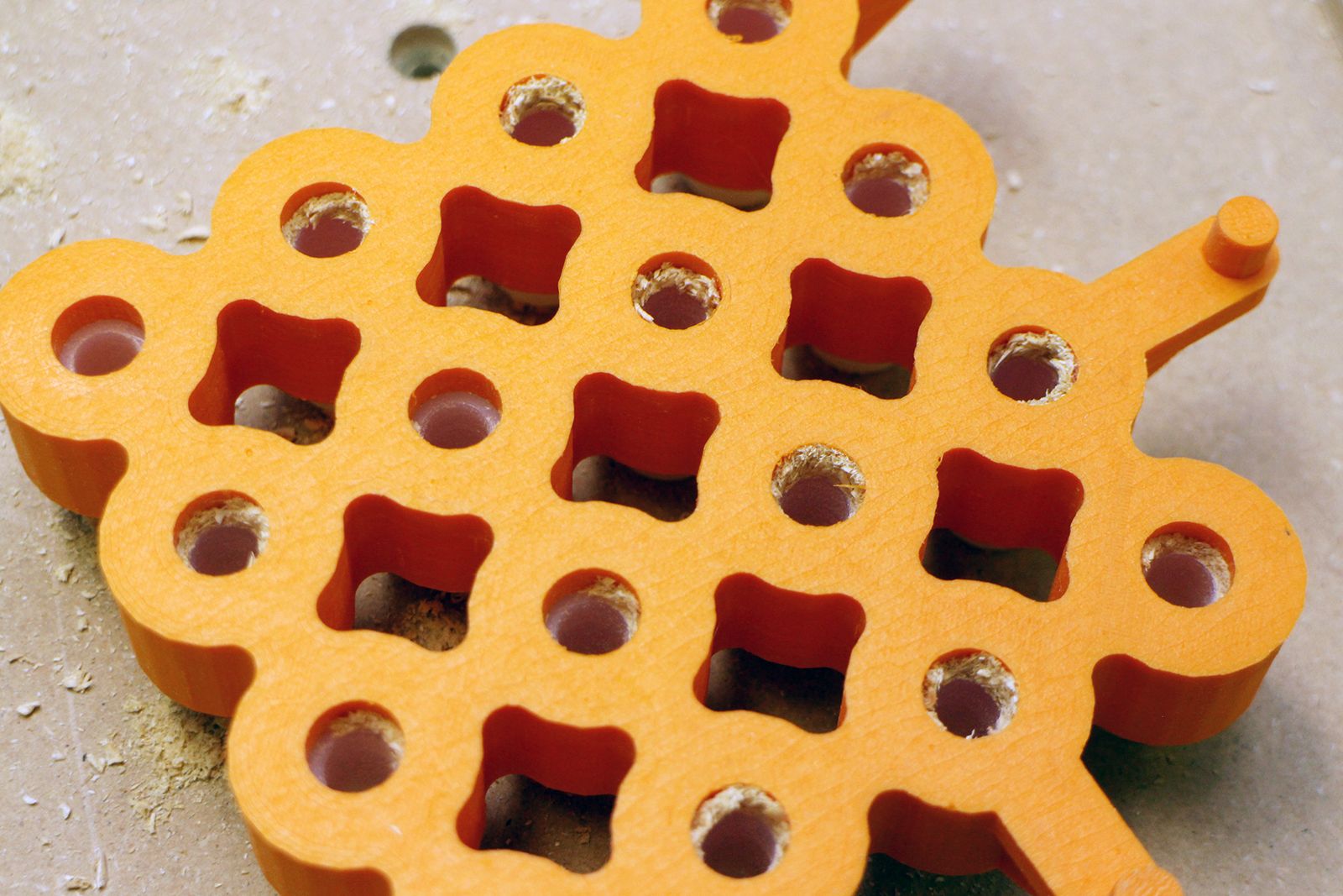

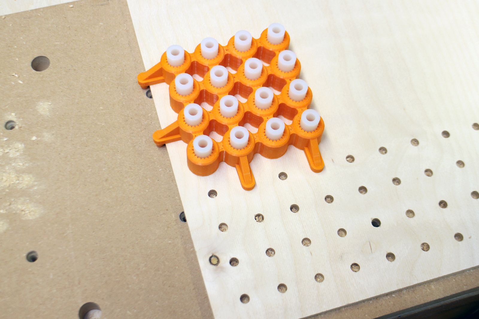

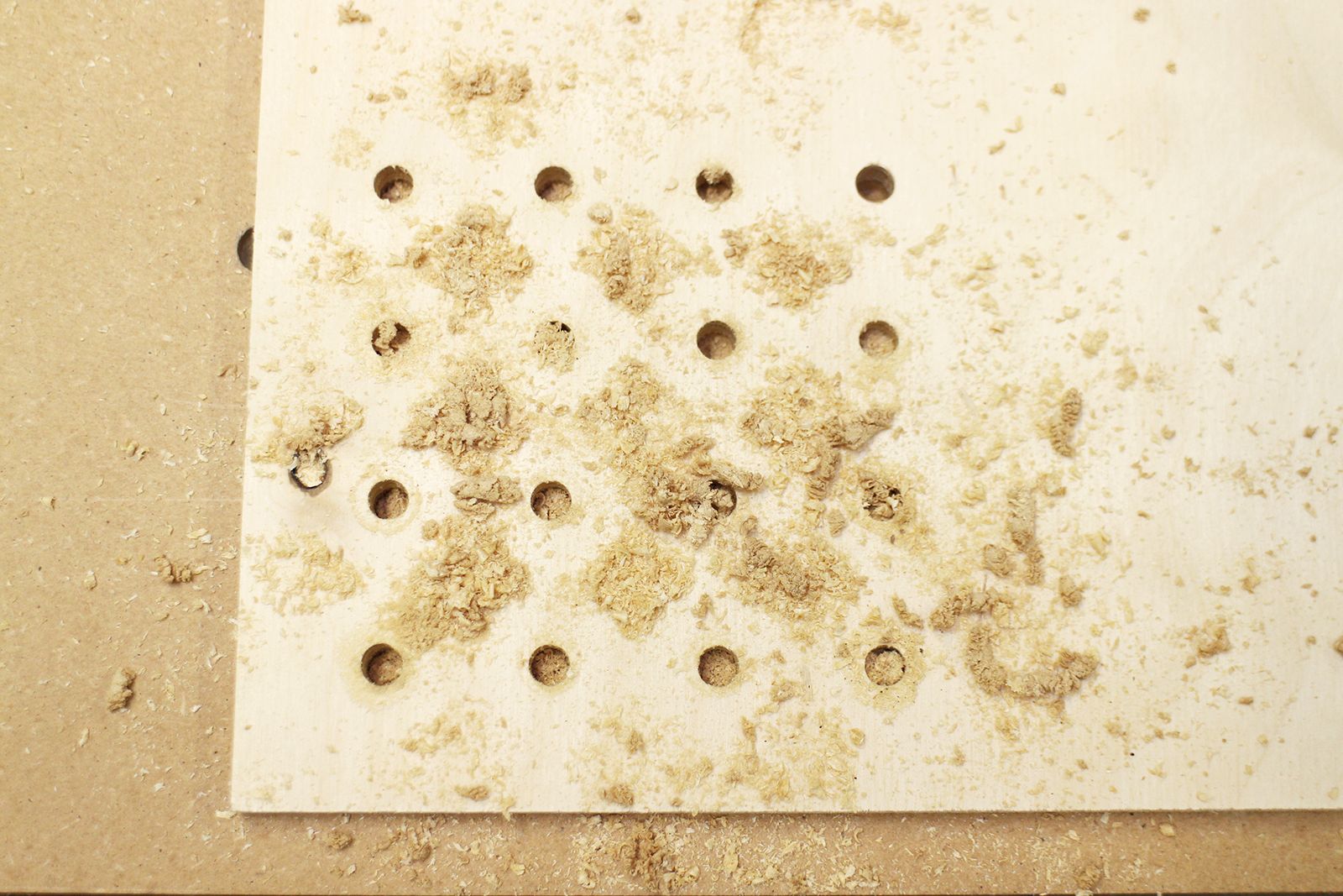

  • You will get some build up of sawdust in the opening of the holes on the underside of the jig.
  • Use compressed air OR the 25/64" drill bit to remove it so that the build up doesn't become so much that the jig won't sit flat on the plywood.
  • Undo the left clamp and move it to the right corner.
  • Clamp the right corner down.

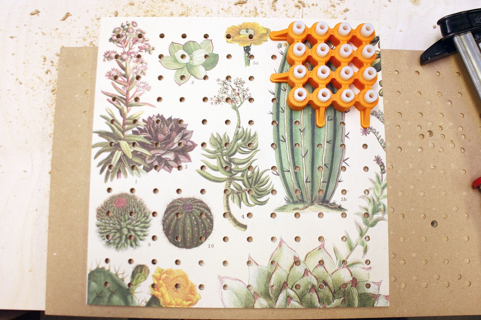

  • Place the left two pegs of the jig into the top right and third down from top right holes that you just drilled. The bottom two pegs should be pressed up against the bottom edge of the plywood.
  • Repeat the above drilling + top right dowel steps. (No need for the bottom left dowel.)
  • Move the right corner clamp to the left side and repeat the drilling steps for the bottom left corner.
  • Next up is the middle row! The left two pegs should press up against the left edge of the plywood while the bottom two pegs go into the 2nd and 4th in holes, like pictured.
  • Rinse and repeat for the rest of the board!

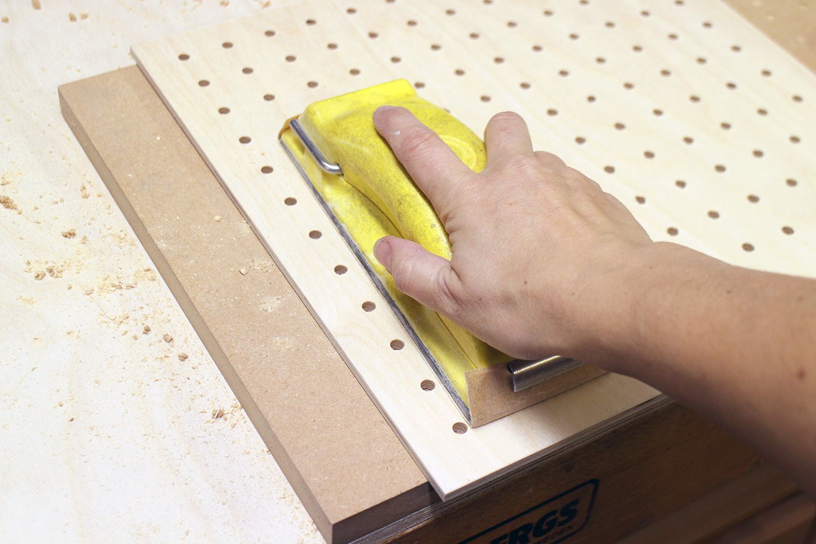

Oh wait! One last step: use a sanding block with 220 - 400 grit sandpaper to remove any splintery bits from both sides of the board.
Ok, NOW you're ready to hang and use your pegboard!

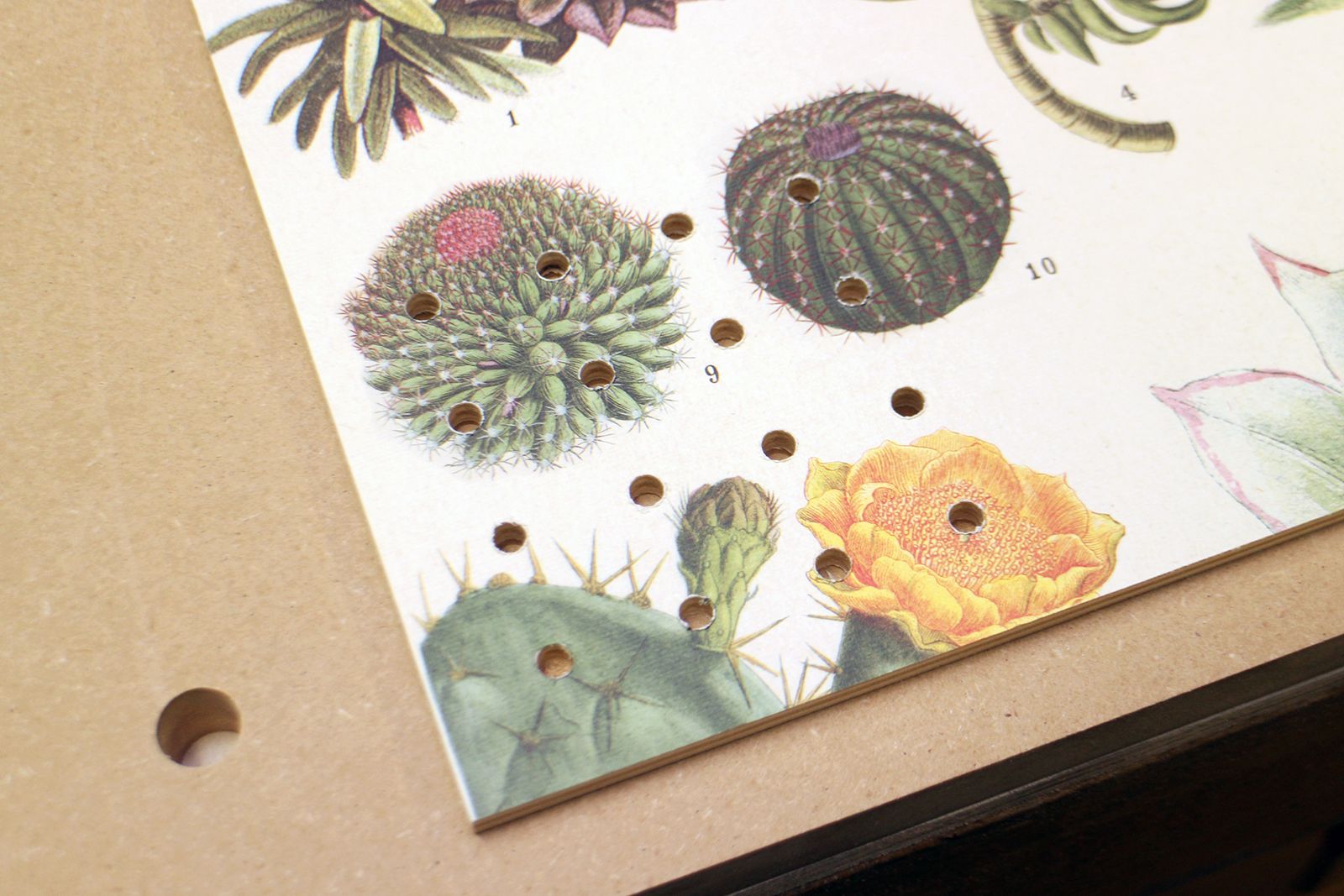

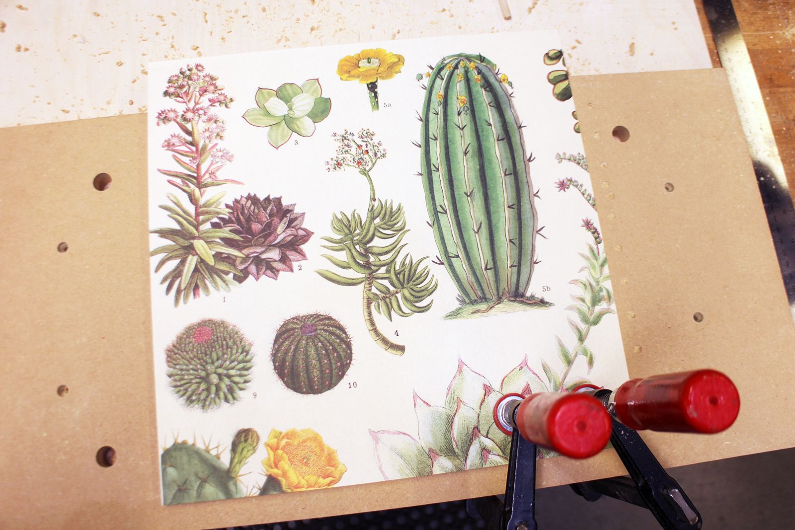

I recommend applying any finish, including paper, BEFORE drilling the holes. Otherwise you may get finish material into the holes and that will make the inside diameters of the holes smaller.
Below I show you how to use paper to cover your pegboard.

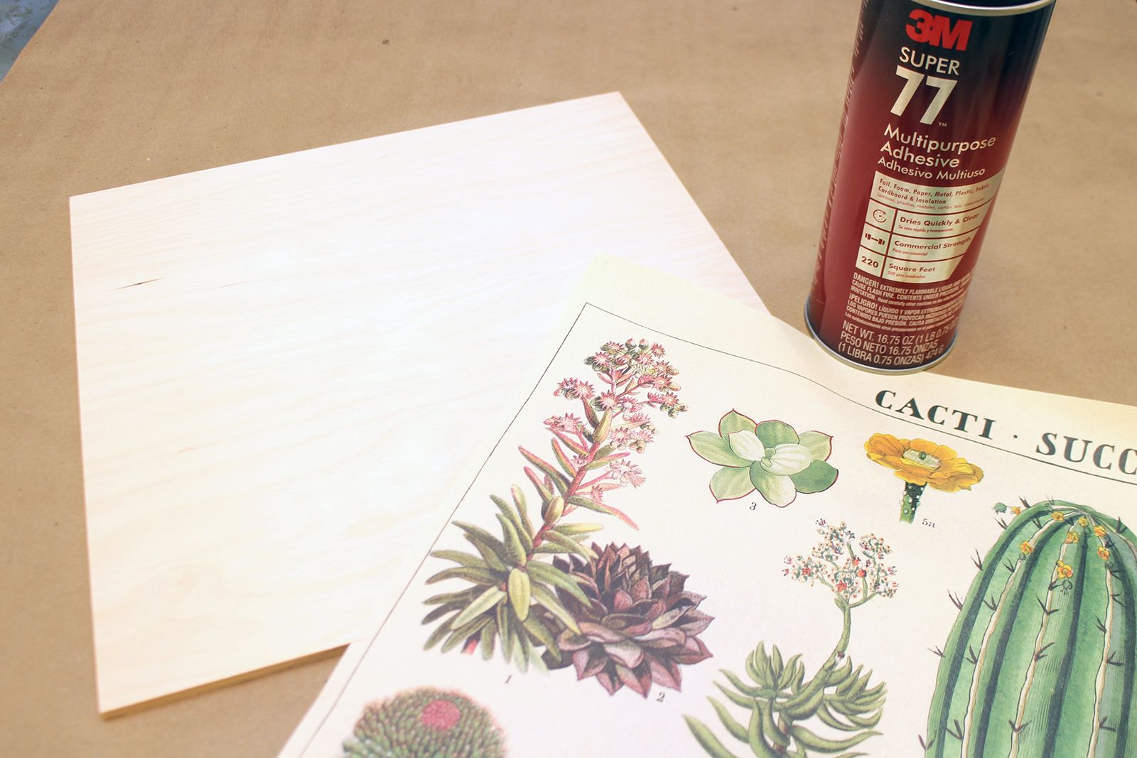

You'll need:
  • 1/4" plywood, cut to size
  • Decorative paper
  • Permanent spray adhesive
  • Exacto knife or box cutter

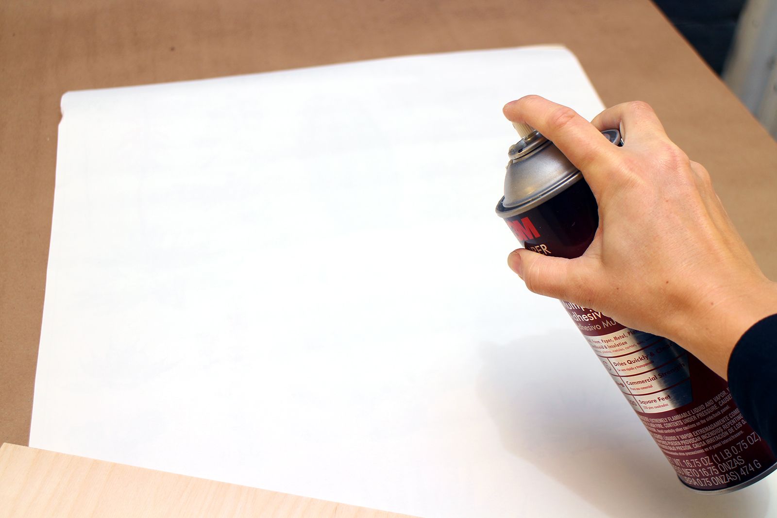

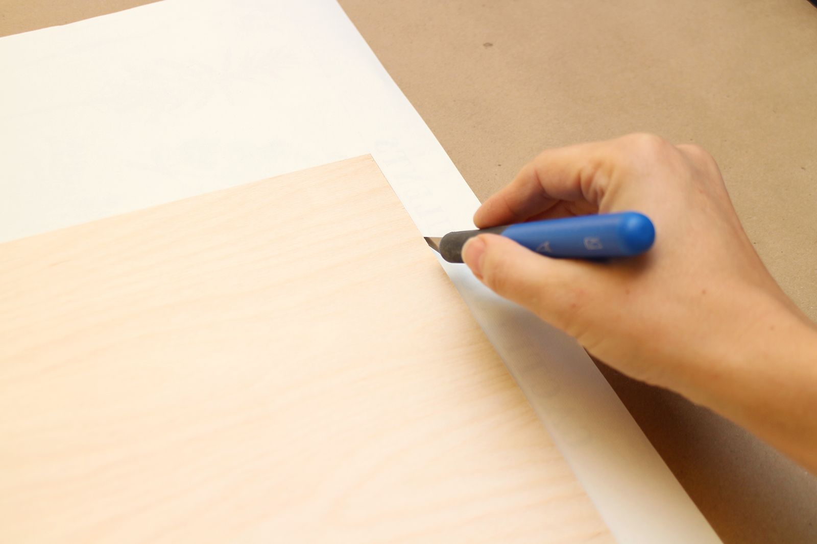

In a well ventilated area, and on a scrap piece of newsprint or cardboard, spray the back of the paper with the adhesive.

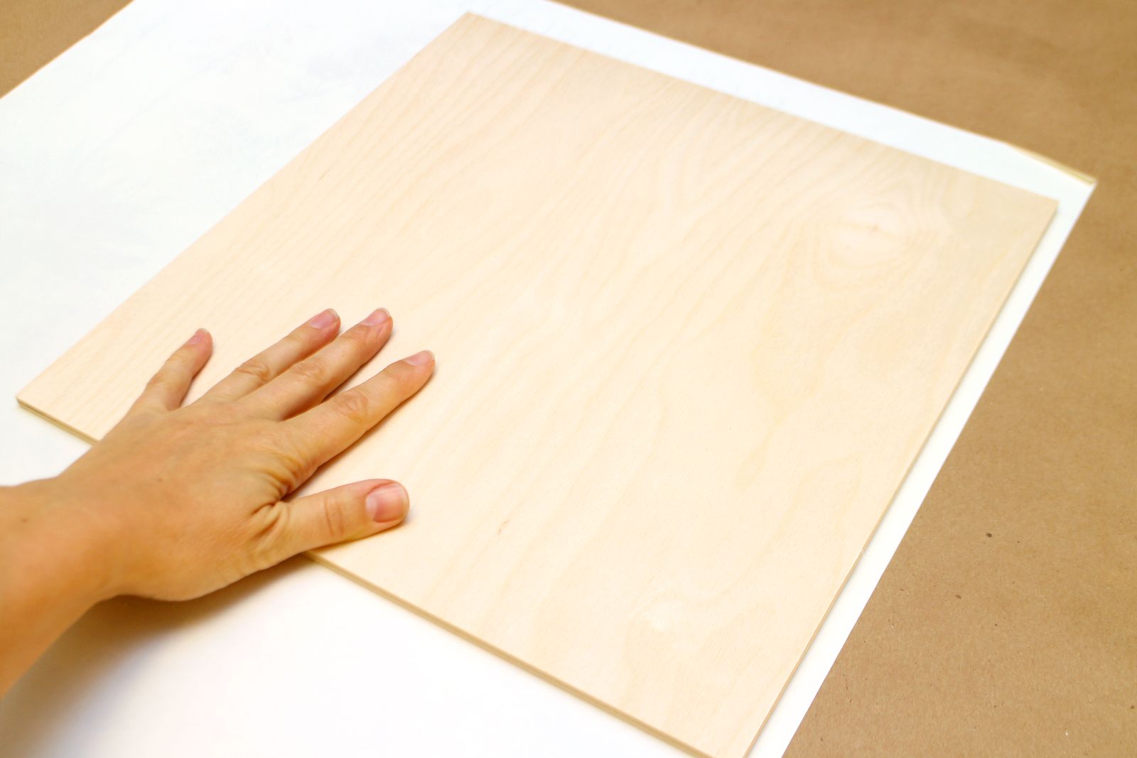

Place the plywood onto the sprayed paper and press it down into place.

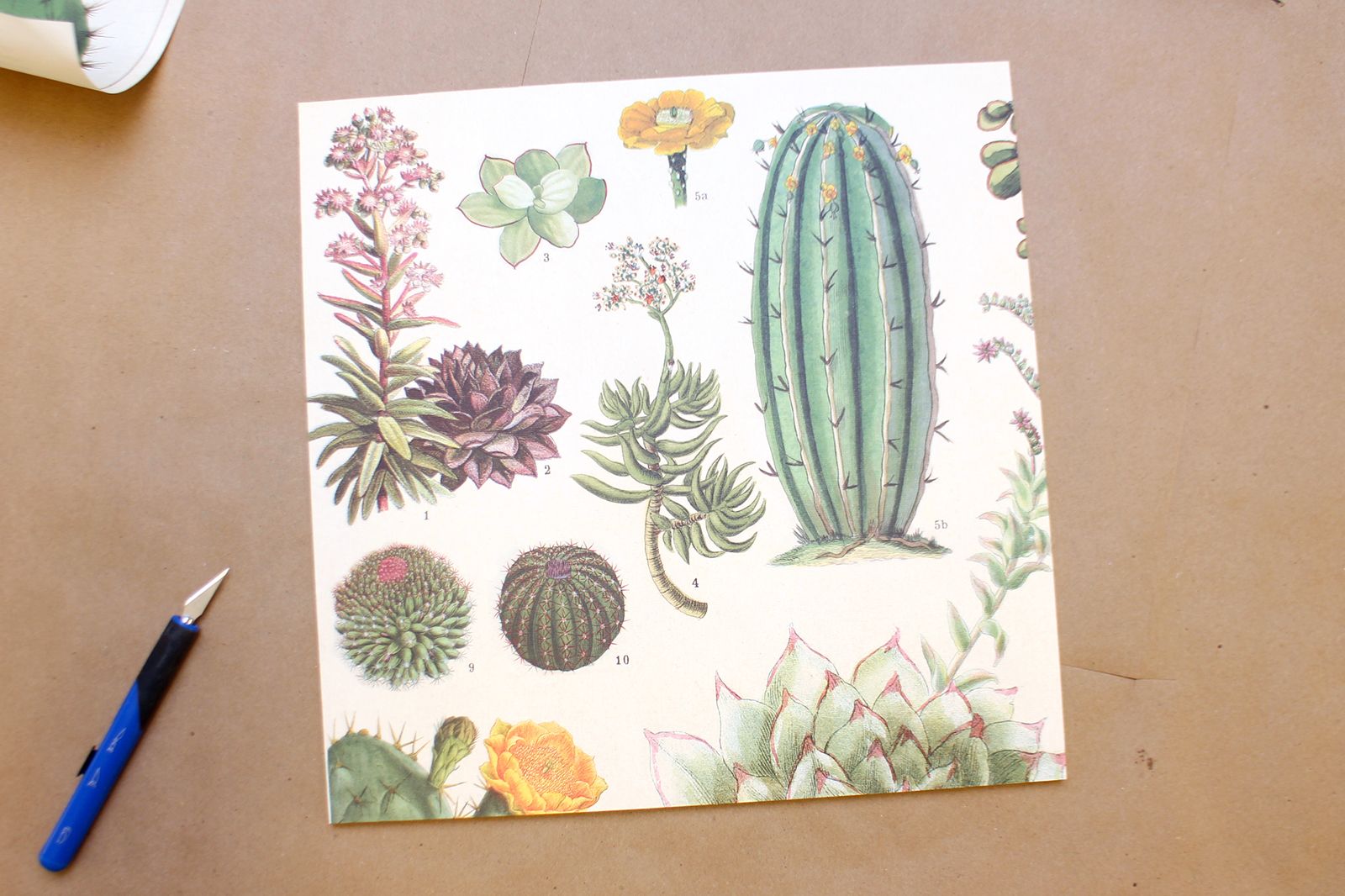

Using the edge of the plywood as a straight edge, use a sharp blade to cut the paper to the size of the wood.

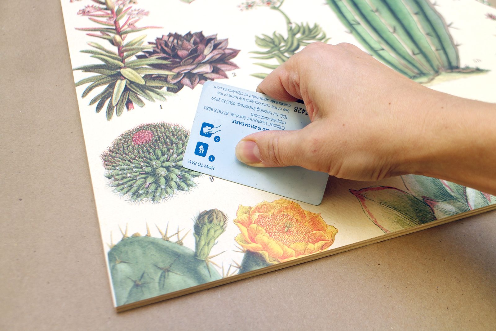

Smooth the paper into place using the edge of a credit card.
That's it! You're now ready to drill holes.
Be sure to clamp gently as to not mar the paper's surface.
There will be a small edge of 'tear' around the drilled holes. I tried different techniques of removing them, but in the end decided that it didn't look bad enough to worry about.
Follow the earlier hole drilling directions to make your pegboard – and you're done and decorated!

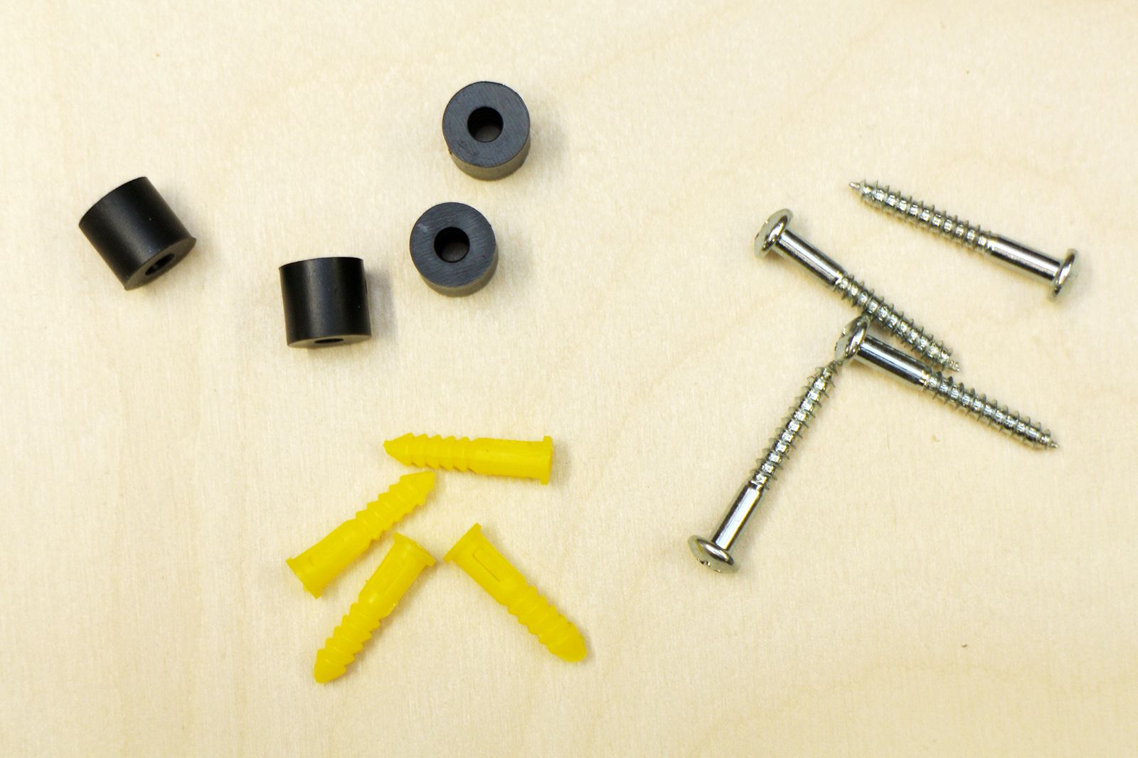

To hang your pegboard, you'll need a pegboard hanging kit.
Follow the instructions on the packaging.
