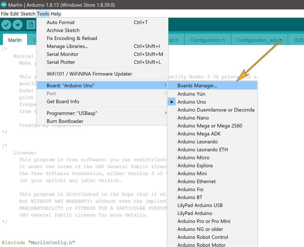

Press OK to dismiss the preferences dialog box. Then, go to Tools > Board > Boards Manager.
Then, search for “Sanguino” and install the board.
Now that the Sanguino board is installed, backtrack to Tools > Board and select the Sanguino, which will now be in the list.

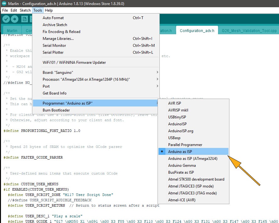

Then, with the ArduinoISP sketch uploaded to the Arduino Uno, open up the Musical Marlin firmware.
Next up, we will need to tell the Arduino IDE that we are using an Arduino as a programmer. To do this, go to Tools > Programmer: > Arduino as ISP.
Lastly, to burn the bootloader, go to Tools > Burn Bootloader. This will flash the bootloader onto the Ender 3 controller.
