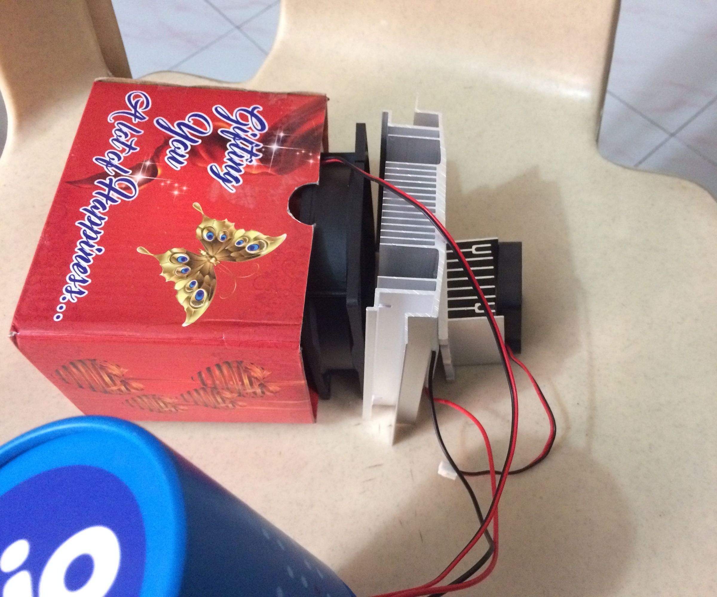

Step 2: The Attachment
1. Connect the heat sink to the peltier
2. and then stick the fans on either sides
3. Use heat sink paste to stick the peltier to the heat sink as shown in the figure.
4. Connect the bigger one to the hotter side
Step 3: The Connections
1. Now connect the fan to the power supply as illustrated in the picture
2. Connect them in parallel so that the voltage is distributed equally.
3. You can also directly connect it to a 12 volt battery
Step 4: Cool Off..
Now connect a box or keep it in the open you can create a cooling agent
The peltier cools one side of the peltier and the heat sink takes it and the fan blows it off..
