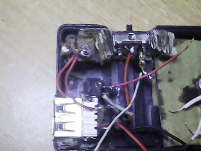

1.Decide a window in your box where you want the LED lamp to be placed, (you can make the lamp by super gluing the three bright l.e.d s side by side , and connect them in parallel.) Then glue the lamp in a cardboard sheet, which should be of the same dimensions of your window, then cut that piece of plastic out and place your lamp on that. Use super glue to place it permanently. You can also place the leds in the plastic pane, you should do what suits you best.
2. Now make small cavities on the top side of the box for placing the two outlets, don.t place the usb port facing upward as it can dislocate from its position while removing a usb cable.
For placing the usb port, you will have to make a rectangular cavity on the side of the box, be sure its on the same side where the other two outlets are.You can provide the outlets support by placing glued bits of cardboard side to side with them and gluing them together.
3.Now place the two switches like i place them, and use cardboard bits if necessary.
For making the bypass switch , find a switch which has 5 connectors and connect the power- in wire to the middle one.Connect a 200 ohm resistor to one of the extremities, and a wire to the another, then join the free end of resistor to that wire on the other side. Cut out the remaining connectors and solder everything on the switch.
4.This circuit works in a parallel combination so you will have to connect the +ve terminal of each outlet to one red wire and the -ve one to a black one, solder it out, and for the lamp , connect the +ve wire going out from the lamp to that resistor and solder it. Also connect the "power in " wire to the +ve wire of the outlets, and connect the -ve wire of the outlets to the -ve terminal of the led circuit.
(oh yeah, for the indicator light, connect a resistor to one of the end of the green led and join its +ve and -ve terminals to the wire hub we have created so far.)
Finally place the main ON/OFF switch to side and join one of the wires of the hub with it, connect the other wire of the hub with the battery directly, finally join the other free end of the switch to the battery and solder everything up............phew! we're done for now.

Step 3: The Result.
Now for the finishing up, glue the wires carefully to sides and the base of the box, so as to provide room for the battery, and use duct tape/heat sink to insulate any free joints, close the box and glue it up.............we're done.
