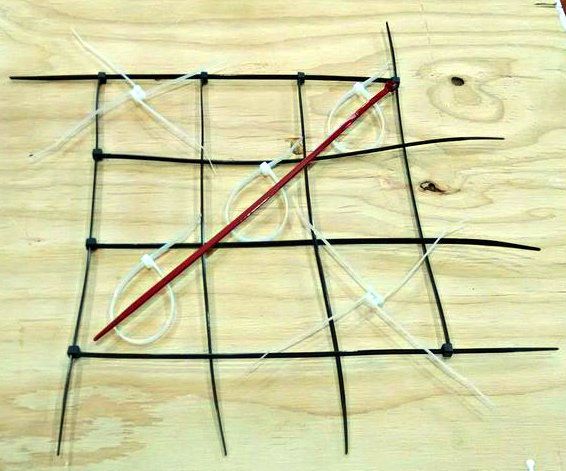

Rub the cure evenly on all sides of the meat. I don't have a picture of this, but I have provided a helpful technical drawing.
