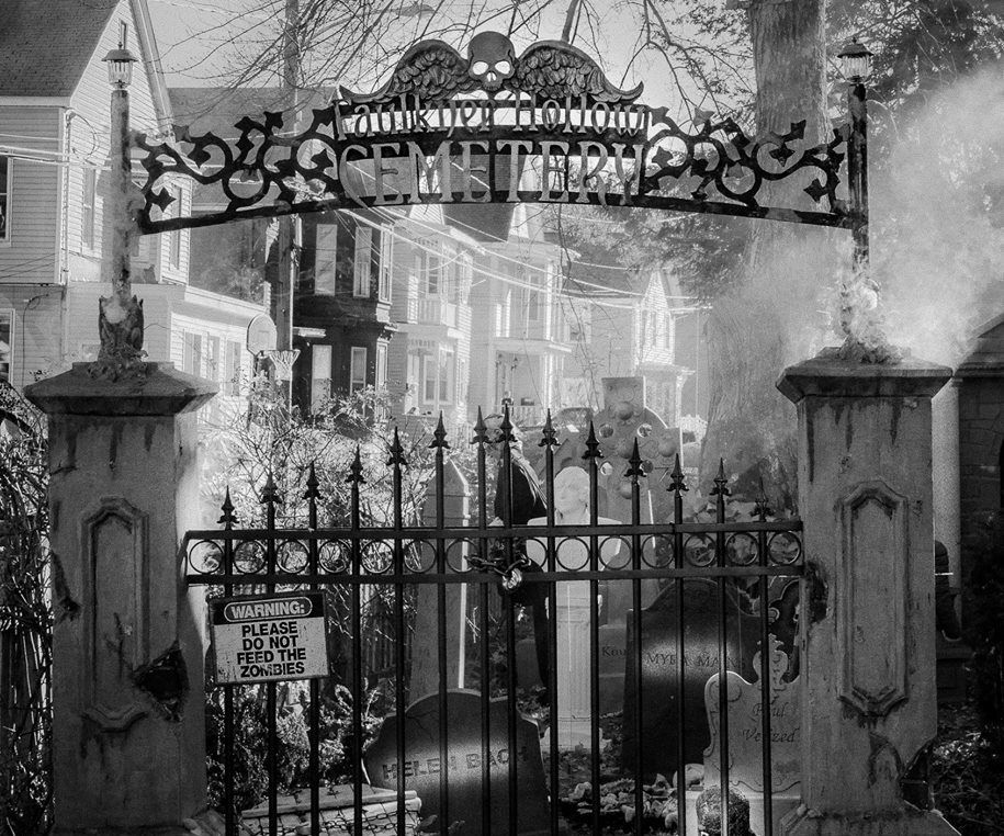

Fortunately, I already had a technique for creating what she wanted that I developed for doing my Halloween displays, shown here. I decided that while I was working on this that I would finally get around to documenting my process and sharing it with the Instructable community. You can use it for creating stone walls, stone blocks, or bricks.
