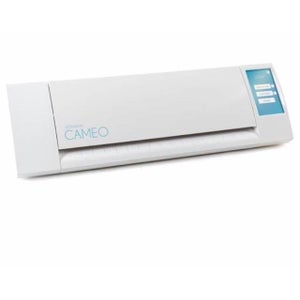

Our makerspace is equipped with a few Silhouette Cameo 2 machines and a low power laser cutter. Use what you have and adjust accordingly!

I demo how to use the machine including figuring out depth settings, attaching cardstock to the mat, and running test cuts to dial it all in. I stress this as a time saver. There is always someone who does not heed my warnings and will spend a lot of time on unsuccessful cuts. This is part of the learning process and thankfully cardstock is cheap.
