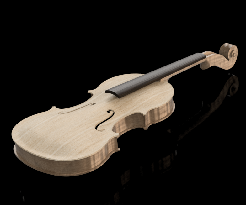

Introduction: Making Violin Ribs
Now that I have completed the process of modeling the Guaneri 'del Gesu' Vieuxtemps violin and making the mold its time to start building. I will be leveraging the CNC as much as possible in order to make theses parts as precisely as I can. In the past I have bent sides for guitars, mandolins, and violins by hand on a bending Iron, while this process is defiantly challenging and interesting I have also found its accuracy a bit lacking. At some point I started making bending jigs with the CNC and bending the ribs of instruments over these forms. The process of bending sides over a form with a heating blanket is fast and accurate.
There are 4 four previous Instructables covering this build if your interested in this project.
