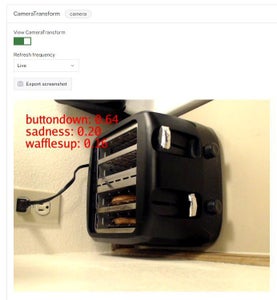

I also did a camera transform to give myself an easier visual for testing how accurately the camera was detecting waffles.
Transform a Camera

Although the steps here were fairly simplified I ran into a lot of stumbles that came mostly from my own incompetence. At a certain point I realized that the machine was learning but I was not. Adding a lot more images, and with different lighting and minute changes got my learning model to detect when my waffles were up and done cooking. As you can see in this picture the red text was the transform feature which made testing infinitely easier.
