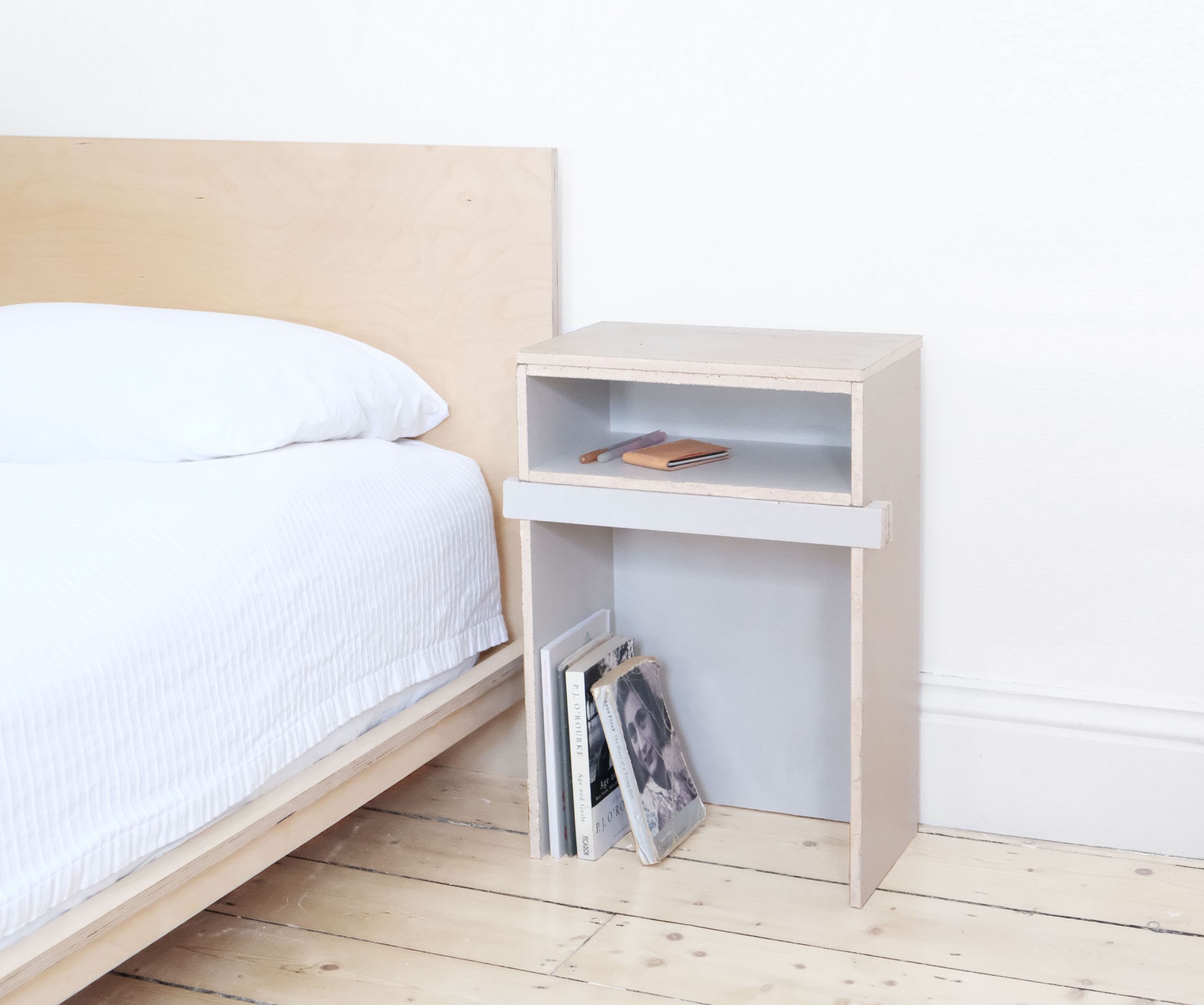

In this post, I’m going to share with you how I made this really quick and simple DIY platform bed! I hope this helps you complete this project for yourself or at the very least inspires you to get out to the workshop!

Step 5: Cutting Side Strips
With the frame complete, I could then move onto the Birch Plywood exterior. I started this by cutting 4 thin strips on the table saw, two at 30mm, and the other two at 42mm.
Step 6: Screwing Side Strips Together + to Framework
I could then screw these strips together to make an ‘L shaped’ segment and intern screw this assembly to the side of the frame.
Step 7: Cutting Front/Back Rest
For the front and backrest of the bed, I cut down some more birch plywood, using the table saw to establish the width, and a circular saw and fence for the length.
Step 8: Securing Front/Back Rest to Framework
After some light sanding off camera, these could then be screwed into the supporting framework also, with a line being drawn 150mm up from the bottom of both components to ensure the bed sat parallel to the floor.

Step 12: Adding the Mattress
Once they were all secured in place, I could simply add a mattress and then the bed was done!
Step 13: Finished!!
Although I used quite a few different tools on this project you could really easily have accomplished it with just a circular saw and drill, and the versatility of the design means it can be really easily scaled to fit either your mattress or requirements!
