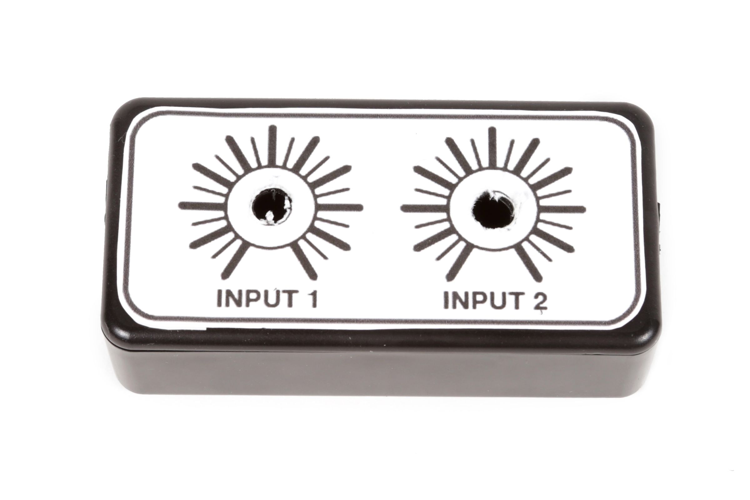

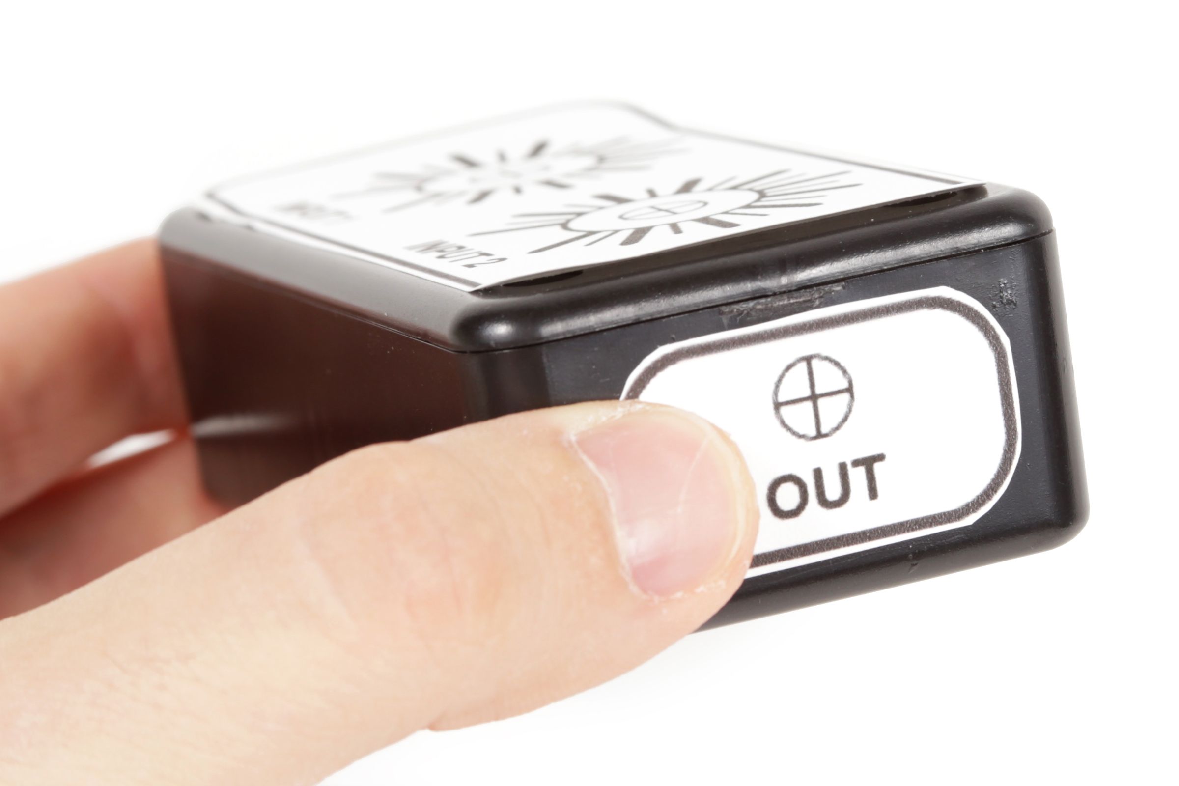

Step 6: Label the Enclosure
Typically enclosures are made as after thoughts for electronics projects. In most of these projects throughout this class we will be starting with the enclosure. Not only that, I am going to show you how to build them well. There will be no soap dishes with wires sticking out of them in this class. If you want to ignore my methodology and go your own way, that is your business. However, I intend to show you how to do it correctly.
First of all, aesthetics are important and you should always make things that look reasonably good. Why invest a lot of time making something if it's hastily jammed haphazardly into a travel soap dish as an afterthought? The nicer you can make this, the less likely it will be to get thrown away some day.
Secondly, understanding the constraints of the enclosure means that you have clearly planned ahead and know what needs to get done. This actually makes it easier to build and debug the circuit.

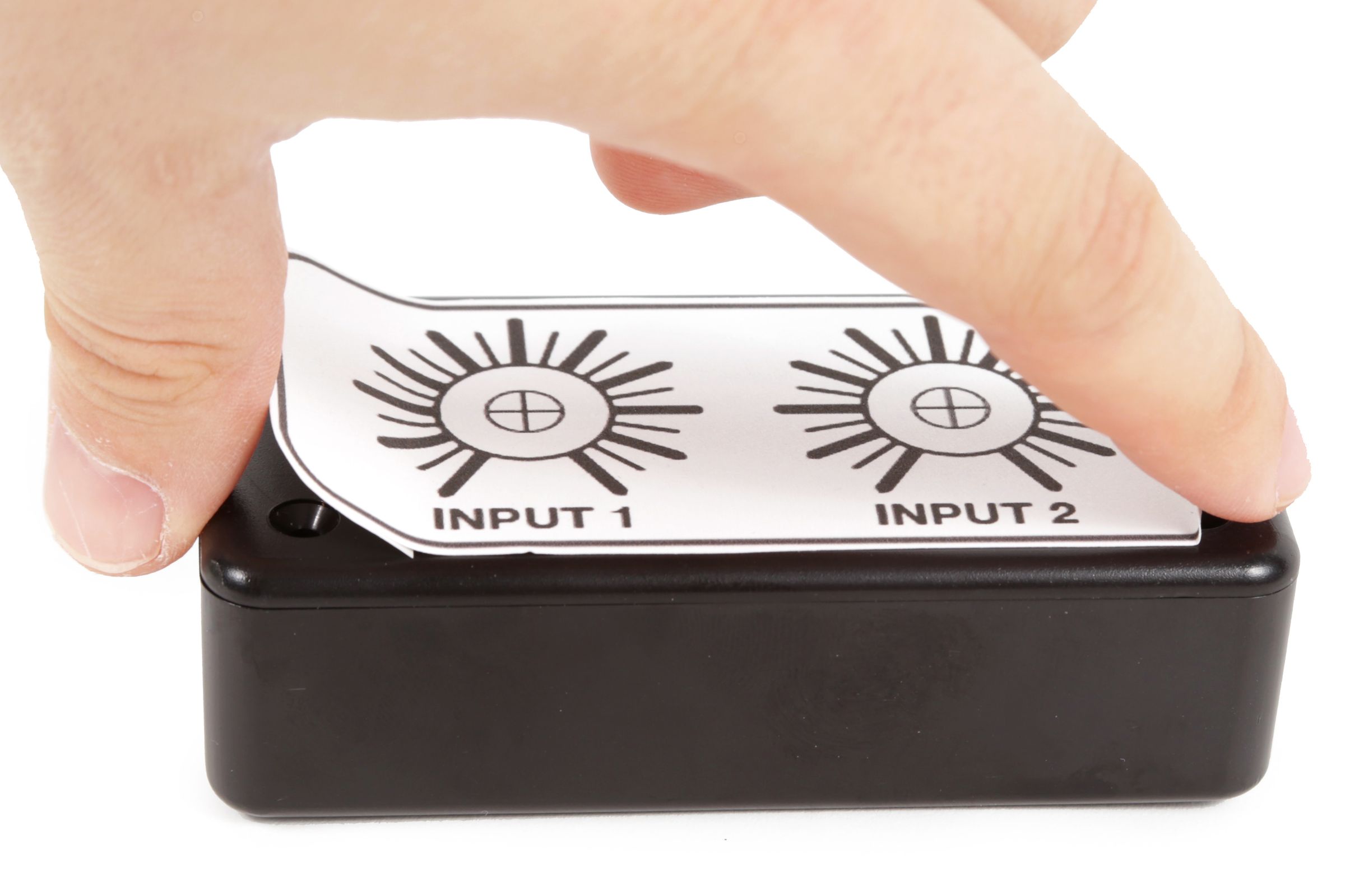

To begin, trim the labels down with scissors and peel the top label such that the far ends still have their backings on. This is where having split-back sticker paper comes in very handy because you can peel only a little bit of the label at a time.
The reason for doing it this way is because the enclosure's mounting screws will ultimately be hidden under the label. At the end, you will need to be able to get underneath the corners of the label to fasten the case shut. It is only at this point that the label will be fully applied.
Stick this partially peeled label to the enclosure's lid.

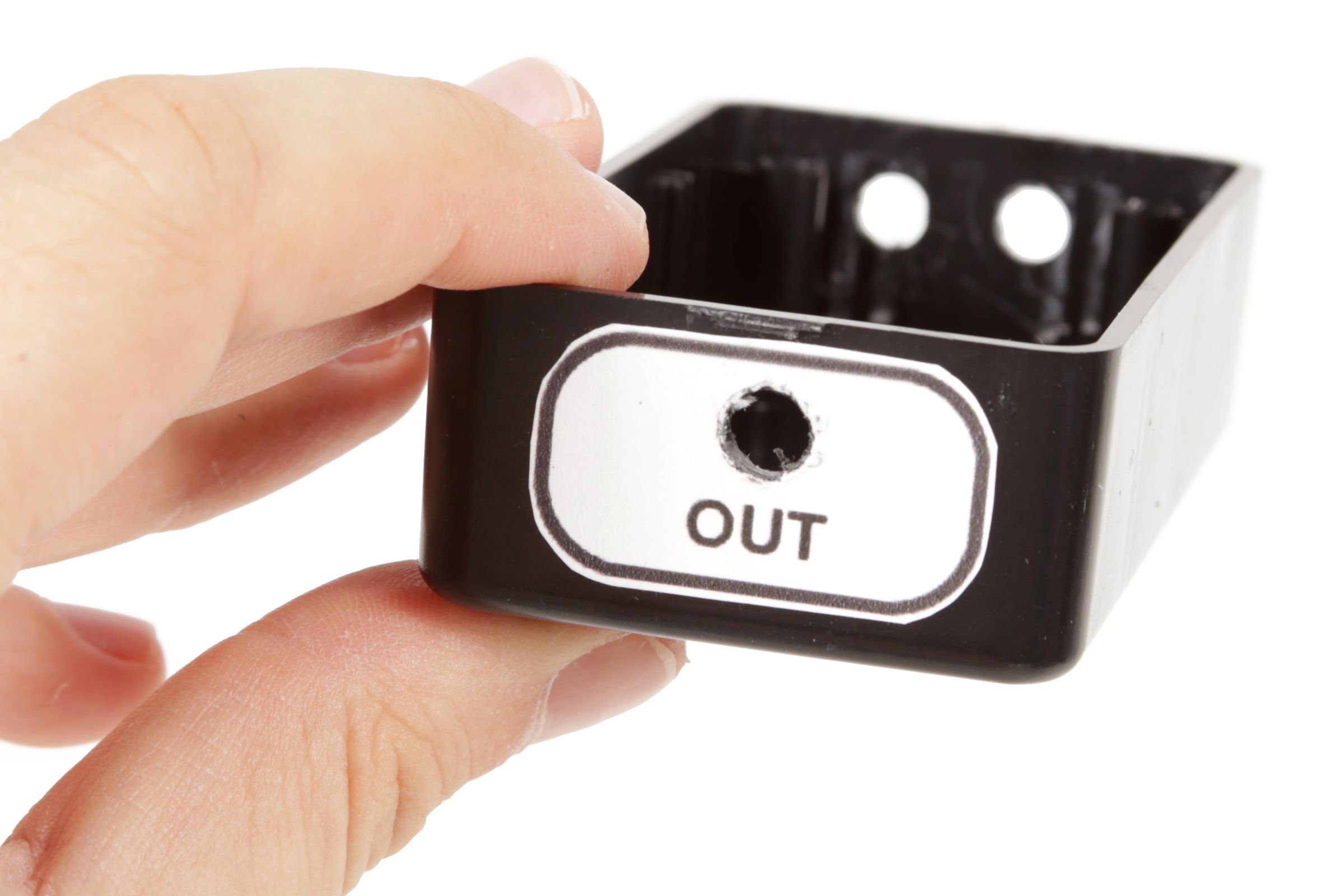

Also, while you're at it, stick the input and output jack labels to the sides of the enclosure.

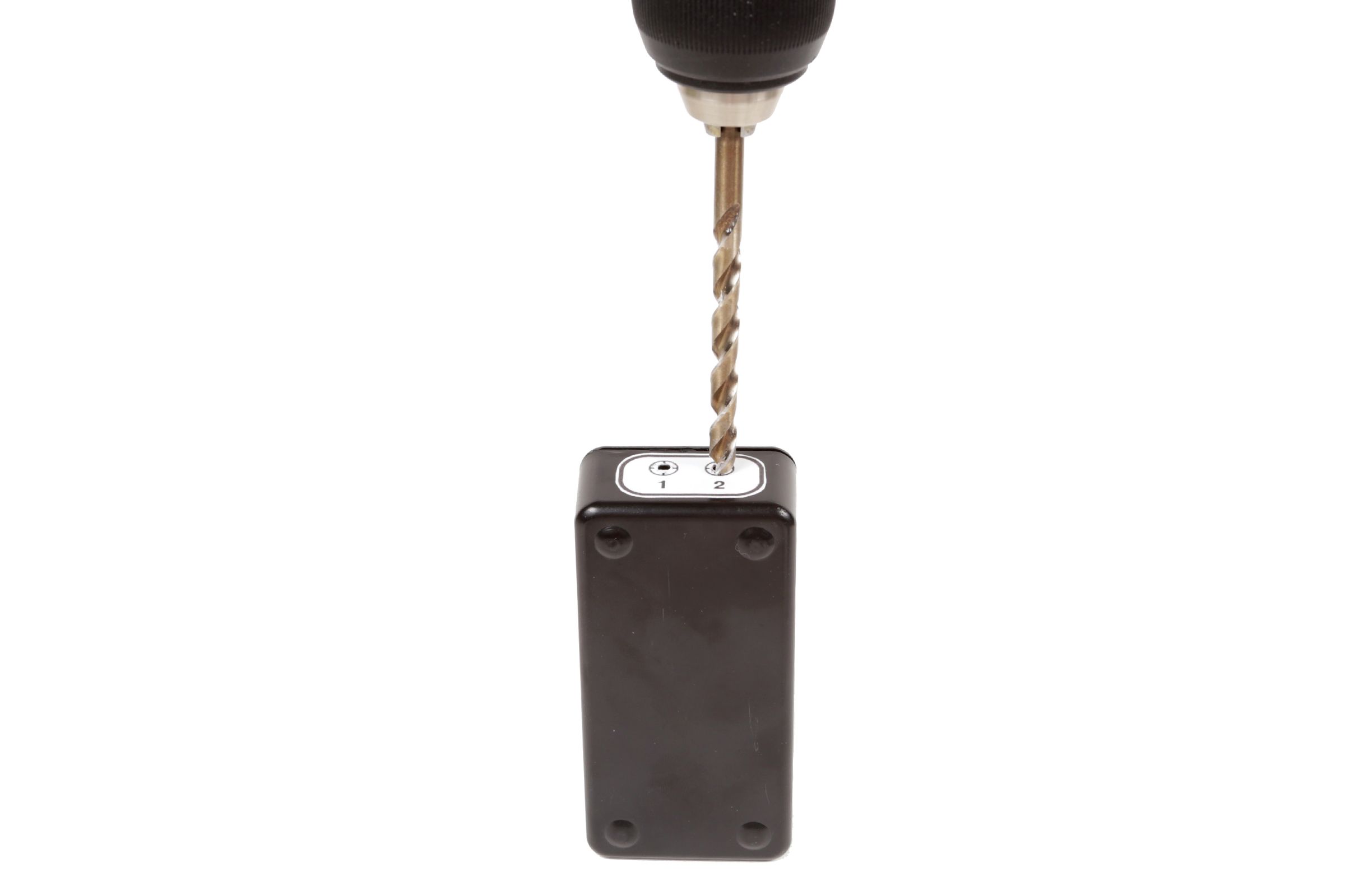

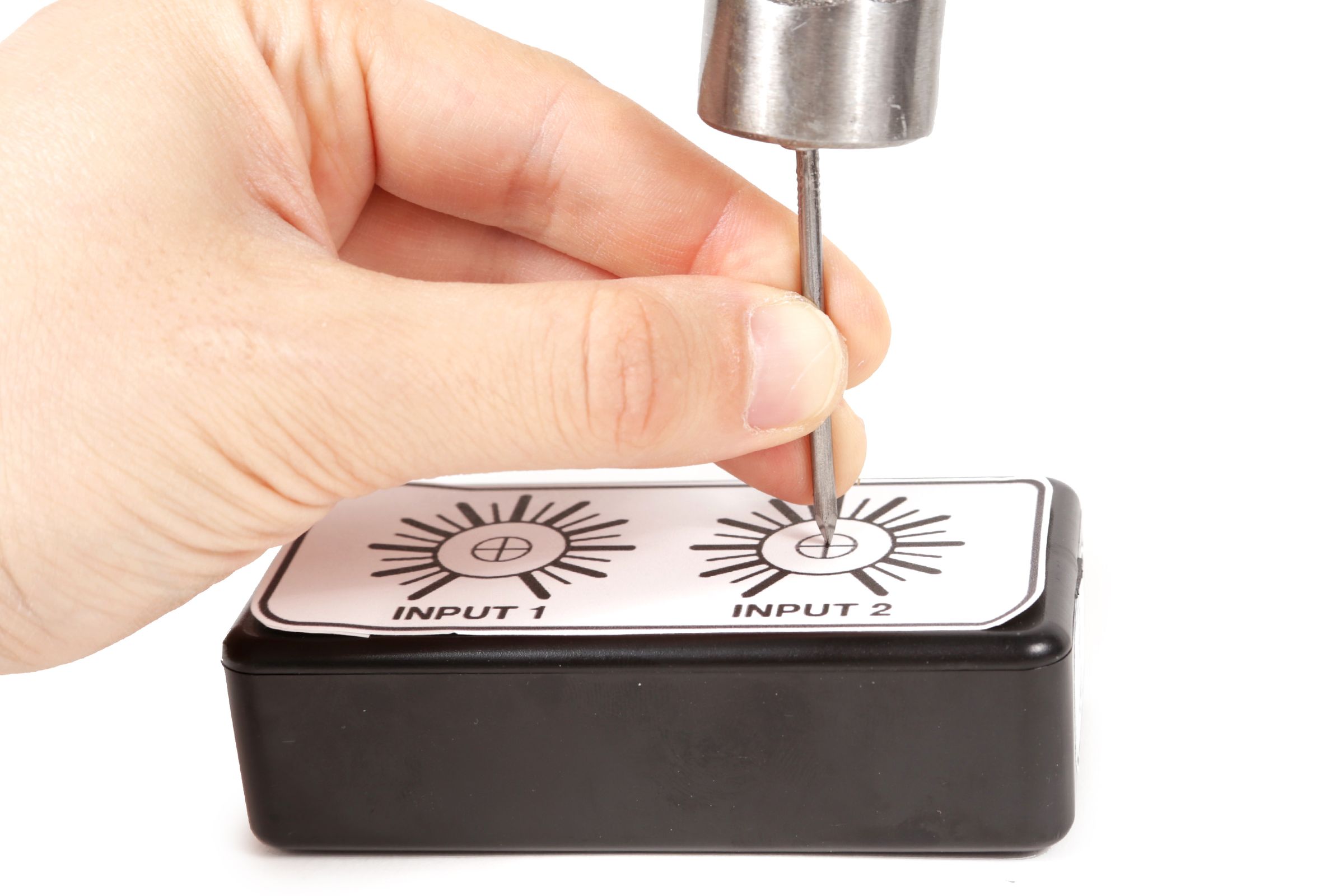

Step 7: Drill
Now it is time to drill holes in the enclosure for the potentiometers and jacks using the label's drilling guides.
Find the cross hairs on each of the labels and make drilling guides by tapping them on center with a hammer and nail. When working with metal enclosures, you will want to get a proper center punch, but for soft materials like plastic (and possibly aluminum), this is good enough.
Drill pilot holes in each of these indents using a 1/8" drill bit.
Next, widen the holes for the potentiometers in the lid with a 9/32" drill bit (the unofficial drill bit of most potentiometer mounting holes).
Widen the audio jack holes on the sides of the enclosure with a 1/4" drill bit.

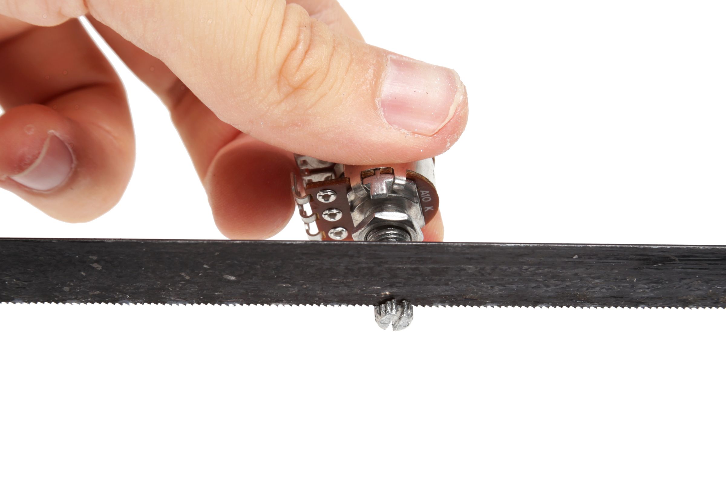

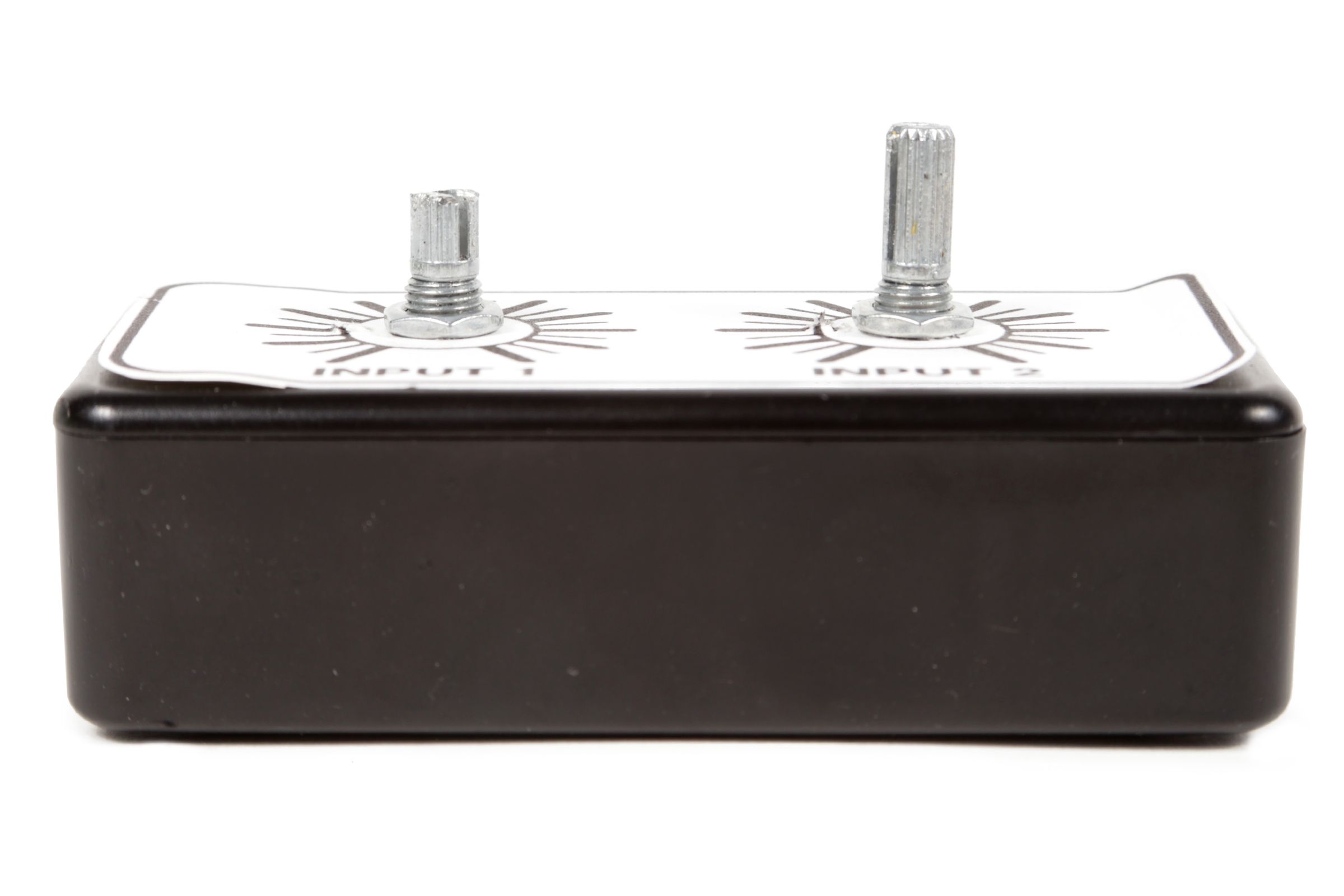

Step 9: Shorten the Shafts (optional)
This part is optional, but recommended if you are overly concerned with aesthetics like I am.
If you mount the potentiometers and place the knobs onto the shafts, you will notice they are riding a bit high. On account of this you can easily see the tab mounting hole and parts of the label which are supposed to be hidden. In order to hide these things, you will need shorten the potentiometer shafts to lower the heights of the knobs.
Doing this is easy. Measure to figure out how much the knob needs to be lowered, and then using a hacksaw, cut that much metal off of the potentiometer shaft.
You will immediately notice an appreciable difference.
Repeat the process for the second knob.

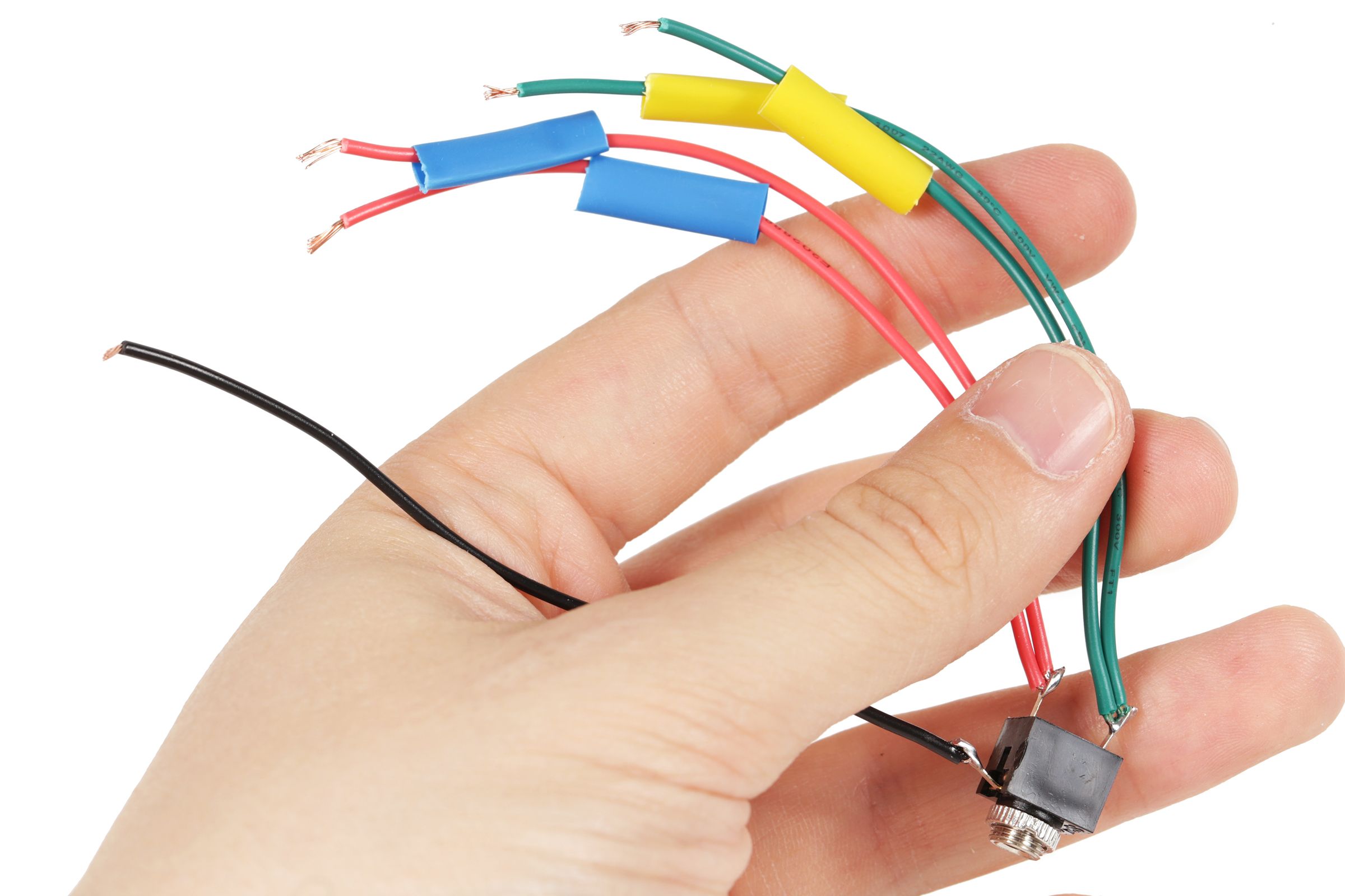

Step 11: Wire the Output Jack
This jack should be wired similarly to the input jacks, but instead of connecting one red and one green wire to each of the terminals, we will be connecting two of each.

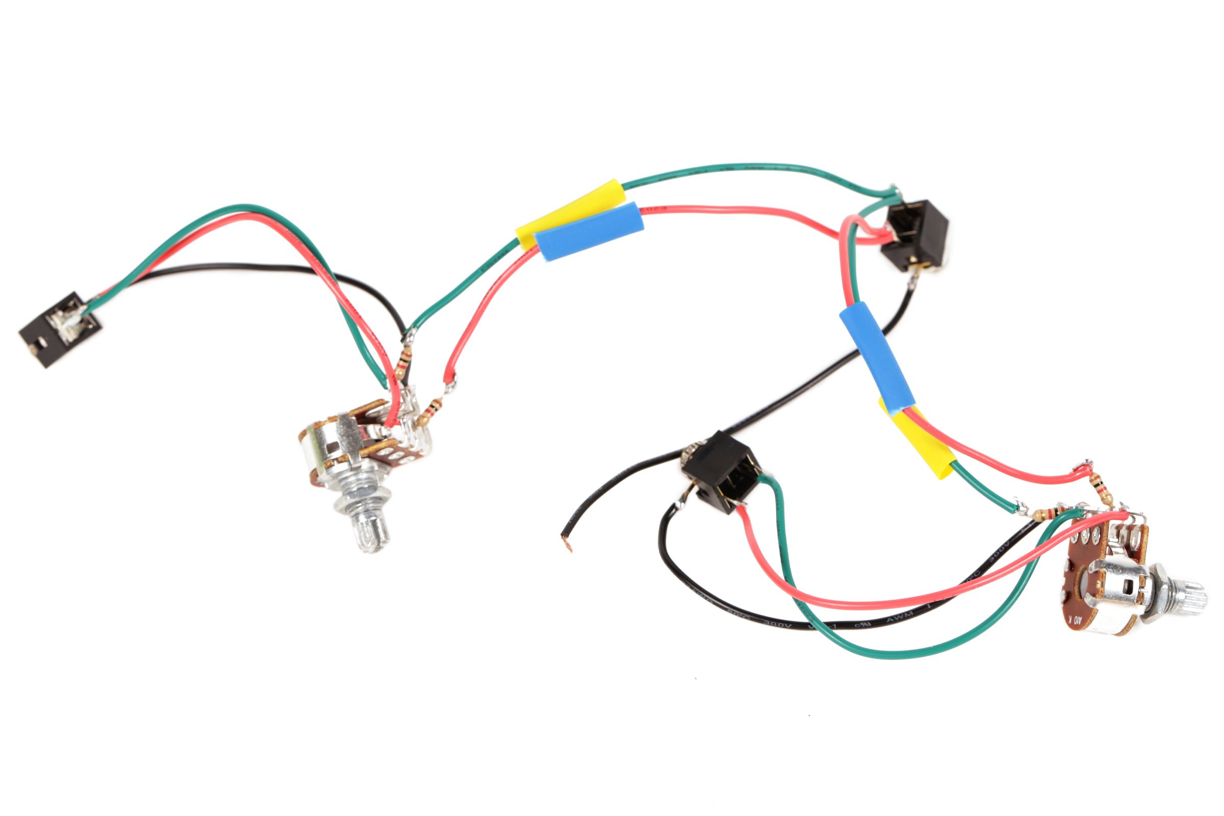

Step 12: Wire the Inputs
Now we will wire each input jack to a potentiometer.
The ground wires should go to the bottom left tab of each respective potentiometer.
The red wire should get connected to the top right tab.
The green wire should get connected to the bottom right tab.

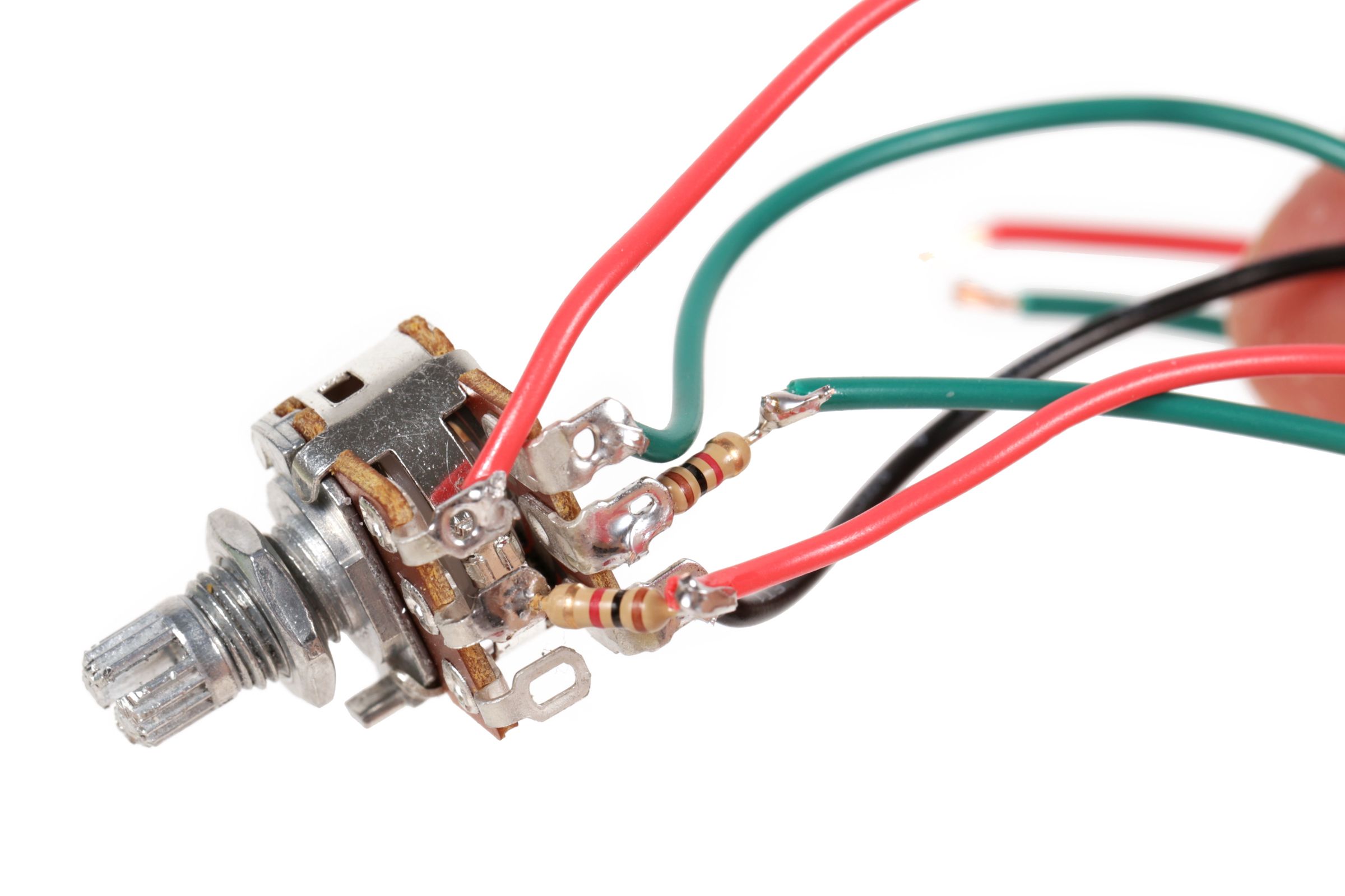

Step 13: Resistors
Solder 1K resistors to each of the center terminals on the potentiometers.
Trim away the excess lead on the side of the resistors soldered to the potentiometer, but leave the other leads connected on the side of the resistors that has yet to be soldered.

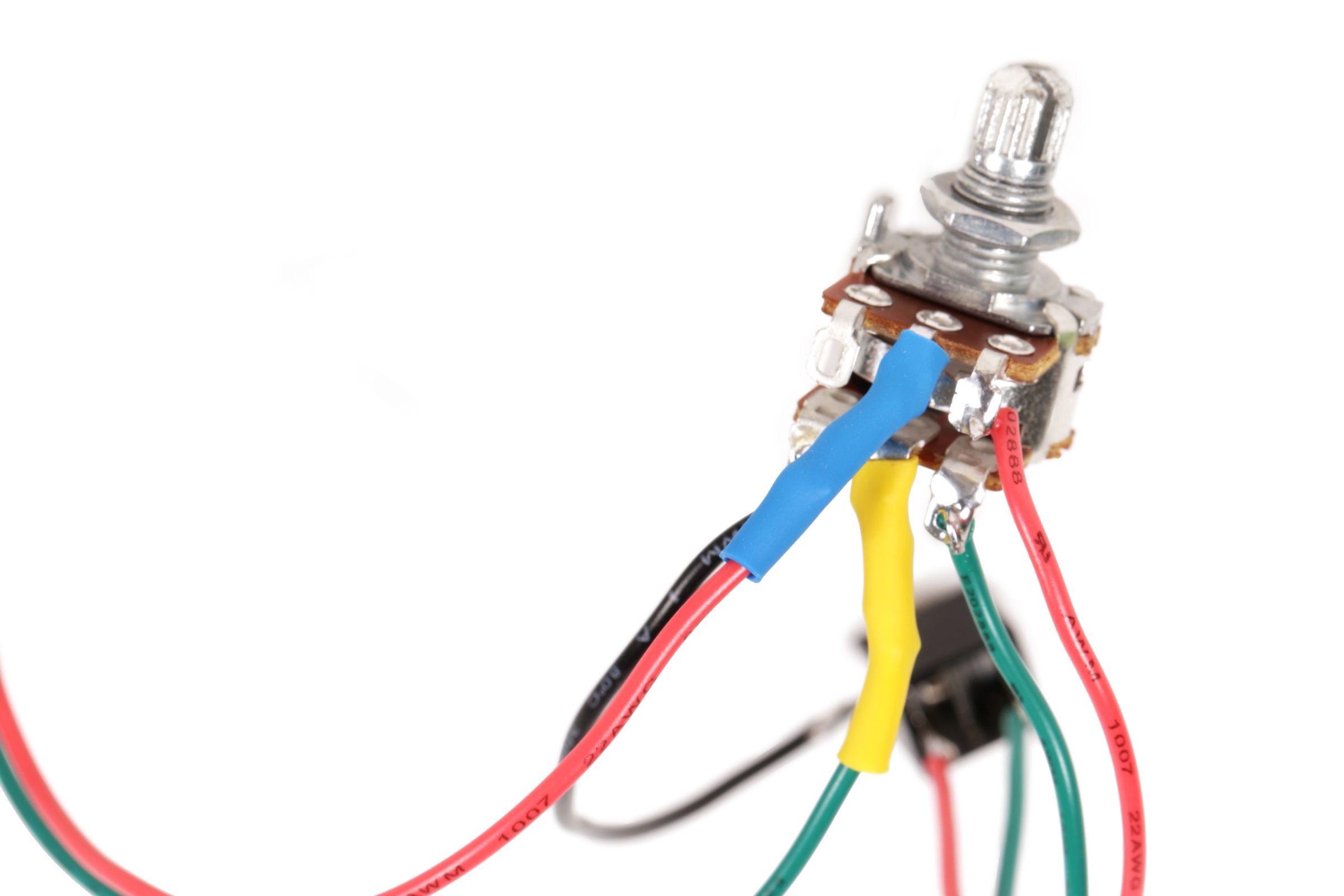

Step 14: Attach the Output Jack Signal Wires
We are going to start attaching the output jack by connecting the red and green signal wires.
Slide 1" of heat shrink tubing onto each of the jack's signal wires. The color is not remarkably important.
Solder a red wire to one of the resistor leads coming from the 1K resistor connected on the top center of the potentiometer. Then, attach the other red wire to the other 1K resistor connected to the top center of the other potentiometer.
Solder the green wires in a similar fashion to the 1K resistors connected to the lower center pins.
When all of the wires are connected to resistors, trim the excess leads and insulate them with shrink tube.
Step 15: Wiring Ground
Connect the ground wire from the jack to any of the pins on the left side of either potentiometer.
Finally, use another black wire to solder together all of the pins (top and bottom) on the left side of both potentiometers. These are all ground pins, and should all be connected with one another and the black output wires on all three jacks. If you miss connecting any of the ground wires together, this likely won't work right.
