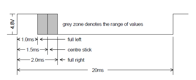

The most common control signal in radio control systems is Pulse Width Modulation or PWM for short. It lets you control things like a servomotor, a motor speed controller or even turning lights on or off in your RC plane, car or drone.
By definition, PWM is a direct current (DC) voltage switched on or off, the on ratio is called a Duty Cycle which is expressed by D = (Ton/Period) * 100 (in percent), a PWM signal is a very efficient way to vary a voltage or power by varying the duty cycle: Vout = (D * Vpwm) / 100.

Step 2: The RC PWM Signal
It is a PWM signal with a duty cycle between 5 and 10%: and with a 5V high signal we should get an average voltage between 0.25V and 0.5V respectively.
