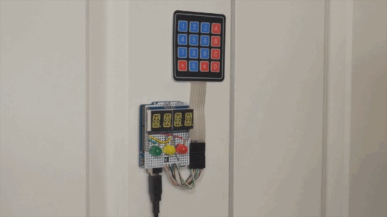

Next, classify the project’s inputs and outputs. A weather monitor might have a temperature and humidity sensor and a display of some kind. Internet projects might have a cloud service as an input, output, or both, like my Internet Valentine project which also has a button input and LED and vibrating motor outputs for each circuit. The project I’m building today is a prop passkey evaluator that uses a membrane keypad input and outputs to an alphanumeric display as well as three indicator LEDs.

Build and run a sample for each component you’re working with. This involves downloading any relevant code libraries, and checking out example code that tests you’ve wired it up correctly. For inputs, you’ll use the serial monitor to get some feedback. In my case that's a membrane keypad using the keypad library.
And then I added an alphanumeric display with an i2c backpack, and three different colored LEDs each with their own resistor. I uploaded the sample code for the display to verify it’s connected properly, then ran a simple blink sketch to test the LEDs. In both case I found wiring errors I needed to fix.

It’s possible one of your sample sketches already does most of your core structure, or to be easily able to find something online that does. It’s likely that somebody’s done something similar to your idea before, even if it uses different hardware. So I looked online, and I found a few membrane keypad door lock projects, all using this password library. So I downloaded the library and checked out the examples that come with it, and I got very lucky! There is a membrane keypad passkey evaluator sample that does exactly what I want. All I have to do is include my desired outputs, so code for the display and LEDs.
