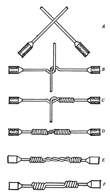

Now that your wires are stripped to basically the same length. you need to cross them in a X form, where the center of the x is about midpoint of the 2 stripped sections of wire
Step 4: Start of the Splice
Whichever wire is on top (closest to you) bend away (or back) and then down, the wire will make a upside down L shape around the back wire
Step 5: Start of the Splice Part Two
Now take the other wire, bend it towards you (or forward) and then down, twisting it around the first wire, making a M shape

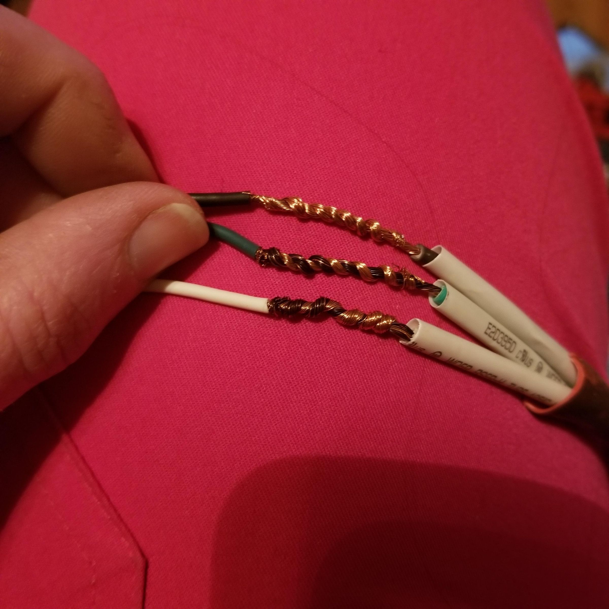

There are two directions to twist, you do not want to twist the entire wire, just the splice.
I recommend using your thumb and forefinger of each hand, 1 will go clockwise (or towards you) the other will go counter clockwise (or away from you), pinching hard, twisting only the spliced section, slowly moving towards the insulation with both hands
if your using solid core wire, or thick gage wire once you get near the ends I strongly recommend you wear gloves or use hemostats / needle nose pliers to finish up the twist
if you got close enough to the same length of stripped wire, and made your X close enough to the center of the 2 wires you should end up with both ends of the wire running out just at, or before the start of the insulation
And a super strong splice ready for service
Step 7: Wrapping Up
Solder the splice, but be warned once its soldered properly its quite a struggle to get it back apart, its actually easier to cut the splice out and start over, so make sure you have your heat shrink and whatever other accessories (ie parts to a fuse holder) in place before

Okay seems my initial response created some issues.
First let me say that before I retired, I was a certified NASA Micro Miniature Solderer, with yearly updates/certifications 'til I was out of the circuit building and repair department years later.
So when I stated the different wire splices, I am going off the proper military and NASA methods. And yes thermal-shunts are used when tinning any wire before any type connection is made. because such a thermal shunt keeps solder, and of course rosin, from wicking up under the insulation.
That keeps the soldered connection from corrosion and down the road and failures. And that can happen with any type flux, be it liquid rosin, or paste or any other type as well.
However, after all the soldering is finished, you still have to use an Acid Brush (that is a type of brush and has no acid on it what so ever) and Alcohol and thoroughly clean any flux residue off the soldered connection regardless what type flux or solder was used.
Then after cleaning, you use heat shrink tubing to insulate the connection again. That is how it is done. Hope that clears things up better.
And for the record osgeld's post is a good one to show some concepts for splicing wires together. And all this may seem anal, as "geopro" so eloquently stated it, but if your life depends on how such things are connected and cleaned when you are in outer space, it doesn't seem anal then.

Western-Union or Lineman splice are all names for this type of splice, though I would call this one the lazy-lineman. A true lineman or WU splice would be done thus:
Make the first 3 twists at a 30-45 degree angle, then make at least 3 very tight twists with each wire on either side.After you solder this splice it should be stronger than the wire itself. You can test it by pulling it apart. If the splice breaks first you did it wrong. In the picture you will find a few variations. This type of splice held together long spans of heavy wire back in the day (or so I'm told).

My father taught me another inline splice in the 60's. He called it a Western Union Splice. He had worked for Western Union while he was in high school. Here is a link to that technique. It handles longitudinal stress well and can also be soldered.
Reply 7 years ago
Here is the lInk:
https://en.wikipedia.org/wiki/Western_Union_splice
Reply 7 years ago
I havent used this Western Union splice. But I shall. next project. Do you usually solder this splice, or just leave it as is?
Thanks
Reply 7 years ago
From the wiki
This type of splice is more suited to solid, rather than stranded conductors, and is fairly difficult to complete.
