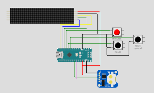

Step 3: Practical Implementation
Step 4: Wiring Diagram and Practical Diagram
Practical connection diagram
