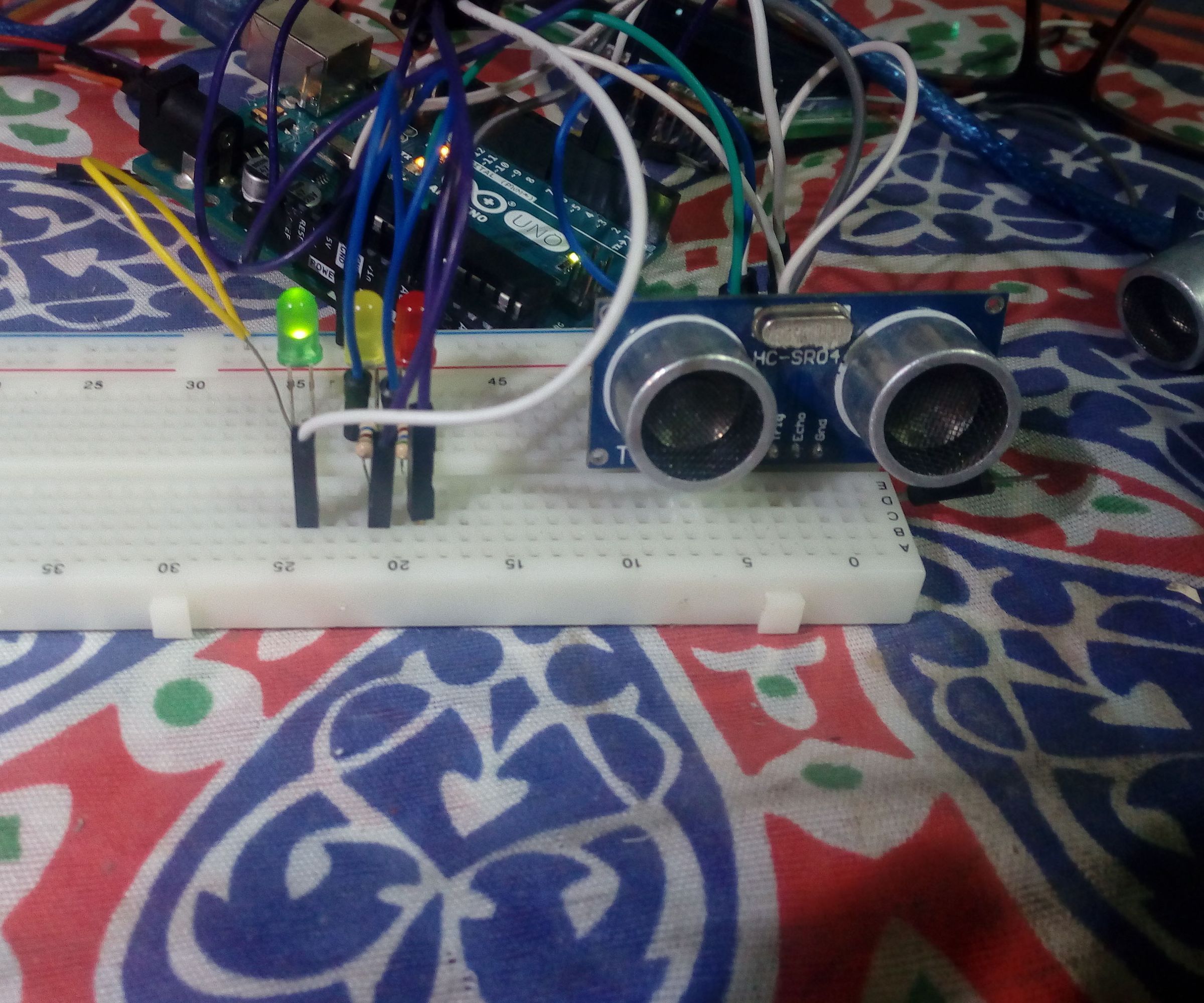

Step 2: First Layer
1- connect the motor ,wheels and the drive to the chasis
2- connect motors to motor drive using wires
3- pins of the drive to pins 3,12,13,5,2,7 in order to arduino
note that :
if the wheel of the right motor for example move in the opposite direction you gave just swap the wires of the motor that connected to the drive
Step 3: Second Layer
- put the arduino , sensors and breadboard layer on the second chasis and lets put some wires
please read the code file to know my connection but let's summarize :
1) VCC and GND of each sonar sensor to breadboard , Trigger and Echo will attached to pins A0,A1,A2,A3,A4,A5 for the 3 sensors
2) 5V and GND from arduino to supply the breadBoard
3) 5v out from drive to arduino input
4) GND from arduino to GND the drive
Step 4: Power It Up
place your battery holder with your batteries in and take the red wire connect it to the input pin to the drive and the black wire to the GND of the drive with the wire of the arduino
