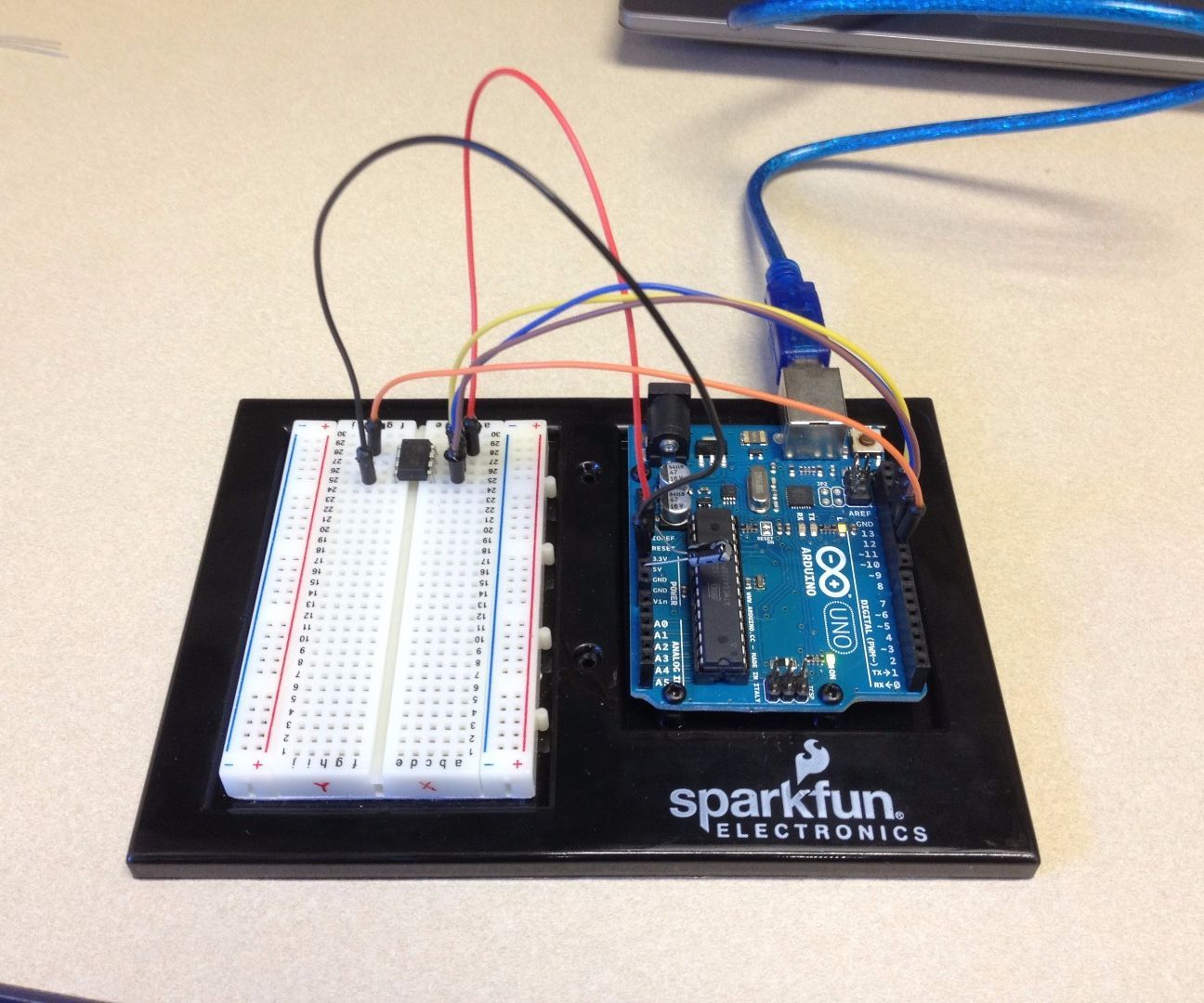

Step 2: How Is Capacitance Measured?
An RC (Resistor-Capacitor) circuit has a property known as a "RC Time Constant" or T (Tau). The equation for which is given below:
T = RC
Tau can be simplified from a more complicated equation (shown in images above) to represent the time it takes a capacitor to be charged, through a resistor, to reach 63.2% of its total voltage. This can also be measured by the time it takes the capacitor to reach 36.8% of its total voltage upon discharging.
The Arduino will be programmed to time how long it takes for a capacitor to reach 63.2% of its total charge. It will then use the equation for Tau to calculate the capacitance since the value of the resistor is already known.

Step 4: Wiring
The wiring for this project is pretty straight forward. Just follow the diagrams provided.
NOTE: Make sure the silver stripe on the capacitor (if using a bipolar capacitor) is connected to Ground.
NOTE 2: The 220 Ω resistor and the wire connected to pin 11 are not necessary, but recommended as it speeds up the discharging time.

After the code is done uploading, open the Serial Monitor (Tools > Serial Monitor) to view the measurement of the unknown capacitor.
The first value is how long it took the capacitor to reach 63.2% of it's total charge. The second value is the calculated capacitance in either "nano" or "micro" farads.
The program will repeatedly test the capacitor and values may vary slightly. It is best to take the average of these values.
NOTE: This sensor is most accurate for capacitance values between 1 μF to 3500 μF.
