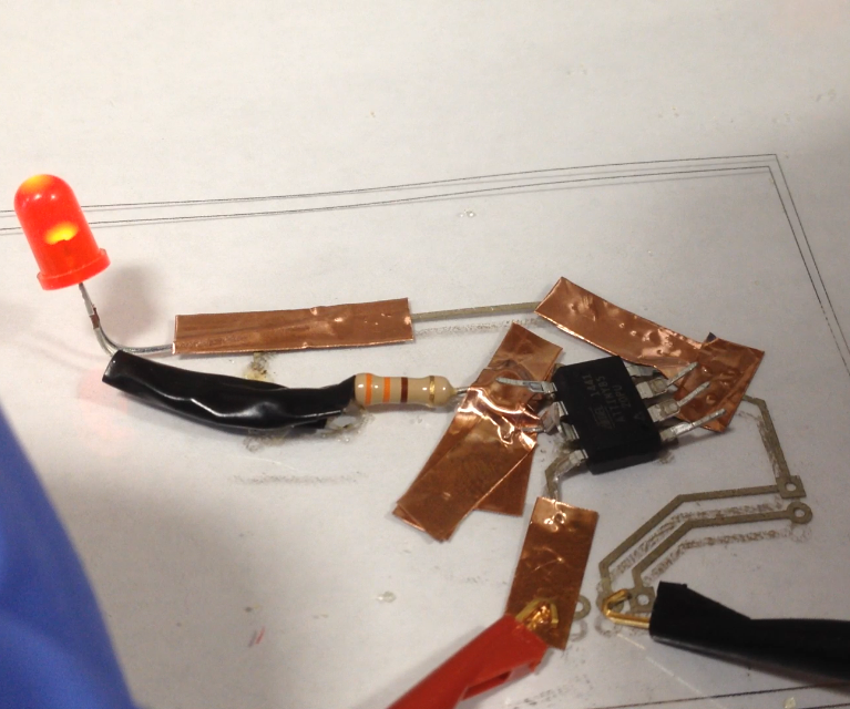

Step 8: Test ATtiny
To test the ATtiny, attach your resistor and LED in series to the pin you specified in your program. In this case it was digital pin 0 and physical pin 5. Make sure to ground both the ATtiny and your LED. In this case I used the Arduino for both Ground and 5V out of convenience. Once you connect the 5V from the Arduino to the microcontroller it should start blinking (You could also attach this microcontroller to another power supply and add a 5V regulator).
How do you know what resistor you need? Well it is a safe bet that most LEDs will function with a resistor between 220 and 330 ohms (with a higher resistance providing a dimmer light). If you wish to calculate the resistor yourself you would need to use the equation V = IR where V is the difference in voltage between what is supplied and what is used, I is the current drawn by the LED, and R is the resistance of the resistor you would need to make a safe circuit. An example calculation is shown below where 5 volts is provided by the Arduino, 3 V is used by the LED, and 12 mA are drawn by the LED:
V = IR
R = V/I
R = (5 - 3) / (12 / 1000)
R = 166.7 Ohms
It is safe of course to use a resistor that is higher than what was calculated. The value that is calculated is the minimum that is necessary.
