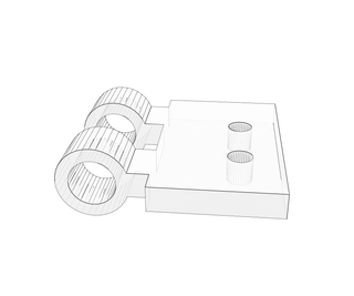

Step 2: Mechanical Design
Below are the STL files ready to be 3D printed
You could 3D print the brackets, but they need to be edited so they are not as brittle.
I would recommend buying the brackets from amazon.

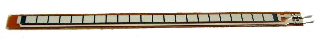

The signal wire for the touch pad goes into one of the digital pins, while the flex sensors are placed into the analog pins [ but not before a resistor is placed in series -- see the spark fun link for more clarity ].

  • [Line 162] : the range for each flex sensor is different, so change the first two numbers to get a better resolution. Also, the servos are contrained from 70 to 110 degrees because of clearance issues and a smoother operation.
