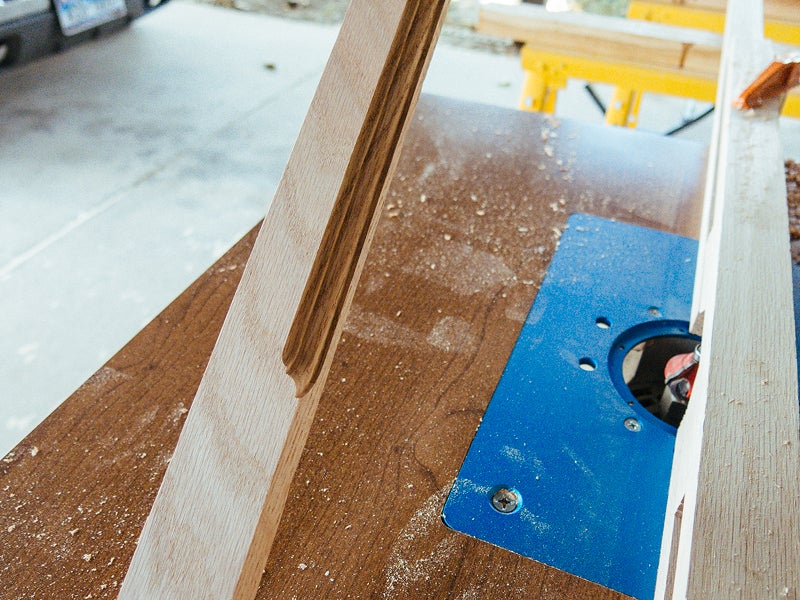

I knew what kind of trim I wanted, but couldn't find it anywhere, so I used my homemade router table to shape my own. Here I also used red oak.
Here's the bit I used. http://www.homedepot.com/p/Diablo-1-1-2-in-Classic...
I applied the trim on the top and bottom. It really finishes the cabinet. I wasn't totally happy with how the feet were so tucked in, so I worked out a way for the feet to come out to the corners a bit further for proportion's sake.
