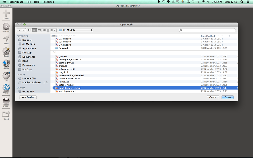

  3. Browse to a model and click "Open"
    Note:
    Meshmixer can import only one file at a time

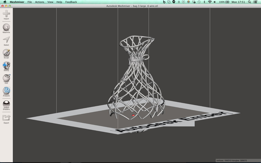

    1. The model will open in the Meshmixer viewer

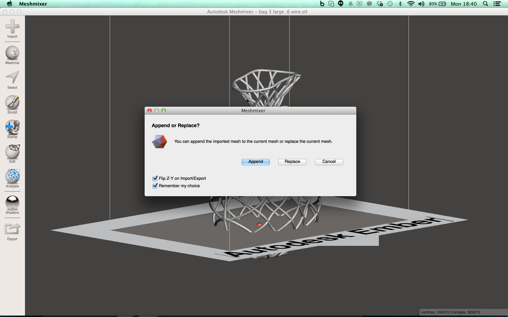

    To import another model
    1. Select "File" from the menu bar and click "Import"
    2. Browse to a model and click "Open"
    3. A pop up will open, check the boxes "Flip Z-Y on Import/Export" and "Remember my choice" then click "Append"
      Tip:
      If you want to replace the current model rather than add another, simply click "Replace" instead of "Append"

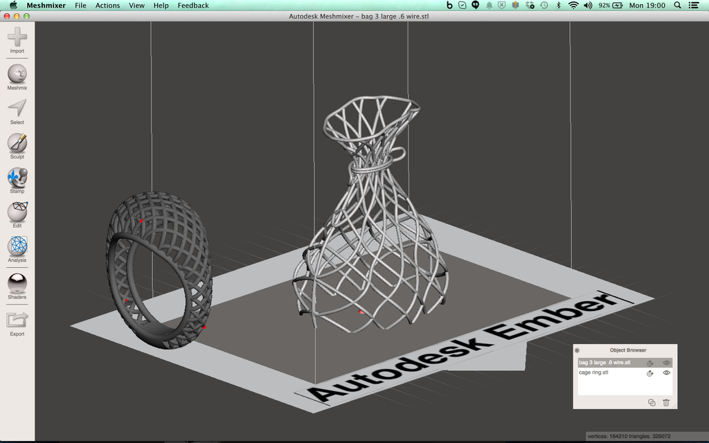

    4. Then second model will be opened in the Meshmixer viewer, along with the first model
      Step 3: Selecting an Object
      To select a model you can either
      1. Click on it
      2. Or click the model name in the "Object Browser"
      Tip:
      If you can't see the "Object Browser"
      1. Click on the "View" menu in on the top toolbar
      2. Click "Show Objects Browser"
        When a model is selected it is highlighted light grey in the 3D viewer and and dark grey in the "Objects Browser".
