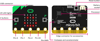

All that's needed for this is a Micro:Bit and something to code with it on! This can be either a laptop, or something that can utilise Microsoft Makecode's website.
