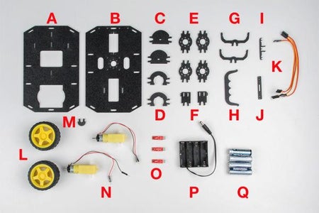

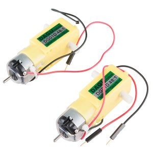

The yellow looking object is a Motor, A Motors take electrical energy and turn it into mechanical energy through putting a current through a coil of wire that creates a magnetic field. This then interacts with magnets in the motor, causing a push / pull effect. If you do that in a proper spacing and timing, then you can spin a shaft.

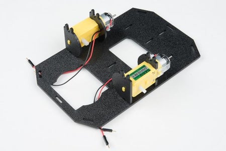

You put them on the Bottom Chassis plate (A) and use a Front Motor Mount (C) And a Rear Motor Mount (D), then install wheels/ tires.

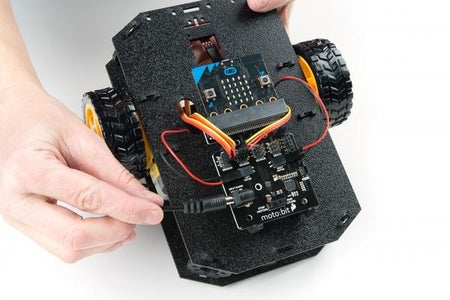

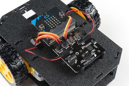

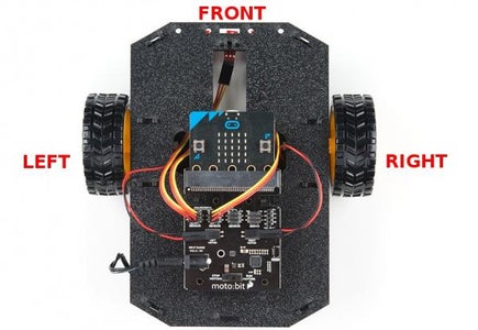

Step 1: Robot Looks Like
You should have a robot that looks like those picture on top after putting all the parts together.

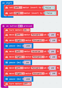

Step 2: Coding

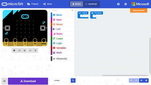

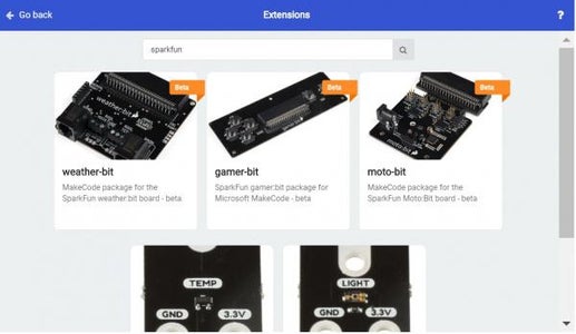

Go to Micro:bit and name it Driving And Turning then click on Extensions and on the search place search sparkfun or moto:bit and click moto bit and copy the code.

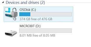

Step 3: Uploading
Download the code and then go to your files, if your Micro:bit is not connected to the app and then drag it to your Micro:bit file

After downloading make sure the motors switch is changed from "STOP MOTORS" to "RUN MOTORS." Press the A button on your Micro:bit and your robot will drive forward for 1 second, pivot, and the drive forward for another second before stopping. Pressing the button again will have the robot repeat the sequence.
