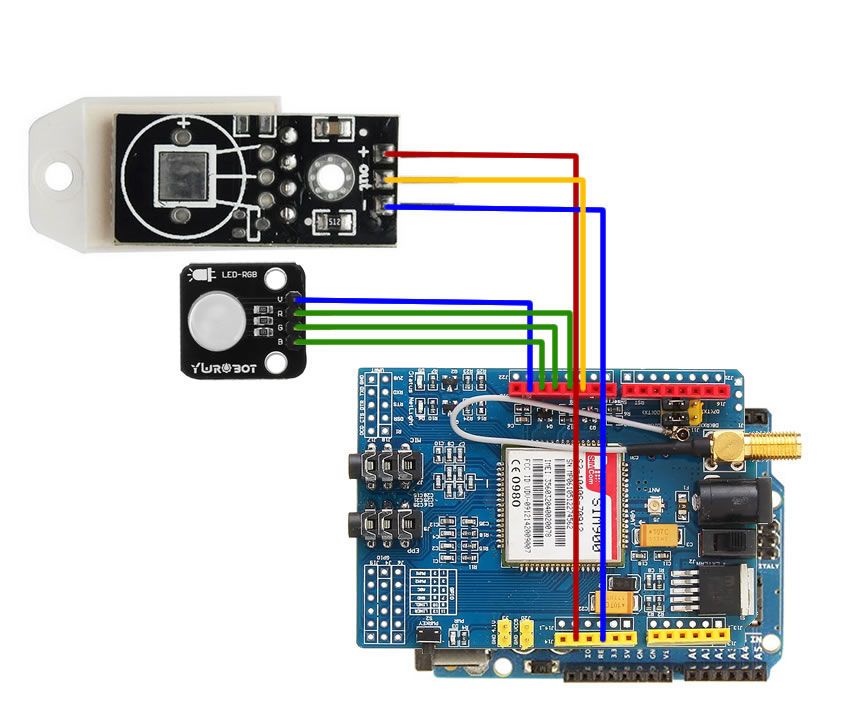

Step 2: Hardware Connection
Connect 2x DS18B20 Out to WeMos D1 in
DS18B20 using onewire and can be connected to same pin, but ti simplify connection without soldering, we will connect separately.
Diagram example on image 1
Have in mind that DIgital inputs/outputs on WeMos D1 mini is not same as
in code, here is example transition, this is why in code we using pins 4 and 5, but on boards is written as D1, D2 as on imag 2

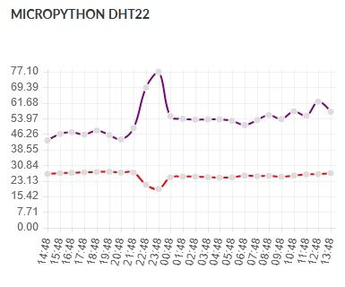

Step 4: Check Your Data on Desktop or Mobile
After that your device will start sending data to loggingforest and you can see it there
Image 1: In loggingforest device edit just define parameters name and values
Image 2:
Click on preview
Image 3:
And you will see nice data, temperature inside cooling room and outside temperature
