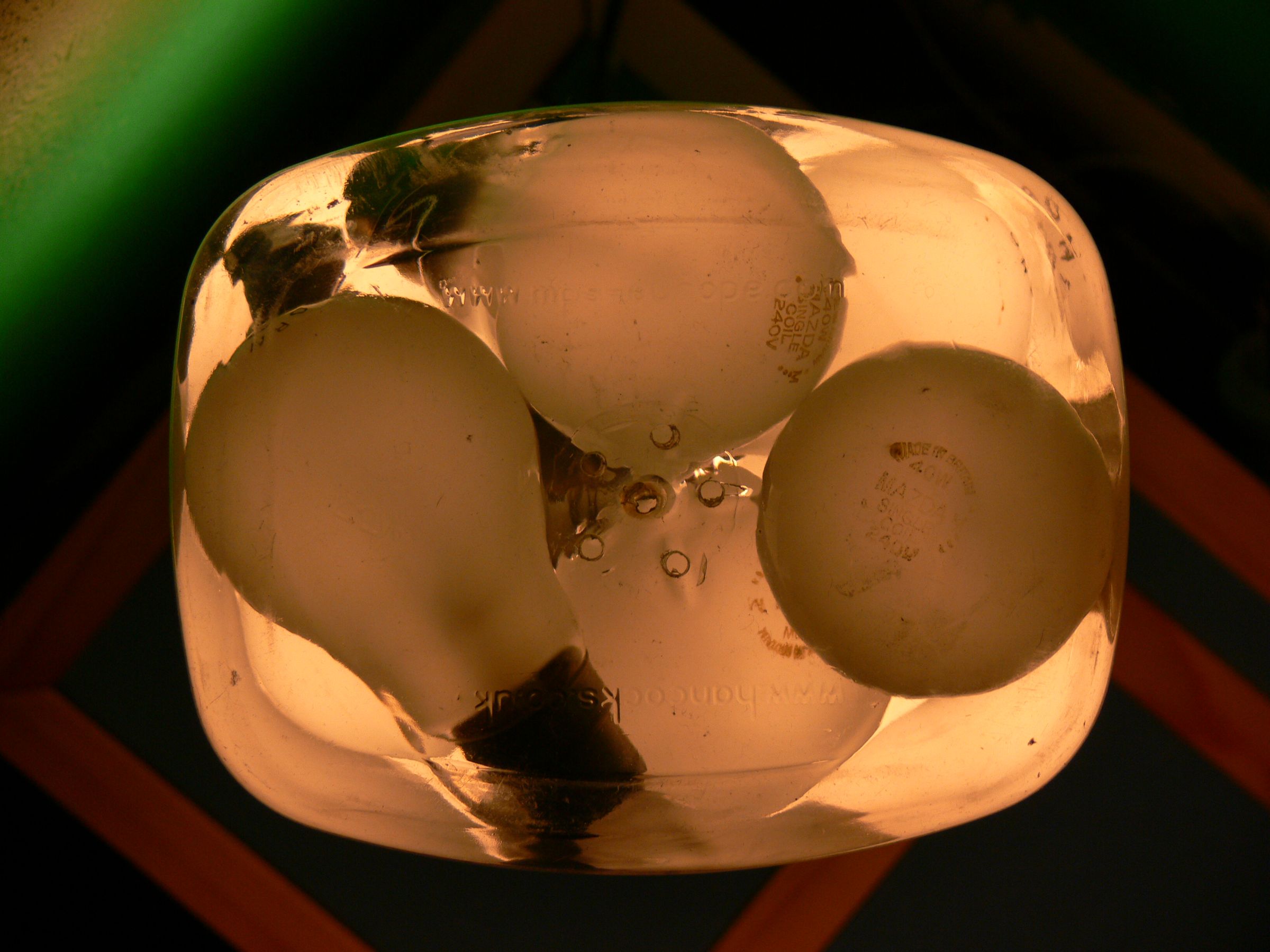

Step 2: Cut and Drill Perspex
First of all, we're going to cut some perspex discs to go inside the caps on the milk bottles, then drill holes through which we can mount the LEDs and cable.
When using the hole cutter, drill into a piece of wood. Pressing your material against something like this while you cut will help to keep the back edge neat. Softwood also lets you know when you've gone all the way through, as you can really feel the way the drill bites changing as it reaches the wood.
Once your discs are ready, make hole in all your milk bottle tops to match the centre holes in the perspex.
You also need to drill holes ready for the wiring and LEDs. What exactly you do here depends on what kind of power supply you'll be using and what kind of circuits you want to connect to it. Mine use three LEDs per light, which I arranged evenly around the disc.
You need a pair of holes to pass the legs of each LED through, and two holes big enough to pass the two strands of your cable through. (See the picture for explanatory notes).
I didn't use a template or anything for this, I just did it by eye with a battery drill, some small bits, and patience. Occasionally, two holes would be a little bit too far apart or close together for the LED legs, but as long as you're careful, a little bit of bending will allow them to fit. If this doesn't make sense yet, don't worry, the next step should make it clear.

Step 12: Sequenced Light
Finished! More photos and video to come, and the code is attached below.
The wiring, it turned out, was too big to all go back in the pipe, which is unfortunate. It means the LM317 and the arduino both stick out of the top of the pipe because it's so packed with wires and components. Squashing them in any further started to make it behave erratically, so I'm going to leave them outside. Since it will hang from the ceiling, I doubt they'll be particularly noticeable. However, I would have liked to have come up with a solution that stayed good looking while accommodating all of the circuitry.
Never mind though, it works how I want it to. The simple analogue control feels pleasingly human.
Notice in the code that the numbers at which things get turned on and off don't have uniform differences? That's because the pot I used turned out to be Log rather than Linear, so distributing the thresholds evenly resulted in all the activity being squashed up in one end of the pot's travel.
