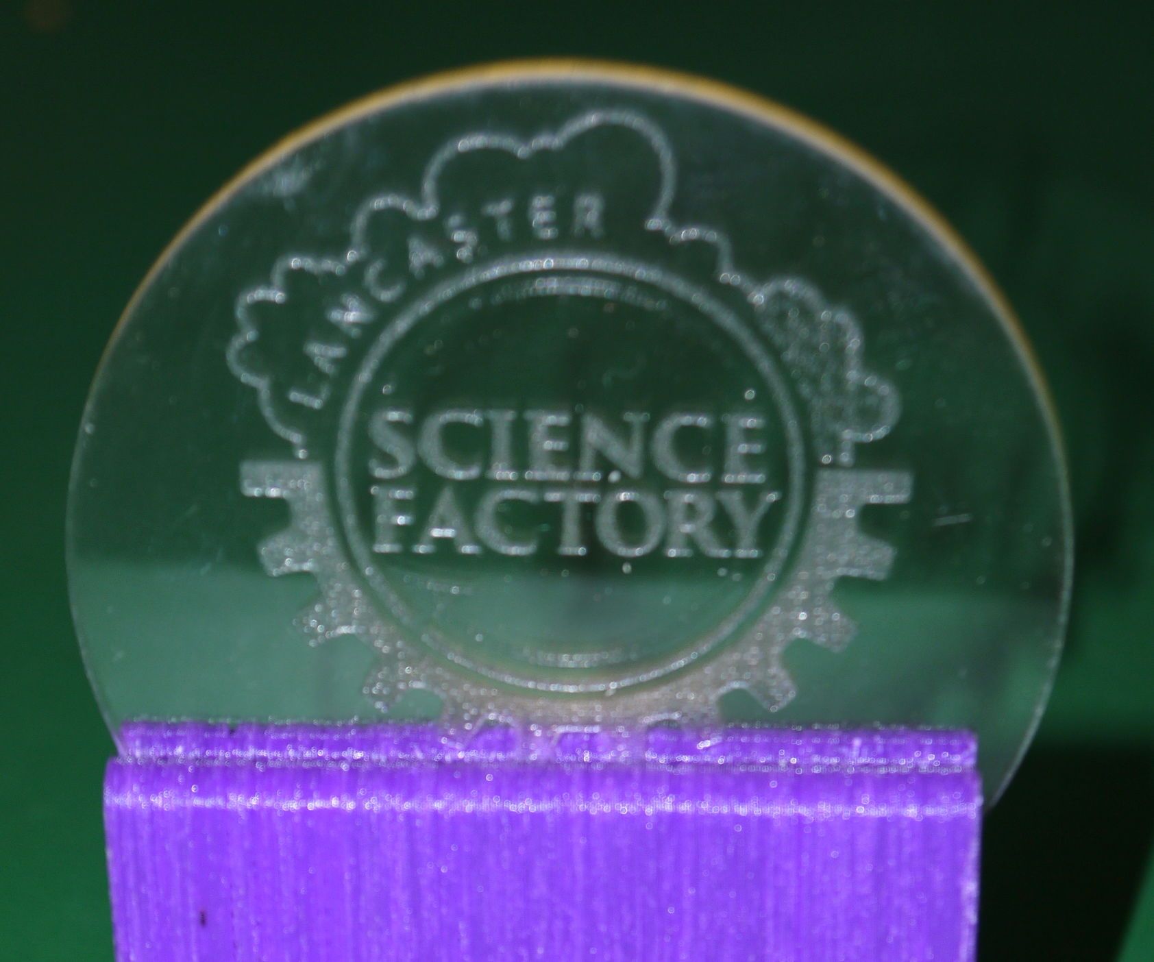

Step 2: Laser Your Panel
Using the included file, cut your acylic panel.
Add engraving to the panel.
Some tips:
- Use Illustrator or Inkscape to add a logo or design to the panel.
- If your laser can do it, engrave first and then cut the outline without moving the panel. That will keep everything lined up the way you intended. Cut on the green line.
- At our maker space, the Full Spectrum Laser will engrave then cut.
- Our settings:
- 10% power/100% speed for engraving
- 75% power/30% speed for cutting. You may need a second pass to cut 1/4" acylic.
- Our settings:
- You may be able to cut and engrave on your Carvey. Keep the engraving shallow, so that the acrylic does not break from internal stresses.
