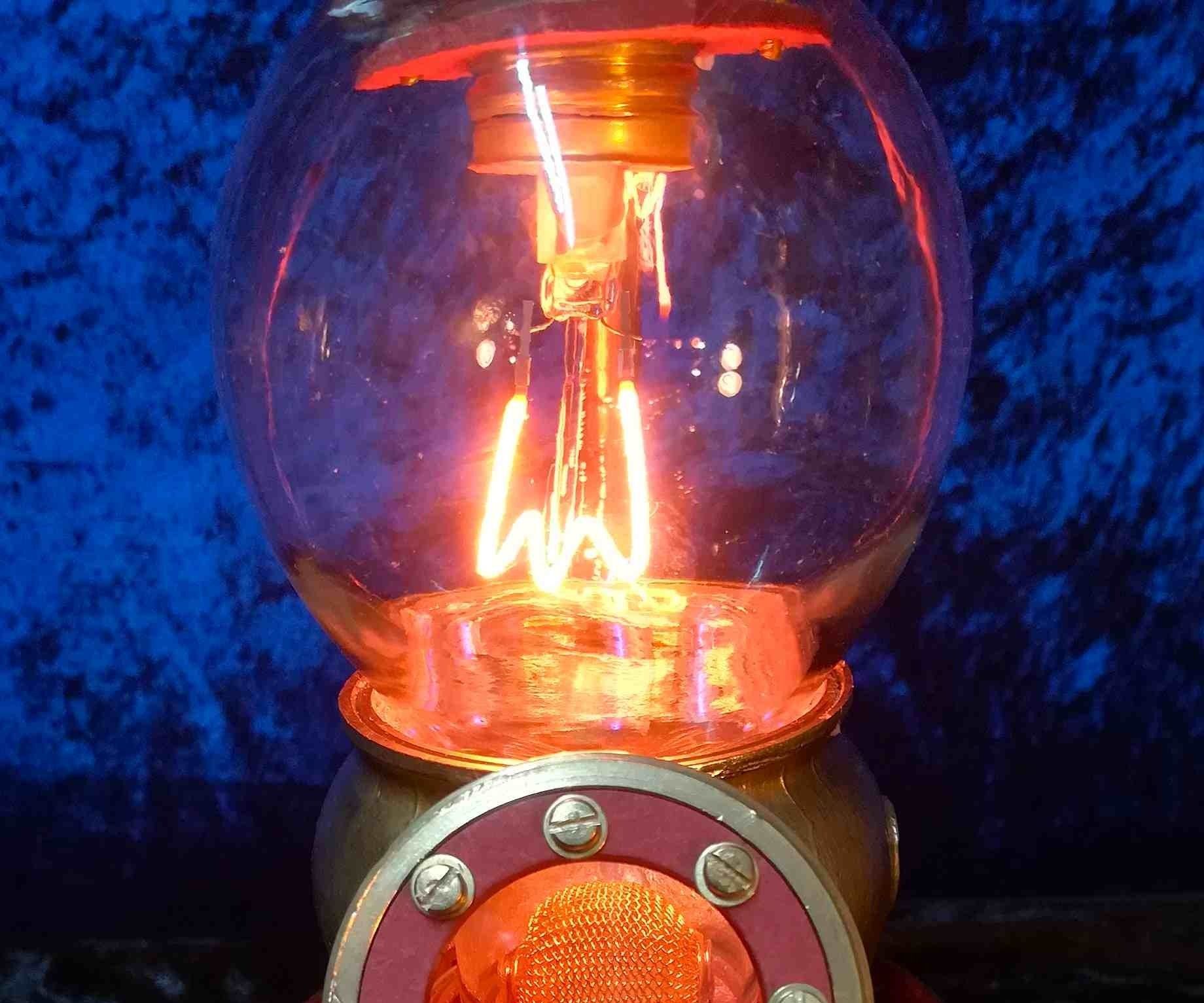

First I took a broken 1.000 watts light bulb to get the edison socket E40 .
Then I took a broken "modern" LED light bulb to get the acrylic glass dome which fits perfectly in direct way into the Edison "Goliath"-socket. Obviously nothing in the measures of lightbulbs has changed through the centuries;-))
Third I took an old original lantern socket from 1921 to get the Goliath socket holder. It has been in a really bad condition and it needed a lot of work and time to reactivate it.
At last I took a ligtht bulb with curved LED filament in which only one caoacitor had collapsed but the filament was still running.
As you know from a lot of other projects I´ve already presented here you can drive such LED filament bulbs with a flash unit of a disposal camera. Now nearly all parts needed had been come together. Only a small slice of plastic was missing for holding the filament tube and for insulating reasons. This small slice I took from an old bathtub armature from the plumbers scrapyard. As you see this is a 100 % recycling project too.

The flash unit transforms the 1.5 volts DC from the battery to more than 330 volts AC. If you combine it with a resistor and the filament LED this filament will shine very bright.
The most important thing is that you have to try out by testing which amount of resistor will be necessary to let the LED shine bright and not break down. This resistor is always needed to prevent a short cut. In this project I used a 46 k ohms resistor and if you look at he explaining pictures you will find out that I used ther another resistor with 210 k ohms for this reason.
As you can see at the pictures too you can cut the pcb smaller wtith a side cutting pliers as shown so it then will fit in the Goliath socket. Take care that the small pcb doesn´t get in electrical contact with the brass made socket to avoid an electrical shock of high voltage. In this case only this small plastic slice which holds the filament was needed. And of course you should use shrinking hoses to insulte the wires of the filament after soldering to the wires from the pcb.
Step 4: Assembling the Big Goliath Bulb
After preparing the pcb just solder it with the resistor and the wires of the LED filament and then you can test it. Now you solder the wires for the power supply with 1.5 volts DC to the Bulb socket. Minus (ground) comes to the threaded casing and plus goes to the bulb base. Then place the electronic and filament insde the socket and fix the acrylic class dome with epoxy resin. And that´s it.
