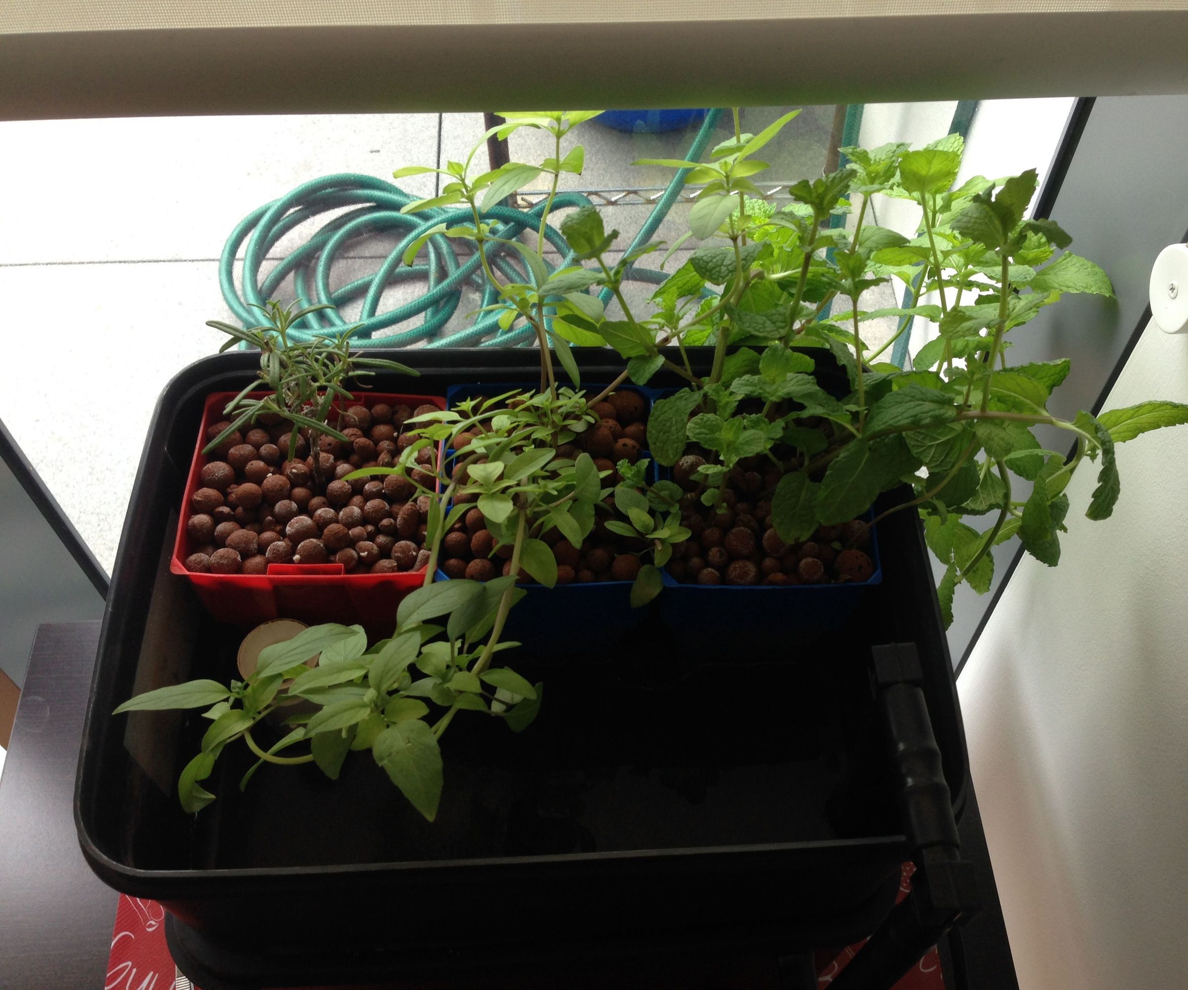

Step 8: Assembling
Fill with diluted hydroponics nutrient solution, add some hydroponic media, transplant some herbs, and there you have it: Your very own hydroponics ebb-and-flow herb garden.
P.S. It's still to early to know if the plants will survive, much less thrive. I hope they do, and that I can look forward to an endless supply of fresh herbs.
