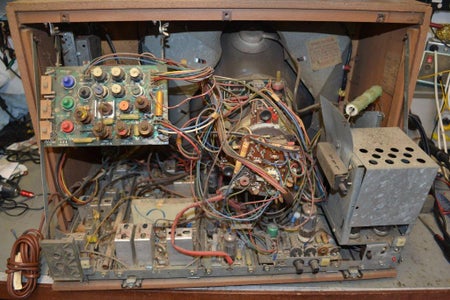

Step 19: Imitate Clumsy Wires Inside
This project not only imitate a retro TV outside, it is also imitate the clumsy wires inside :P
Ref.:
https://www.radios-tv.co.uk/wp-content/uploads/wpforo/attachments/93/132040=25907-chassis1.jpg
