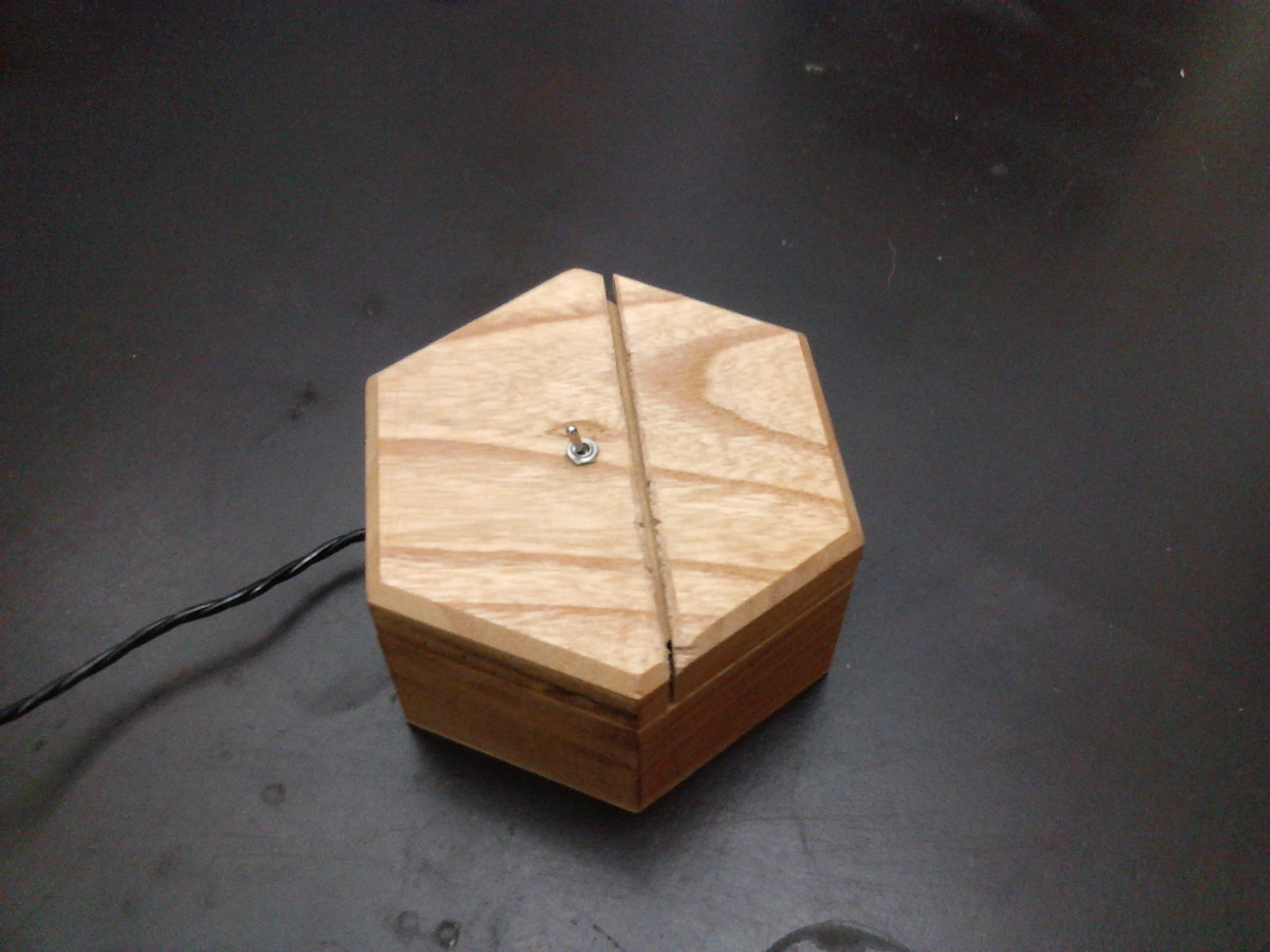

Hello, I show how I made a mini circular saw dc motor advantage he had fitted with a drill chuck (used in the proposed mini drill press), I have done everything trying to go modular, ie the engine to use both for drilling and for the saw.
The mini table saw is simple, all a bit interesting is that I placed the lid hinges to work more comfortably, since the idea is that the mini saw mini drill and share the engine.
The motor is attached by nuts that allow varying the height of the saw cut.
The diameter of the saw blade is 8cm and table dimensions are approximately 28x20 cm.
Thanks for your attention, greetings.

    I agree this saw is a little lacking in the safety department.
    OP: while this saw lacks a bit in size and power, there's still a fair bit of stored energy there. Consider the drill chuck's mass is adding to the flywheel effect. So please make sure you bolt/clamp the thing down before you use it. And be careful of your hand placement. If you have your fingers on the stock behind the blade, a kickback will draw your fingers into the blade.
    The table saw is a tool to be seriously respected. The lack of a riving knife is forgivable, given the size of this tool. But the lack of a blade guard, miter slot, fence, and adjustable blade height on this saw really limit the ways you can safely use it. You can't use a sled without a miter slot. And you can't use feather sticks nor a push stick when you don't have a fence.
    Consider the cost of one severed tendon repair could easily exceed the sum cost of every tool in Marc Spagnuolo's workshop.

    Hello,
    You're right, it can be dangerous to work with, but I'm trying to improve in this area.
    I have thought about doing an internal structure that covers the circular saw, I'm on it.
    Thank you for your wake-up call.

    Is there any vibration issue??
    0
    ric12335
    ric12335
    Reply 5 years ago
    Yes there is vibration problem, I use sergeants to secure a table.
