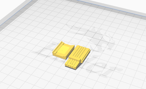

Step 1: Design
I designed the connector in Fusion 360, using the measurements found in the USB 2 Series "A" specifications. The specifications can be found here:
https://www.usb.org/document-library/usb-20-specification
I added small holes to the front of the plug, so that the bare wires could slip into the holes and would not bend upwards when the plug was inserted into a USB port. I also added teeth to the top of the connector, so that it would hold the wires firmly in place once it was attached.
Step 2: Print
After designing the connector, I printed it in the orientation shown above with supports and full infill. Note that you will need to print both STL files: one is the top and one is the bottom. I used Inland Silver PLA at a temperature of 205 C, but obviously the settings will vary greatly depending on filament and printer.
After the print was completed, I gently removed the brim and sanded away any rough edges. My printer is calibrated well enough that the USB plug fit snugly into a USB port. If it does not, however, gently and symmetrically sand away at the edges of the plug until it does.
