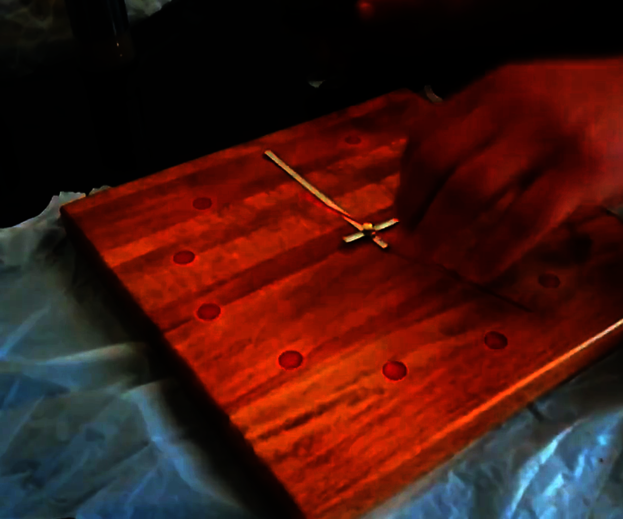

In this project, I am making a watch from reclined wood.
There are no design elements on the face of the clock. Only holes instead of numerals. The main character is a combination of soft yellow wood with highlighted grains and dark wood with almost invisible grains. Therefore I finished it with oil to shows off the grain and true beauty of the wood better.

Step 3: Clock Face
Drilled hole in the center which will become a clock shaft hole at the end.
Then printed clock face on A4 paper and transformed hour positions on wood. Used simple router jig to make holes for clock positions.
Step 4: Hole for Clock Movement
Used router jig to drill a hole for clock movement.
The jig is rectangle cut into chipboard pice. The size is chosen in a way that if my router slides over the egdes it makes 5.5sm x 5.5sm hole which is a perfect size for the movement I use.

Step 6: Result
Applied walnut oil and installed clock movement and hands.
