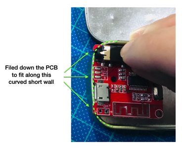

Fitting everything into a tiny enclosure like the Altoids Smalls tin is a bit like Tetris. I will be describing specifically what I did for the tin, but feel free to adapt according to whatever case you use!
I decided I wanted the USB and Audio Jack to come out of the short side of the tin, kind of like an old school walkman or iPod Shuffle (remember those??). This added a few extra steps, but not bad. You could also use the longer side of the tin as well. Either way, once you decide where to place the audio encoder, everything else seems to fall into place.
- Audio Encoder
- Filing Away the Edges - As you can see in the first image, with placing the decoder along the short wall, you will need to file down the corners and front edge of the board for it to fit snugly.
- Be extra careful not to overshoot and file off the connectors! I ended up having to get extremely close though.
- When done, you can go ahead and solder the wires
- I lined the bottom of the tin with electrical tape, as a precaution to insulate the tin from the circuit.
- Place the decoder in position, and mark the locations of the audio jack and USB port with a thin permanent marker, inside the tin

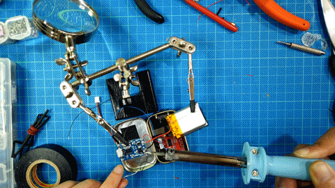

What's under the hood, you ask? The battery and charging module!
- TP4056 Charging Module
- You can go ahead and wire this puppy up to the decoder and switch (turned OFF) if you haven't already
- I used helping hands to hold it while I soldered
- Battery
- Cut the wires to ~3-4cm long.
- Solder the positive (red) and negative (black) wires to the corresponding terminals on the charger
- Double check you solder to the correct terminals! Otherwise you risk frying the thing.
- Mounting
- Using double-sided mounting tape for:
- Attaching the charger to the battery (centered)
- Attaching the battery to the lid (centered)
- Make sure there is enough of a margin around the battery for the lid to close
- Detailing (Optional)
- Again, probably a good idea to seal the soldered joints on the charging module with a small dab of hot glue.
- I was lazy and just folded a piece of electrical tape upon itself (sticky side in), laid it over the charger like a mini blanket, and then used another piece of tape to strap it into the lid.
- This method is not recommended as it also covers the LED indicator lights, and will certainly raise eyebrows with TSA if they were to ever come across it... (see image) 🧐
- Turn it ON
- If it lights up, you are GOLDEN.
- Pair the Minty Tunes to your device
- Get out of here and play some music!!
