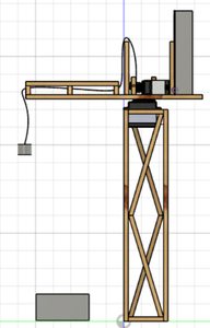

Step 1: Cutting Wood Into Segments
The first step for this project is to cut the wood into the lengths that are required for the project.
  • Base Truss Construction
  • 4 pieces at 12"
  • 8 pieces at 2"
  • 4 pieces at 12.125"
  • Mast Construction
  • 2 pieces at 10"
  • 8 pieces at 1"
  • 2 pieces at 5.25"
  • 6 pieces at 0.75"
  • 4 pieces at 4.5"

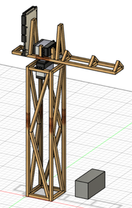

Step 2: Constructing the Base
First hot glue one of the 2" pieces to the bottom of one of the 12" pieces. Then add another 12" piece to the other side of the 2" piece. Finally complete the box by adding the final 2" segment on the opposite end of the 12" pieces. Complete this step one more time in order to have both sides of the truss. Next, add two of the 12.125" pieces diagonally into the boxes to create the truss elements. The next step is to glue the remaining 4 pieces that were cut at 2" vertically onto the corners of one of the truss elements. Once the hot glue has dried the final step in constructing the base is to add the other truss element on top of the 2" pieces. After the glue has hardened the final base truss can be stood up and is completed.
Step 3: Constructing the Mast
The first step in assembling the mast is to lay out the bottom layer. The two 10" pieces are layed parallel with 5 of the 1" pieces as cross bars spaced evenly throughout. Then add the 1" pieces as supporting uprights for the spool and servo.
Step 4: Adding Triangular Support Trusses
Once the mast has been hot glued together and dried the next step is to add the triangles that create the upper frame. These are created using the 0.75" pieces at an angle and topped with the 5.25" pieces. After these have been secured down to the frame then the large upper support triangles can be added. These are created by similarly gluing them together at an angle and gluing them down to the base.
Step 5: Adding the Spool, Cabling, and Electromagnet
Now that both of the assemblies have been created next step is to add the spooling axle and whatever gear train is necessary for connecting the axle to the servo. Once this piece has been added then the cable can be threaded through the crane and spooled back onto the spindle. At the end of the cabling the electromagnet can be secured.
Step 6: Adding the Servos
Each servo is supported by at least one 1" piece which can be fixed to the servo and then glued down once the servo is in position. The first servo is placed inside the top square of the base truss. This servo will be used in order to rotate the mast left and right. The second servo is the Mast servo. Once the servo has been secured to the support post it can be glued into position to properly mesh with the spool.

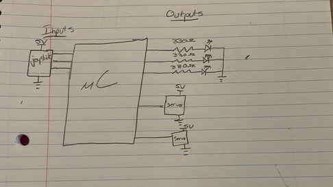

Step 7: Designing the Wiring
The wiring diagram consists of the Arduino Atmega2560 as the micro-controller. Inputs are to the left that sends the commands to the controller. The outputs are to the right. These are the tangible visual displays of the signals being sent out of the micro-controller.
Step 8: Implementing the Wiring
Now it's time to implement our wiring onto a breadboard. Bus the 5V and Ground connections to the breadboard. Now connect the LED signals to the 330 ohm resistor that is in series with the cathode of its respective LED. Now connect the anodes of all the LEDs to ground. This completes the LED circuit. Now connect the servo motor signal to the signal input of the servo. Connect the servo to 5V and Ground from the Arduino. Now to wire our inputs. Connect the joystick to the 5V and Ground bus. Next make a connection from x,y, and button inputs into its respective input on the arduino.The wiring is now complete.
