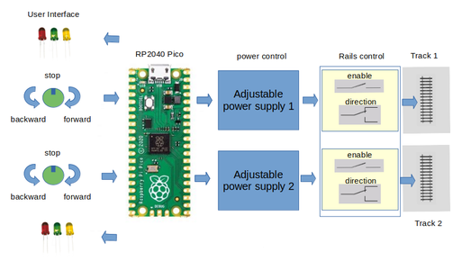

Step 1: Train Controller Design
With above requirements the technical design was sketched quickly. I need a user interface with two big knobs, few LEDs to show status, two digitally controlled power supplies and a track controller to switch on/off power, change direction and detect an overload condition - all controlled by a Raspberry Pi RP2040 Pico and micropython.
To get an idea of the power requirements I did some measurements with an adjustable power supply. The N-scale engines' operation voltage is 5V to 14V (very slow to fast), consuming 50mA of current, while break free voltage from stop position is ~7V.
Few remarks:
For quite a while I was interested in digital potentiometers, so they became part of the implementation.
I am using a modular design, so the individual building blocks can be leveraged for other projects.

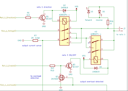

Step 4: Track Controller Hardware
The track controller takes care of switching track power on/off (enable) and reverse the polarity (direction). I decided to use AZ820 signal relays for this task as the currents are low and these relays are readily available.
Two relays are used, one to switch track power on/off and the other to reverse power, which reverses direction of the train engine.
Each relay is switched on/off by a transistor controlled by a GPIO pin of the RP2040. So direction and power on/off is controlled by software.
To ensure safety a power overload shutdown is implemented in hardware. A resistor (see R7 in attached picture) is used to sense the current supplied to the rails. Once an output overload is detected the J-Fet Q2 is activated and pulls the Base of transistor Q3 to ground, which disables current flow through relay K2. K2 will move to its idle position, which turns off track power.
The circuit to detect an overload condition is described in the following step.
Remark:
The output overload signal is forwarded to the RP2040, so we can decide in SW how to handle an overload condition.
Step 5: Track Overload Detection
Although we manage almost all functionality with software, a short circuit of the power lines needs to be detected and acted upon, even if the software is not running. I am using a circuit for overload detection, which was published by Felix Geering already in 2002. I modified the original schematic to add an overload reset circuit (R8,Q4), which can be controlled by the RP2040 and added a filter circuit, as I expect some digital noise from the RP2040 and I want to avoid this noise to activate the overload circuit.
Brief explanation of the functionality (please refer to the attached schematics).
D1 creates a reference voltage of approx. 0.6V, connected to Op-Amp U7B's inverting input. The reference voltage is compared to the voltage of the non-inverting input, which is the voltage across the output current sense resistor R7 (see Step4). The voltage across R7 is proportional to the track current. The value of R7 is set to 2 Ohm. If the current exceeds 300mA (six times the normal operating current), the voltage across R7 exceeds the reference voltage of 0.6V (overload condition). The output voltage of U7B swings positive and the output of U7A swings positive as well (=output overload detected signal).
U7A has positive feedback from its output to the non-inverting input (feedback resistor R12 and R13), which keeps the output positive, even if the cause for the overload condition is removed, so power stays off. The overload signal is forwarded to the RP2040 and the overload can be managed by the software.
An overload reset signal from RP2040's GPIO turns on Q4 and resets the output of U7A. This removes the overload condition, so power can be switched on again.
R13 and C11 create a low pass filter with a time constant of 10us to suppress digital noise. The filter is added to avoid that spikes from digital signals e.g. noise on the power lines to the Op-Amp would cause the overload detection to switch on or off the overload detected signal inadvertently.

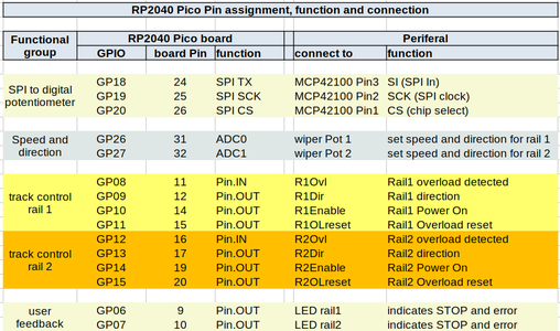

Step 6: Schematics and Board Layout
See attached pictures for Pin assignment of RP2040 Pico board mapped to function and connection to peripherals. The schematics is attached as pdf file.
The schematics is split into two sheets. Sheet one contains the schematics for the Pico, the two potentiometers, the user turns to set speed and direction, and the adjustable power supplies.
Sheet two contains the track control hardware and overload detection. The Raspberry Pi Pico's RP2040 CPU has enough processing power to manage multiple tracks. The attached schematics has two identical track control blocks to control two independent rails.

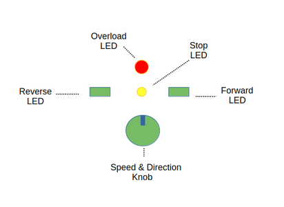

Step 7: User Interface and Functionality
User Interface:
Potentiometers are used to set speed and direction, with a STOP position in the middle. Speed is increased if you turn the knob from the STOP position to the end points. (Remark: "Knob" is used synonymous for the wiper position of the potentiometer).
From STOP turning the knob clockwise results in increased speed and forward direction, turning the knob counterclockwise from STOP results in increased speed and reverse direction.
Description of the functionality:
On Power-on the controller program intitializes the hardware and waits until both knobs are in the "STOP" position. The "Stop-LED" is blinking until the middle position is reached. If both potentiometers are at the STOP position the main control loop starts.
As long as the knob stays in the STOP position the Stop-LED is turned on and rail power is off.
If the knob is turned, the controller reads the position of the knob and calculates direction and power setting. With the result the direction is set, the adjustable power supply is set to the calculated voltage and power for the rail is turned on.
If an overload is detected, e.g. by shorting the power of the rails, the rail power is switched off. The "Overload-LED" is turned on.
The overload is detected by the controller. The controller requires the knob to be turned to the STOP posistion. This is indicated by blinking the Stop-LED.
Once the knob is in STOP position, the controller resets the overload condition (overload-LED turns off) and the user can turn the knob to turn on track power. If the overload cause is not removed, power is switch off again.
LED pattern [color]:
Stop-LED ON [yellow]: knob in stop position
Stop-LED BLINKING [yellow]: move the knob to stop position
Forward-LED[green] and Reverse-LED [green]: show the direction, LED brightness is proportional to rails voltage
Overload LED-ON [red]: overload detected

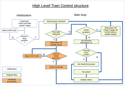

Step 8: Train Control Software
Attached picture shows the high level control structure. If multiple track controllers are used, they are processed in a serial manner. The second picture shows the control for two independent tracks.
The software is implemented using modular design. I use three blocks: (1) the configuration, (2) the drivers and the (3) main program.
(1) The file cfg.py contains all configurations and definitions. The definitions related to the hardware are e.g. the GPIO Pins, the SPI interface and the ADCs. If you want to change e.g. GPIO pins, do the chages in cfg.py. Additionally the user interface configurations are defined here, these are e.g. the dead band values left and right of the mid point of the potentiometers for the stop position. As well the status of the track controller is maintained in cfg.py. Additionally all constants needed for the calculations are defined in the configuration file. This speeds up program execution, as the calculations are done only once, when the python interpreter starts, though for this application speed is not critical at all. Finally you set the debug level in cfg.py (see Step "Testing").
(2) I use two drivers, one for the digital potentiometer (mcp42xxx.py) and one for the track control (track_controller.py). Both drivers are implemented using classes to support re-use and easy extension to multiple tracks.
(3) The main program is t_control.py. It contains all program logic, reading the user input (potentiometers), setting speed and direction and handles overload and exception conditions.
During testing I added a fourth "debug block", a module to output controller status to a terminal program via the USB connection.

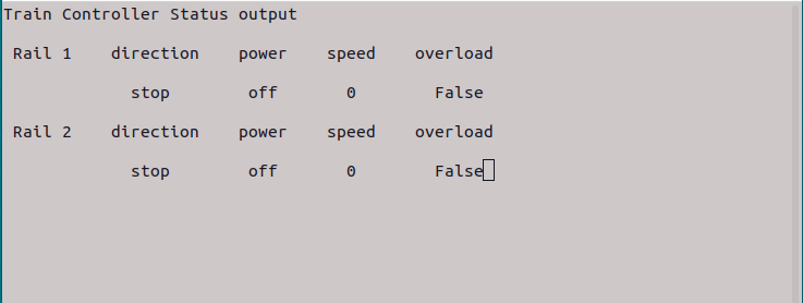

For testing it is always good to switch debug on. This is done by setting the variable debug in the file cfg.py. Take your favorite editor and set the debug level. I implemented three debug levels:
  • debug = 0 : no debug output
  • debug = 1 : track controller status is printed to a terminal over USB
  • debug = 2 : all (detailed) debug output is sent via USB to a terminal
I would recommend to start with debug level 1. This provides you with the status output of the two track controllers. You get direction, power on/off, speed (0...255), and overload condition printed to your terminal.
This way you can see what the controller does if you turn the knob. With a voltmeter, you can measure the output voltage.
To test the overload functionality connect two resistors in series to the output. E.g. one 68 Ohm and one 33 Ohm resistor . With maximum voltage (14V) you have ~140mA current. If you now short the the 68 Ohm resistors, current increases to ~400mA and you can test the overload functionality. Caution: the resistors should be capable of dissipating 2 Watt and they might get hot if connected for a longer period of time! Same for the LM317s, if they do not have a heat sink attached. So keep the overload test short.
As the control loop runs fast, you get a lot of debug output, if debug = 2, and the screen gets cluttered quickly. I have implemented a 500ms delay to the control loop, to slow it down. The delay is automatically activated if debug=2. If you like to change the delay, or even add a stop after each loop, e.g. by adding an `input("press enter to continue")` statement, go to the end of the control loop in t_control.py to do your changes.

When you connect to the rp2040 picoW board, after successfully downloading micropython should start and you get a message similar to below with the three chevrons >>> being the micropython REPL prompt:
MicroPython v1.19.1 on 2022-09-14; Raspberry Pi Pico W with RP2040
Type "help()" for more information.
