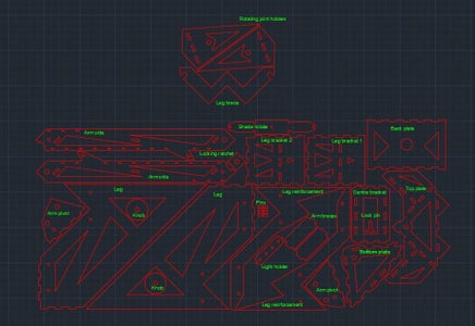

Step 2: Laser Cutting

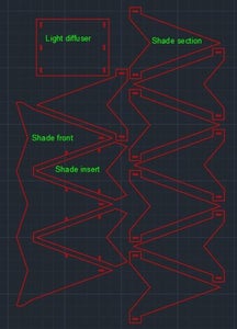

I was able to laser cut most of the 3mm plywood parts from a single 300mm x 600mm sheet, with ones that didn't fit on a small piece of offcut. Rearranging the parts in the laser cutter software may be necessary if your laser cutter is a different size. 60w power at 20mm/s worked fine for cutting the plywood but I would recommend carrying out tests on an offcut to find the optimum speed and power for your laser cutter. The polypropylene parts require a 200mm x 300mm area of material and the laser power can be a lot lower than what was used for cutting the plywood due to the low thickness.
I have assigned a name to each part in green text on the images (sorry the resolution is low but it should be readable), I will be referring to these names as well as using images to avoid confusion in later steps.

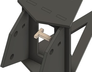

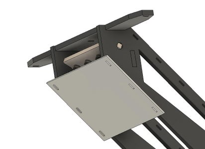

Step 5: Base Assembly
The base for the lamp is assembled from the plywood parts laser cut earlier. The parts should hold together on their own but wood glue can be applied to the joints for extra strength. The plywood I used actually turned out to be slightly thicker than 3mm so some light sanding was needed to get the interlocking tabs to fit.
The parts are assembled in same order as the images. If unsure about which parts are used, see step 2 to find the parts with each name.

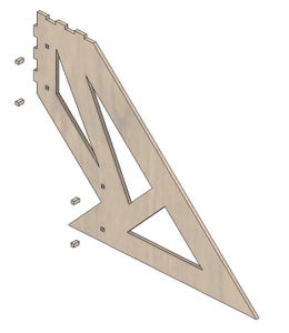

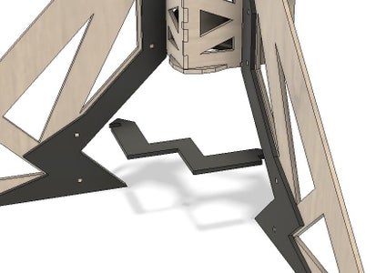

  1. Insert the laser cut "Pins" into each of the holes in a leg such that half sticks out of one side
  2. Press a "Leg reinforcement" onto these pins
  3. Press "Leg bracket 1" onto the tabs on the leg, making sure it is the same way round as in the image
  4. Repeat steps 1-3 for the opposite leg with "Leg bracket 2" on the end of the leg

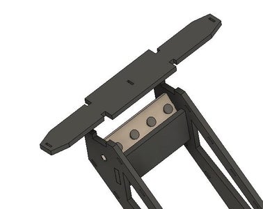

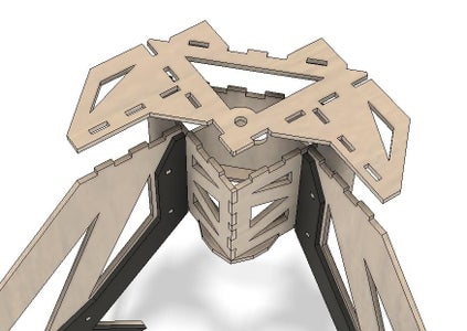

  5. Hold the leg brackets together and press "Bottom plate" onto the lower tabs
  6. Insert "Back plate" into the bottom plate
  7. Press "Top plate" onto the exposed tabs on top of the assembly so far
  8. Put "Leg brace" around the backs of the legs

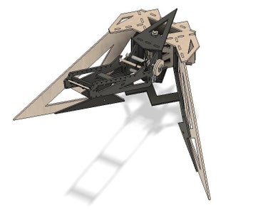

Step 7: Arm Assembly
With the threaded bars prepared, the arm is ready to be assembled. This is the part that holds the LED assembly, incorporating a height adjustment mechanism.
As with before, assembly is in image order and the name of each laser cut part can be found in step 2.
  1. Push "Rotating joint holder" parts onto top and bottom of "Centre bracket"
  2. The two "Arm pivots" fit into either side of the centre bracket
  3. Push "Lock pin" outwards through one of the arm pivots
  4. Insert the 65mm long M6 threaded bar through the bottom hole in the arm pivots. Place "Arm side" onto one side of the bar with the two "Arm braces" fitting into the gaps shown in the image. The "Light holder" assembly made earlier fits into a circular hole at the end of the arm side with the LEDs facing downwards.
  5. Place the second arm side onto the other side of the assembly and screw bolts on either side of the threaded bar. I would strongly recommend applying two bolts to either side and tightening them together, thereby preventing it coming undone.

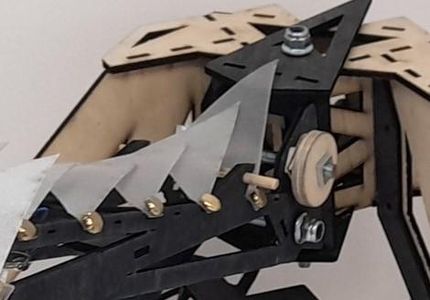

  6. Partially Insert the 70mm long threaded bar into the top holes of the arm pivots and put a 55mm long 4mm dowel through the round holes in the arm sides. On the inside of the arm pivots, screw on two bolts with a small gap in between; clamp a length of string between these bolts by tightening them together and the other side of the string is tied to the 4mm dowel. On the end of the other side of the threaded bar, screw on a bolt, followed by "Locking ratchet", the two "Knob" parts and finally a bolt to clamp these parts together (see images for positioning).
  7. Align the vertical holes at the back of the arm assembly with the hole in the base, then insert the 90mm threaded bar through to the other side. Screw double bolts onto either side to prevent coming undone.
  8. Route the USB wire from the LEDs down the arm, through the base and out of the round hole on the back plate.

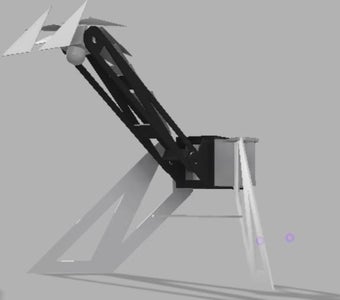

The mechanism made in part 6 acts as a pulley; when the knob is pulled outwards and turned, the string holding up the arm wraps around the threaded bar, lifting the arm to achieve the desired lighting angle. When the knob is pushed back in, the square "Locking ratchet" makes contact with the "Lock pin", holding the arm in the correct position and preventing it from falling down.
The horizontal rotation is a simple pivot since it doesn't have to act against the weight of the arm.

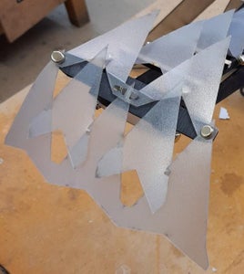

Step 8: Making the Shade
The shade is made from the polypropylene parts laser cut earlier. First, the "Shade holder" plywood part is fitted into the gaps at the end of the arm; this will be used to hold some of the polypropylene shade parts.
Here you should decide which side of the polypropylene you would like to see, i.e. if one side has more brown marks from laser cutting it would look better on the inner side of the shade where it is seen less.
I first mounted the "Light diffuser" (A polypropylene section in front of the LEDs to scatter the light and achieve more even coverage). It is held to the front of the arm by inserting split pins between gaps in the "Arm sides" and edges of the light diffuser, then separated the pins to lock it in place.
To assemble the front of the shade, the two "Shade inserts" attach to "Shade front" via interlocking gaps such that it looks like the fourth image. This assembly is held to the arm by inserting paper split pins through aligning gaps in the shade holder and shade front. Place two shade sections on top of these protruding pins, bend the pins outwards to lock the polypropylene parts in position and you have completed the front of the shade.
The remaining 6 "Shade sections" join to gaps down the top of the arm using split pins. By bending the rear shade sections upwards (final image), they won't interfere with the pulley mechanism and also give the lamp a cleaner look.

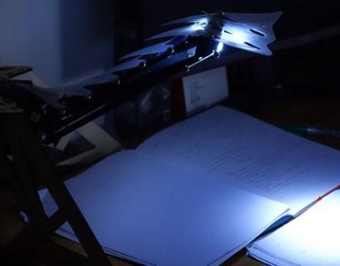

Step 9: Finished Lamp
You now have a useful USB powered lamp that fits to the corner of your desk without compromising the space, which can also serve as a modern decorative item that enhances the look and feel of your home.
