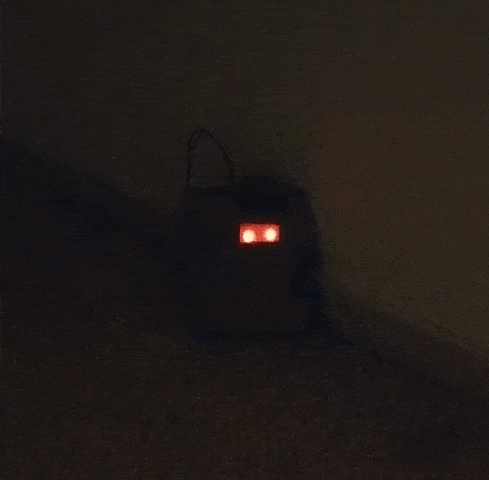

Step 3: About the Skulls
The talking skulls I use in this Instructable come from a company named Gemmy Industries (http://www.gemmy.com/), which specializes in holiday decorations. The look of the skulls varies from year to year, but they have the same insides.
There’s a small hobby motor connected to a string. When the motor is turned on, it winds up the string and pulls a lever, opening the mouth. When the motor is turned off, a spring pulls the mouth shut and unwinds the string from the motor.
As a side note, I have to say that I’m impressed with this design. Some unknown engineer figured out how to make a good talking skull inexpensively. If you take good care of them, they actually last quite a long time. On the other hand, if yours gets broken during a Halloween party, a new one is cheap.
Also, a key point of this build is that none of the custom electronics are housed in the skull. I add a mono phone jack to the back, and plug in a cable that connects to the mouth and LED eyes. This lets me put the microcontroller, MP3 board and speaker where ever I want. It also means that once you modify the skull and close it up, you never have to open it up again.
