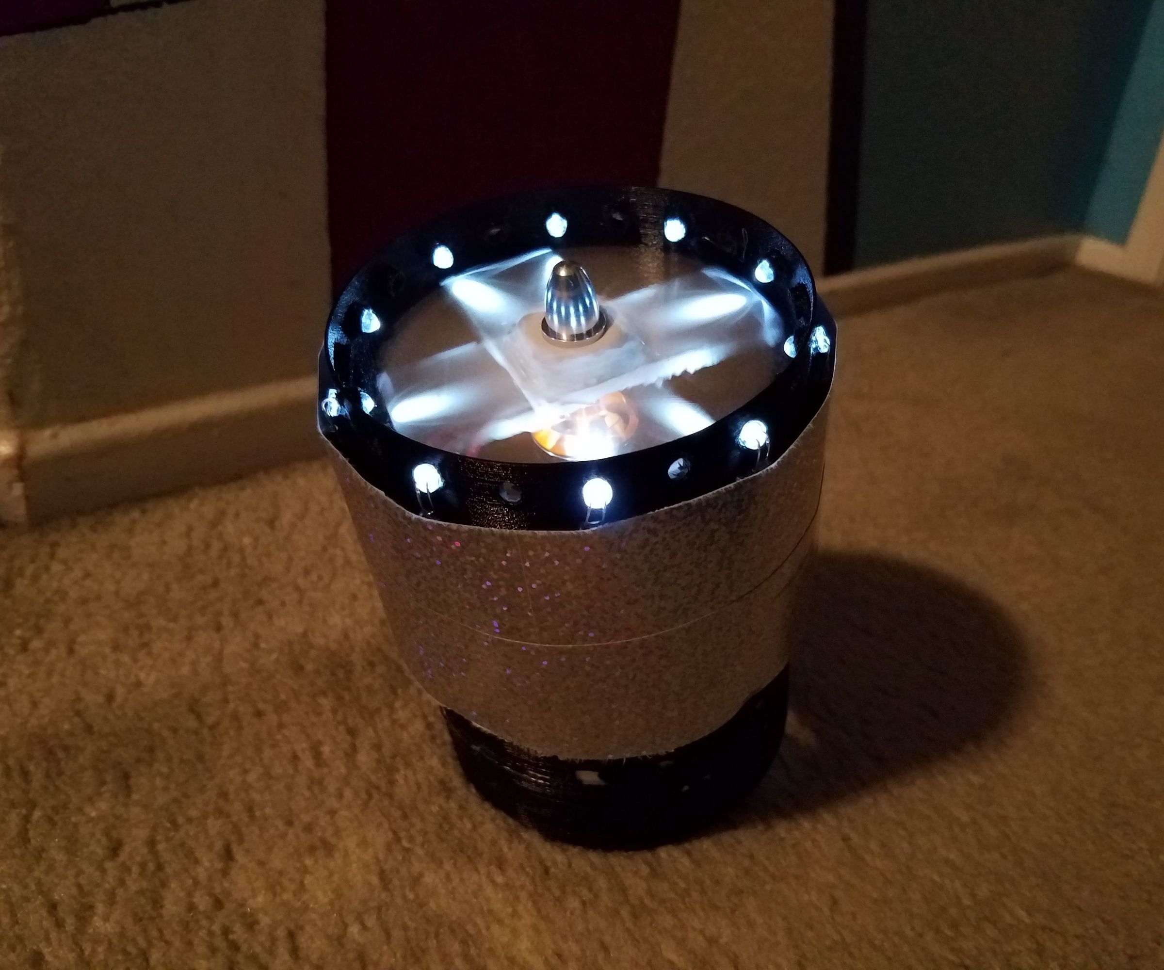

I used a gimbal in the form of a ball and socket joint in order to vector the thrust of the motors for control. The gimbal is actuated via two servos for pitch and roll control. Spinning control or yaw control is done by changing the velocity of the propellers, a principle motivated by the conservation of angular momentum. I made a video explaining this concept here: Angular Momentum Lesson by me
The specific control scheme that this particular bicopter uses is Proportional-Integral (PI) control. I used a kk2 board to modify the P and I gains until stability was reached.
Step 4: Test Your Bicopter!
Often times, my bicopters don't work, especially in the beginning as seen here, however, this seems to be a part of the process of learning and making your bicopter so that it can fly like this and beyond! I recommend wearing your safety goggles when testing your bicopter just in case this happens! I also recommend testing your bicopter in an area clear of people and pets.
