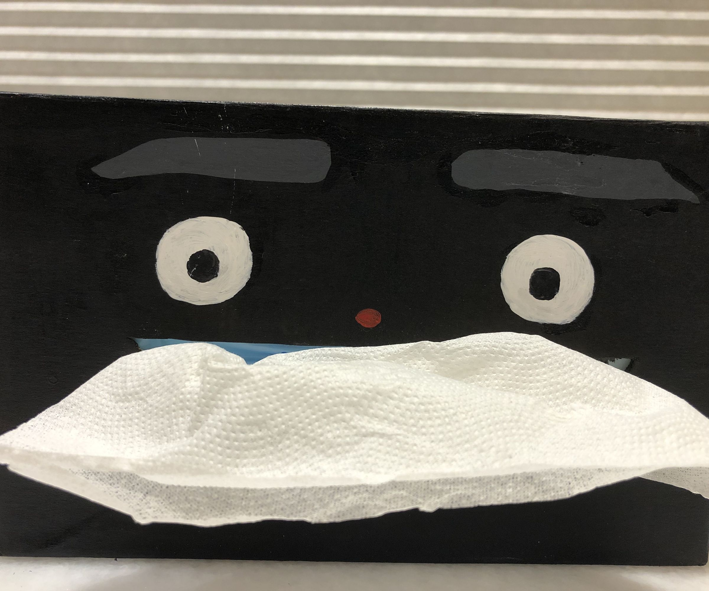

Step 4: Making the Container for Your Lamp
  1. Cut the layout of the box like the picture below: Cut the hole for your USB cable, a hole for your LCD jumper wires to come out, three holes for your Potentiometer on the left corner or wherever you put the Potentiometer.
  2. Color the box with acrylic color, either like me or you can choose your own color!
  3. Cut the tracing paper as the size of the right furnace, which should be cut in the first step
  4. Cut a paperboard that fits inside of our box. The purpose of it is to hold the Arduino near the top of the box so the light can go through the tracing paper.
  5. DONE!
P.S. Remember to NOT seal the box first, for you need to put your Arduino board and breadboard inside the box and it is easier to cut the holes while the bottom of the box is still opened. Also, if you want your Arduino Board and breadboard to be removable, remember to buy things like hook and loop tape or removable mounting putty to open and close your box freely!
I wanted it to look like a little stove, for the Potentiometers looks like the handle of the stove. Hope you like it too!
