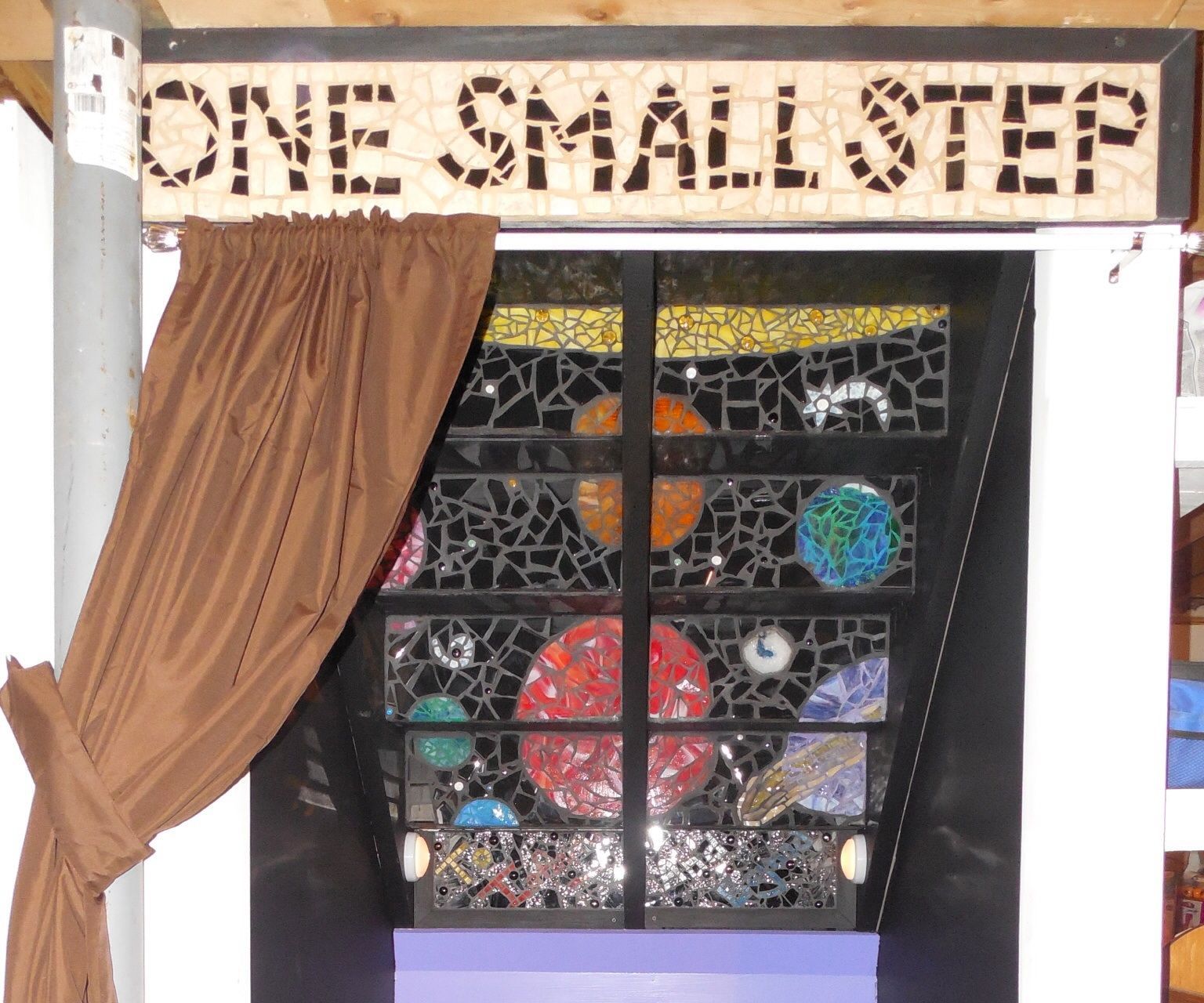

Step 1: Plan Your Art!
I live on the coast, so I knew right away that I wanted to do an ocean scene. I took a black Sharpie and sketched waves on our particle board basement stairs. Don't worry about small details, and don't worry about messing up with the marker; it all gets covered anyway. Think large basic shapes and also take into consideration ideas that can be expanded over an entire staircase. Examples: waves, a river, a waterall, a tree, space (four years after I did these stairs, I mosaiced the back of them in a space theme...check out my instructable for the mosaic space book nook). You could even just do basic squares or choose your favorite colors to intermix if you prefer no theme. The beauty of mosaics is that there are a multitude of options!

Step 3: Start Smashing and Buttering!
Yes, I have the same picture up again for this step, but it is because I want you to see the 3rd step (the one with the blue).
So you have your materials, and you have an idea of your planned art. Do you like puzzles? Well, you're going to have to if you mosaic because it is like putting together a puzzle!
1. First thing: Place tiles wrapped once in a newspaper and begin smashing with a hammer. Maybe start by smashing 5-6 tiles of the colors you need. NOTE: Wear Safety Glasses! Also Wear shoes, do this on the floor, and be sure to use a shop vac after to pick up dust and shards! I don't wear gloves because I like to be precise, but be smart and cautious...you are working with SHARP stuff!
2. Carefully pick up smashed fragments and put them in a container to carry to your stairs. I like an array or sizes! While carrying those over to your workspace, grab your tile cutters and file (for trimming and reshaping pieces for a good fit) and also grab your knife and Mastic!
3. Start mosaicing! Do this by buttering the back of a piece of tile with your knife, and stick it to the stairs. You are on your way!

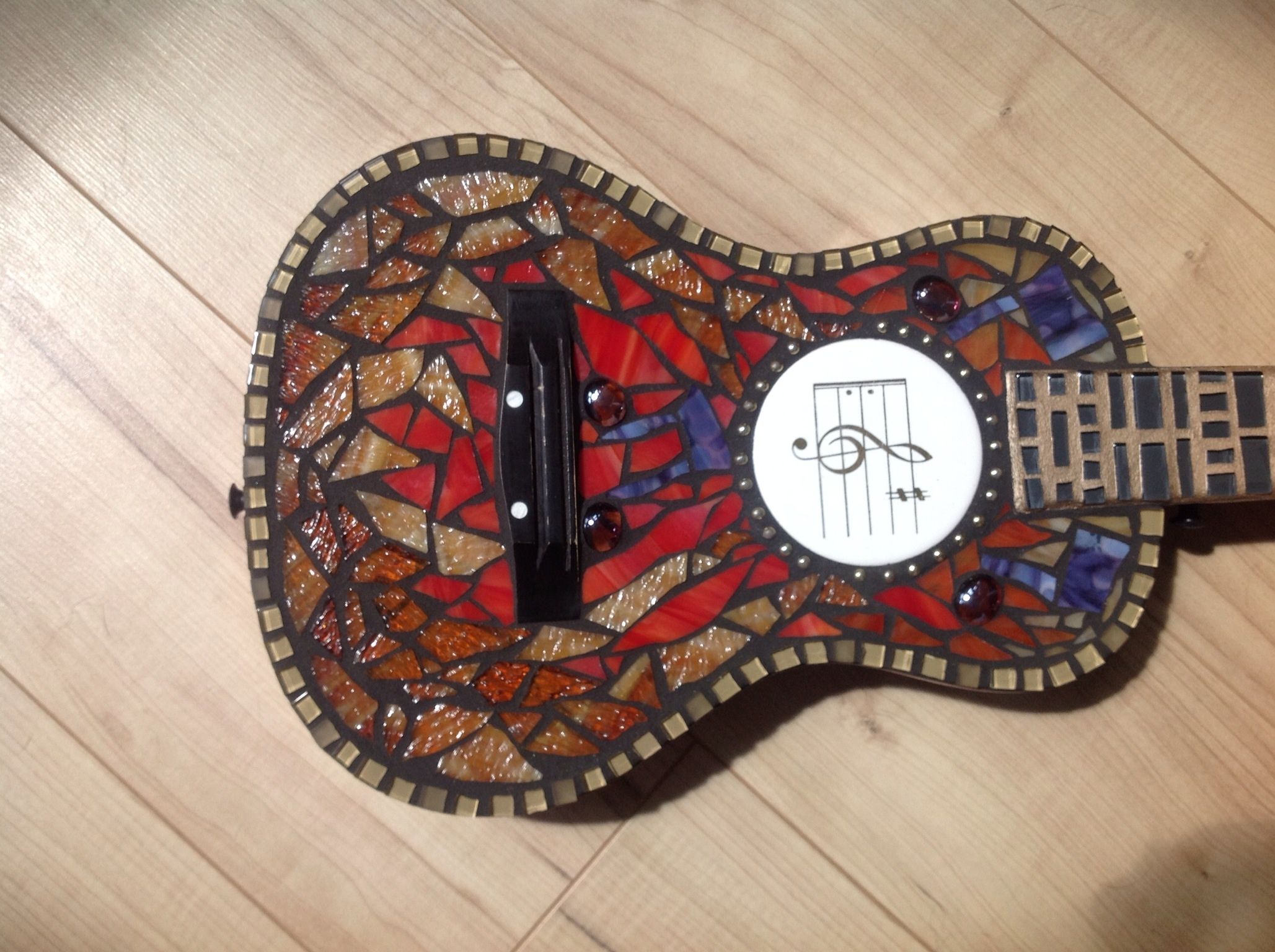

Step 7: Variations on Mosaicing!
Once you get the hang of mosaics (which you certainly will if your first or second project is an entire staircase), you can experiment with other bases. Some of my favorites bases are from upcycling such as guitars (see my first pic), old cupboard doors (see my 4th pic), picture frames from yardsales (see my 2nd and 6th pics), and jewelry boxes from thrift stores (see my 5th pic).
You essentially follow steps 1-6 for any of these projects, but with slight variations. For example, I did all of these with glass as opposed to tile, so I used Weldbond Glue as opposed to mastic. I also used a glass cutter rather than hammering the glass or using a tile cutter.
You can mosaic onto wood or glass. If mosaicing wood, lightly sand it first, and don't go overboard on your water in the grout or the wood can warp! If you mosaic onto glass, use the Weldbond glue, which will allow you to put your piece in a window after it is done for a stained glass effect (see my town in the 2nd and 6th picture...that is the same piece!) Just remember to let the glue dry completely before grouting. This may take a couple days if you used a lot of glue, or plan ahead to go light on the glue (I always make the mistake of using too much and having a long drying time! Putting it in front of a dehumidifier works to speed the process!)
You can also mosaic on a mirror! I like to use clear glass on a mirror for backgrounds for a really neat effect (see my cardinals in the 3rd picture). Like mosaicing on glass, allow extra drying time after glueing with Weldbond Glue.
