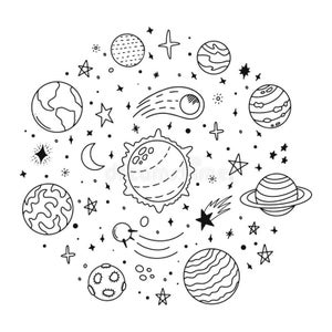

Step 6: Choose Any Design You Want on Lamp
Download provided SVG file for Same Image want.

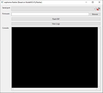

Step 11: Upload WLED Firmware in ESP8266
Follow steps from my Previous Project "Monitor ScreenBar LED Light"
