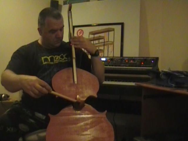

This is a simple project. It uses a PS/2 compatible Optical mouse and an Arduino to make a Midi controller. A 6 pin and a 4 pin header plus two 150 ohm resistors and a 5 pin Din socket complete the parts list. I use heat shrink tubing to protect the soldered joints. The software is available in source from http://moddersandrockers.com/mouseorgan I view this as just a component in a kit of musical building blocks that you can use to create a Mind Exploding array of instruments.
There are many ways you can use the mouse to control what note is playing or adjust one of the controls on the Midi device. In the video, I have taken a piece of 3/4 inch plastic pipe and cut a flat area that just exposes the inside of the pipe. This allows you to glue the mouse so that it 'sees' a piece of 3/4 inch wooden dowl when it is put through the pipe. When using an optical mouse you find that the depth of focus of the mouse camera is very small and you need to keep the surface that is moving in the camera's sweet spot. Get creative!
