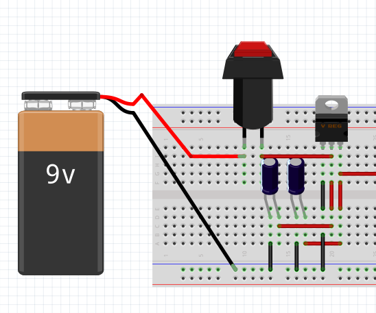

Other features are implemented by the following methods (See Breadboard/ PCB Picture):-
a) Mode Selection. The circuit uses a voltage divider with four "lower" arms (R3 to R6) each having a different resistance. By switching between each of these, and reading the output voltage (Arduino Analog Pin A3), the device switches between the four modes of operation.
a) Intervalometer. We use one potentiometer (R7) to set the interval between pulses and use a second potentiometer (R8) to decide how many pulses in total need to be transmitted.
b) Light Detection. One potentiometer (R7) is used to set a threshold level. If the intensity of light from a flash of lightning exceeds this threshold, a pulse is transmitted that activates the camera shutter release. Light intensity is measured (by Arduino Analog Pin A2) using a Light Dependent Resistor (R10) and a 4.7 K Ohm resistor (R9) that are positioned in the form of a voltage divider. The details on how this voltage divider works can be read here.
c) Motion Sensing. Motion sensing is achieved using a PIR (Passive Infra Red) sensor. These are inexpensive sensors that measure ambient heat levels and send out a HIGH signal on their output line if there is a variation in the ambient environmental temperature level. So when a animal (or any other warm body) walks past the camera trap, the PIR senses this movement and generates a HIGH on its output line. The micro-controller (Arduino Digital Pin D11) reads this HIGH signal and triggers a pulse. Power to the PIR is provided through Arduino Digital Pin D13.
d) Test Mode: The device can operate in "Test" or in "Pulse" regimes (Through switch connected to headers J25, J26, J27). While in "Test" regime, the micro-controller does not pulse the IR LED (that activates the camera) but instead it blinks a normal red LED. So by putting the remote to "Test" regime, you can make all the settings you need, and confirm by watching the red "Test" LED that the trigger will operate at the right moment. Now you can put the device back to "Pulse" regime and it will now send pulses through the IR LED that operates the camera.

Download the circuit diagram (ML_L3_Remote_With_PCB.pdf) and prepare the PCB, and solder all the components in place. If you don't know how to etch a PCB, there are plenty of instructables that will tell you how. Otherwise, you can read my method here.
You can also download the Fritzing sketches I used to make this circuit. I have uploaded two versions:-
(a) Breadboard.fzz (shows all the components on the breadboard)
(b) PCB.fzz (shows the final PCB that needs to be etched, but without any of the "external" components, just their header pins)
The PCB is etched only on one side. I have tried to minimise the number of jumper wires that are needed to make all the connections on the PCB and have used 1/2/3 pin female headers wherever a jumper wire needs to be soldered in place. You can see descriptions of the headers on the PCB picture I have uploaded. These are listed below...
